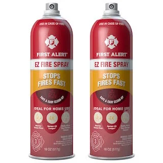

Putting out a fire definitely isn't a "point and shoot and it goes out" operation. You do have to have some knowledge of what you're doing. I've watched people with "regular" extinguishers be totally ineffective because they just wave it back and forth at the fire. A disadvantage of the Element is the limited amount of time you have and that once you strike it you have to be effective with it. The "regular" extinguisher you can "squirt," step back and assess, and "squirt" again - repeat as necessary. I see people with the little aerosol extinguishers and you're going to have the same issue with them as the Element as far as capacity - but you don't have to use it all at once either.
