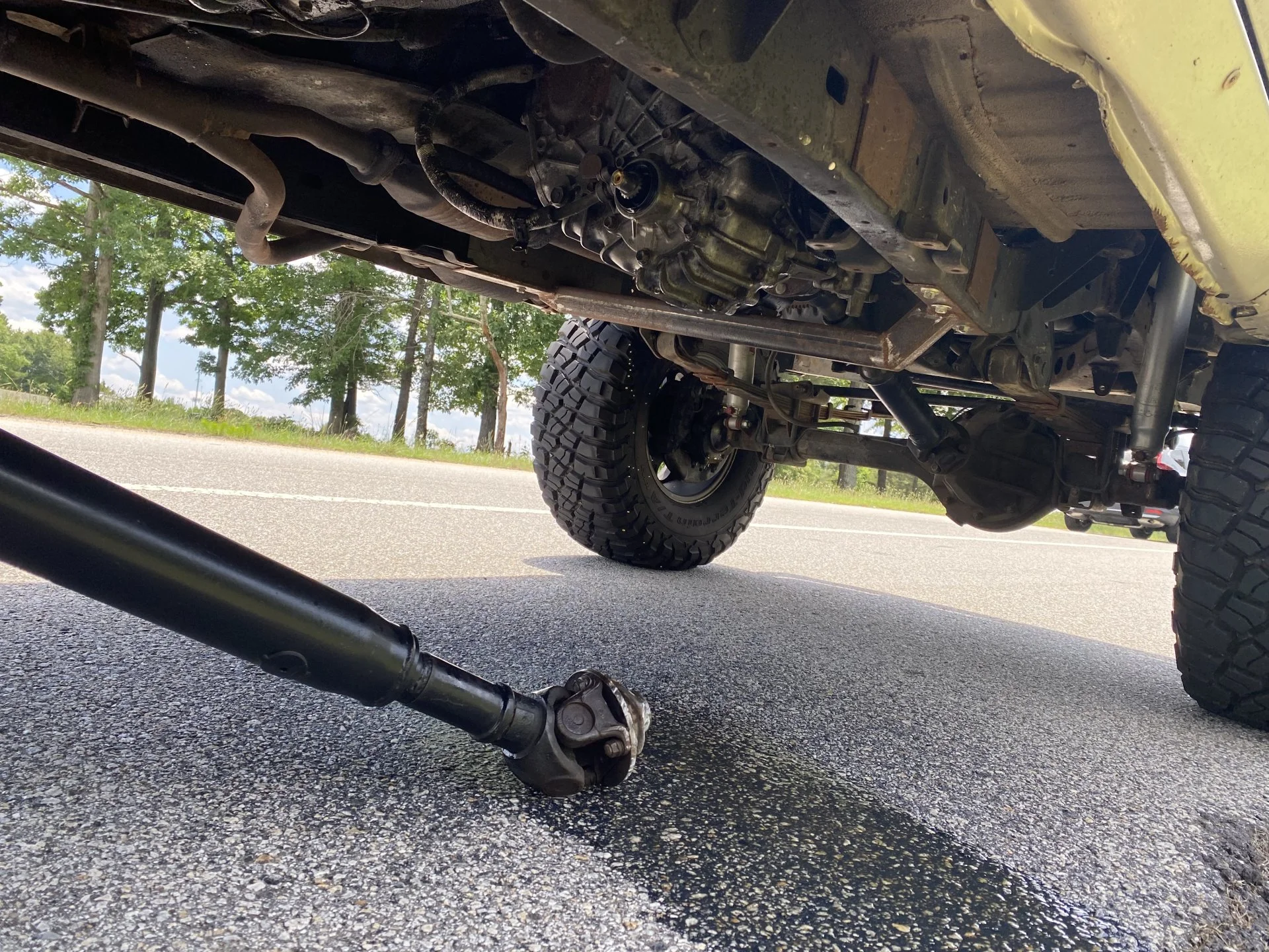

Holy s***. Where did that happen?
On the exit ramp off 85 in Spartanburg. Luckily I was close to home. Called my brother in-law. He grabbed my trailer and came to the rescue. 62 is back at my shop, the Crasin is in the shop, and the new tire/wheel combo is on. It’s been quite a day.
Luckily it looks like the only thing damaged was the t-case output flange. I’ll grab a spare from trollhole’s tomorrow and slap it all back together. Hopefully the driveshaft is still ok.
Flange nut came loose????
Yep. I pulled it apart today and bolted a new used flange on. (Perks of working at trollhole’s). There was a mark from the nut being staked, so not really sure what caused it. Filled with gear oil and took it for a test drive. Bad vibration. I’m assuming the driveshaft is bent.
I guess count your blessings it didn't come up through the floor or send you pole vaulting.
