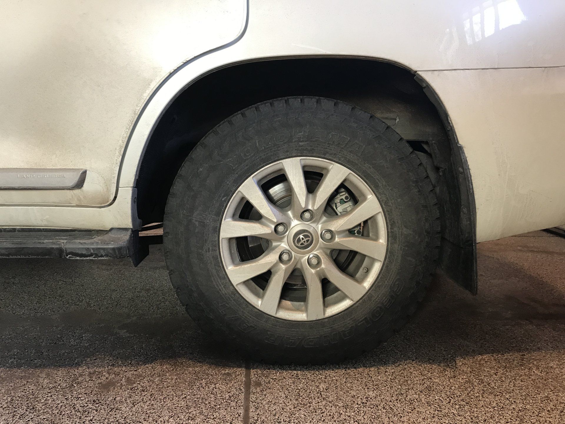

Yokohoma Geolander G015 in stock size. I did a trip to Moab from SoCal over Christmas break combined with a decent amount of trails at MOAB.
Hit snow, ice, mud the tire was flawless and super quiet on the freeway as well. HIGHLY RECOMMEND this tire.
Agreed - just upgraded from stock tires to these in 275/70r18 and we have them on our 100 series as well. Great tires - not much different feel/noise from stock on the road but fantastic in snow and mild trails.
