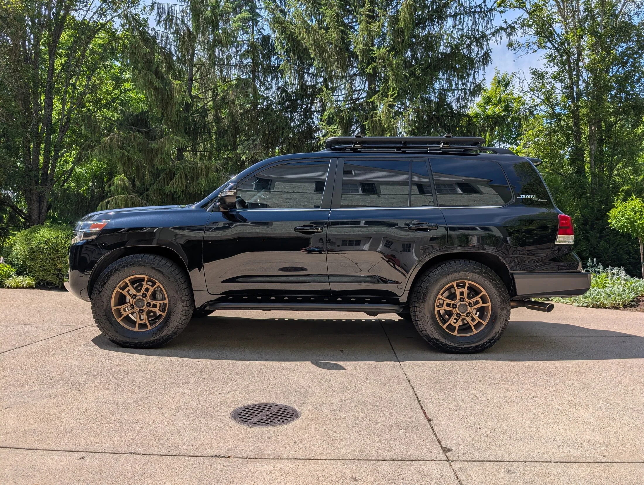

RWs were an OEM fit for the 200 series. They were specified with K02 LT285/70R17 tires.

I just made the switch to 285/70/18 Falken Wildpeak A/T4W. 2021 with OEM 18 inch wheel. This is really pushing the limits of the stock suspension and not for the faint of heart. I have already cut some and will need to cut more at which point I think it will be fine even off road aside from a kdss rub I can live with. I am stock other than the OEM coil spacer in front. Running 1.25 spidertax on the wheels.
I have some added weight with sliders skids winch and roof rack. I think this tire would be easier to run without that added weight.
