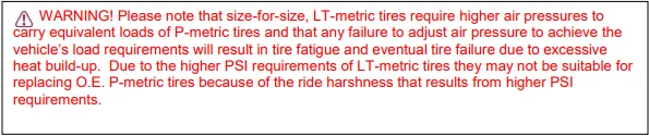

Direct from the Application of Load Inflation Tables document:
This supports @bloc 's comments. It's about managing and staying within the heat threshold of the LT tire carcass for load capacities up to its full performance envelop, which includes max speed. More material that composes an LT tire generates more heat. It's a selfish parameter of the LT tire architecture with respect to only load capacities. It does not address any tuning for a vehicle.
On that last point of tuning to a vehicle and the balance of PSI for load against that tuning...
It also goes to state that the higher PSI requirements may not be suitable. Which has been my beef with RCTIP. To @Heckraiser 's point, there needs to be some pragmatic balance and common sense applied.

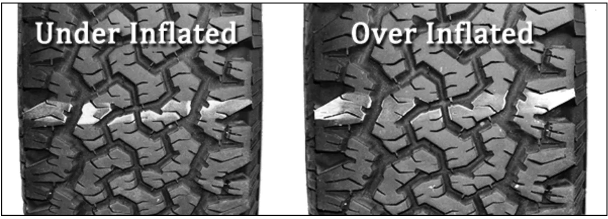

I'd wager this has to do with how much of the tread pattern is engaged on the road at differing pressures. Specifically whether the more aggressive shoulder tread blocks are touching the road. This classically affects traction, tire wear, and interestingly to your point, noise.
Would be worthwhile to do a chalk test:
