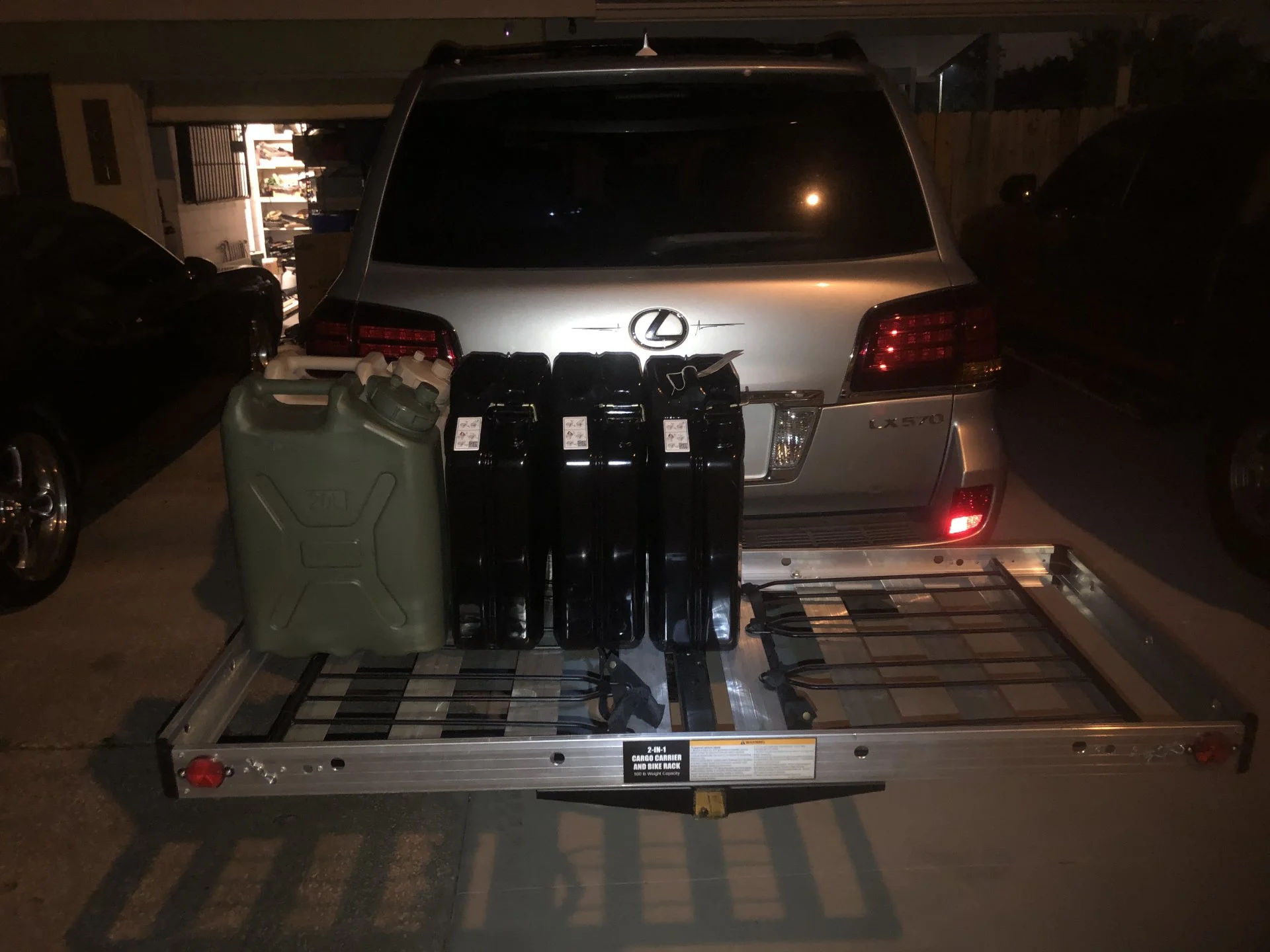

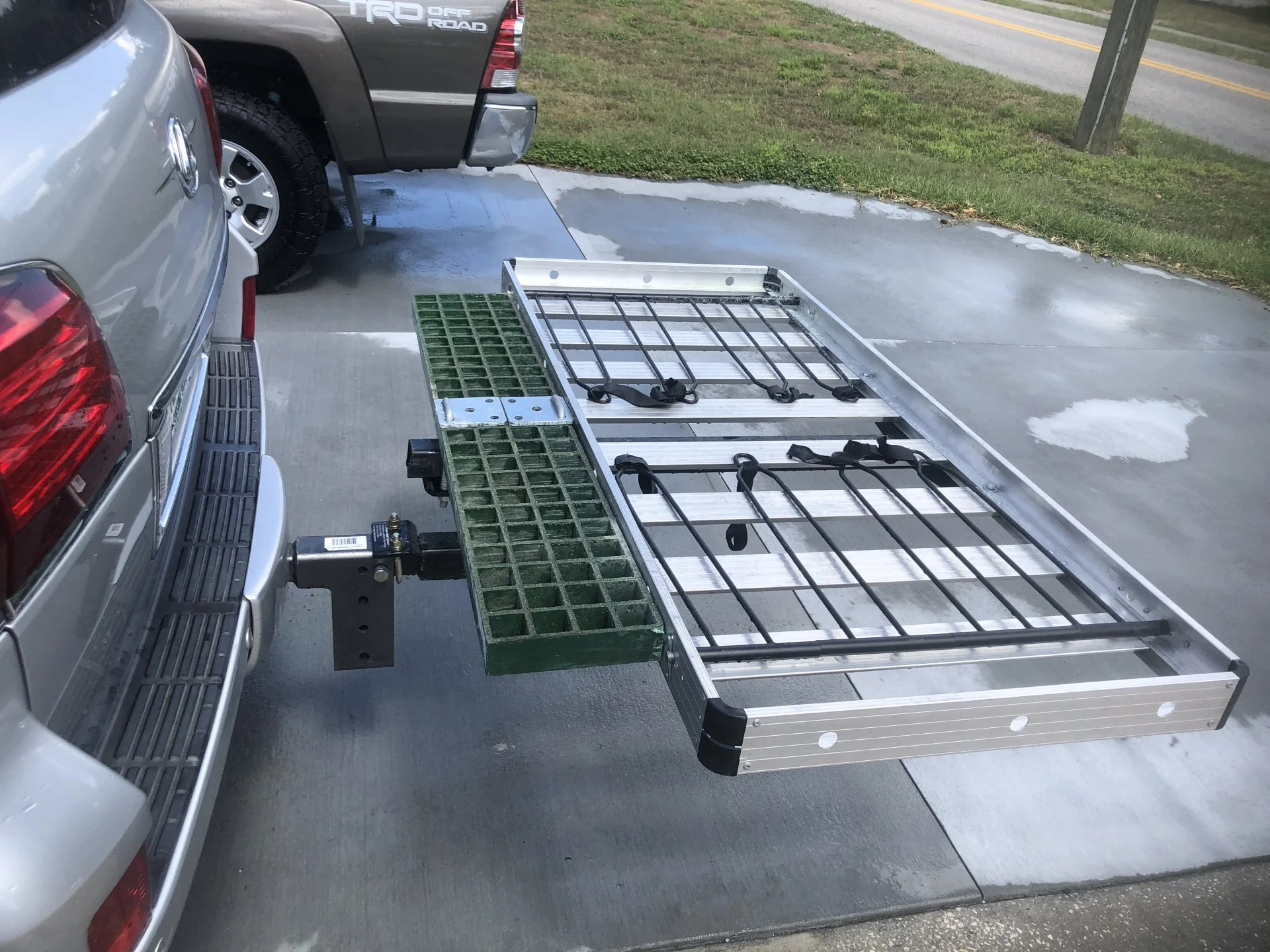

I’m tossing around the idea of getting a Wilco hitchgate so I can pull this apparatus up closer to the truck...but I don’t know. At this distance from the car I can put the tailgate down and dangle my feet in between the tailgate and the basket (I don’t leave the waffleboard on there, was just fitting it for road trips)...or recline on the tailgate and put my feet up in the basket. As goofy as it looks on the back of the truck, it’s super useful. Bikes, lawn equipment, ad hoc table, nasty stuff I don’t want in the car, etc.

That's definitely a good method (decent space left over too); the one caveat I'd have is I personally would only do that for extended trips. Part of the allure of an LRA for me is that it functions well in normal life as well allowing you to go longer between fill ups when you're at home too. For a once in a blue moon situation the jerry cans on the cargo carrier seems like a pretty reasonable solution
It's way cheaper, yes. LRA makes a solid product and it is also a great value proposition. I personally did it because I apparently have more time than money, I was interested in proving the concept, and I liked the idea of an OEM style solution to hopefully reduce/eliminate potential future emissions/vapor/heat issues.
