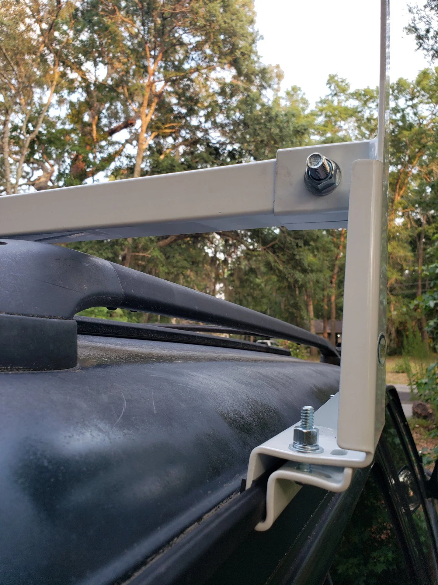

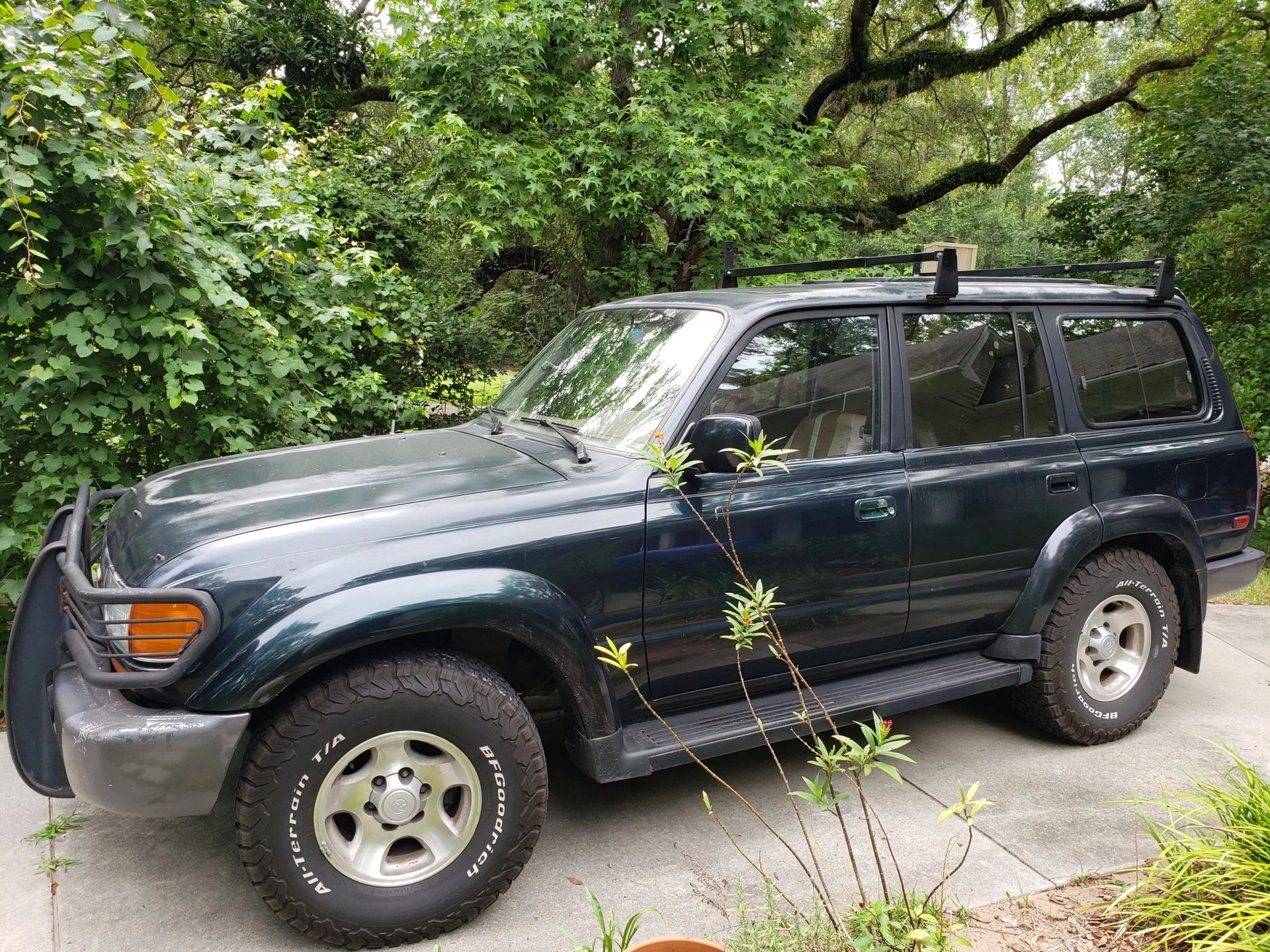

Pulled the trigger on the Lowes Werner Ladder rack. It will need a few weatherization mods but feels stout. I can't compare it to the "fancy" rigs as I have no experience with them but this seems trustworthy. I would not hesitate to put a RTR on there. Minor (1/8") lateral movement on the bar with my body weight and I would image that once they are fastened together somehow, see my ATV aluminium ramp idea soon, it will be rock solid. Replace hardware with some stainless, silicone the weak links and couple cans of truck bed liner and it will be good to go.
I will say that bolts vs welds are inferior but so is $1k vs $105.

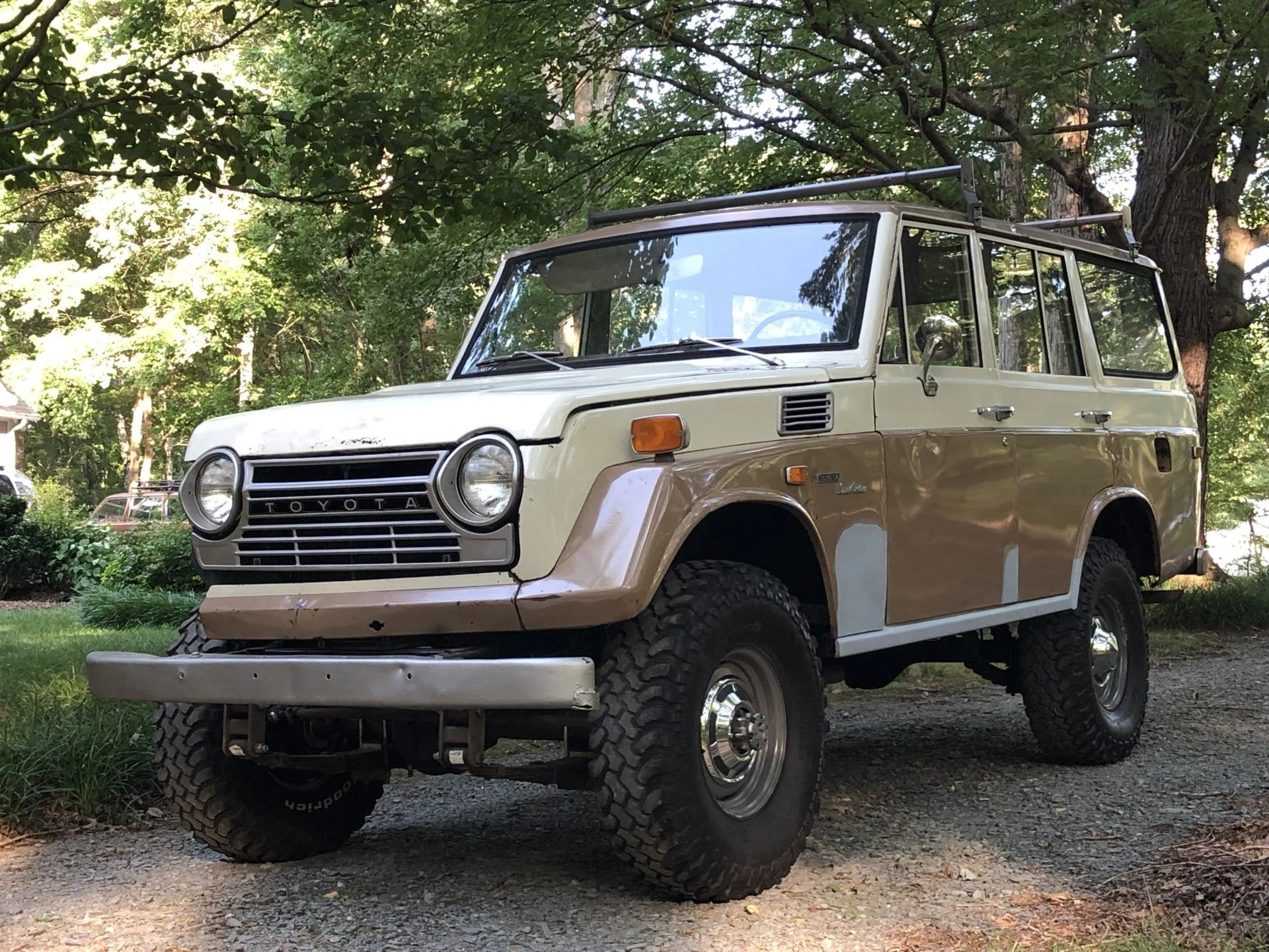

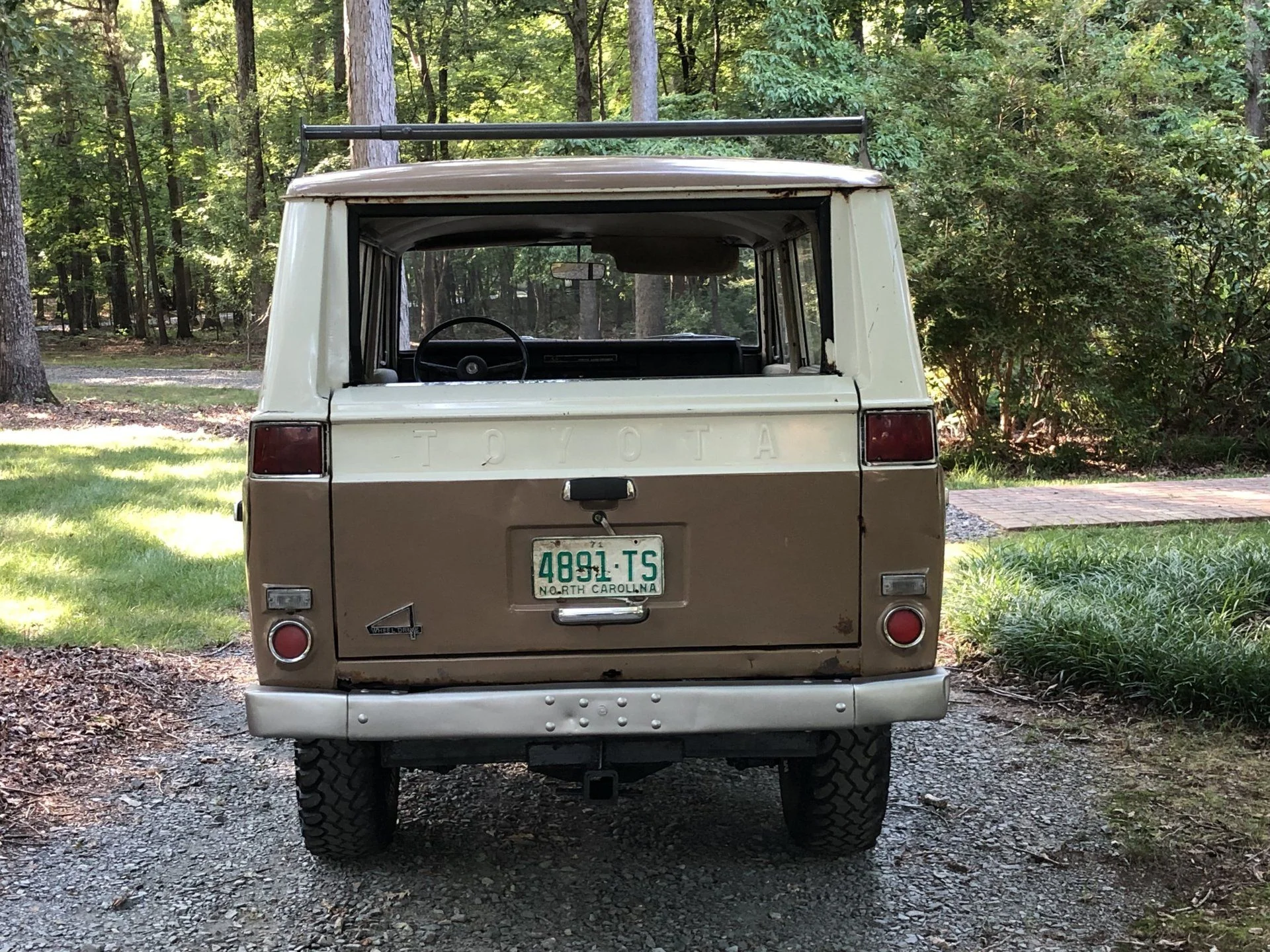

I just picked up a set of rusty old ladder rack load bars from another MUD member for free to use on my 55. I didn't like the super tall "ears" on the uprights so I cut them off with an angle grinder. The ones I got are stout as hell. I sanded, primed and painted them. The look seems to go well with my old school truck. Not sure how I feel about these on an 80 series, but if you like the look you will not be disappointed with the sturdiness.
The load bars on the 55 above are made by Vanguard Mfg. They still offer a very similar set for $241 / pair.
I like these compared to the OP's Lowes / Werner version because these are tubular, welded and the mounting feet do not protrude out away from the body of the truck. My trucks see some trail use, so eliminating overhangs that can catch tree limbs and hit trees on off-camber climbs is important. I've seen roof racks completely ripped off the tops of trucks by trees out on the trail and it is not a pretty sight.

-Ground off one side of the ladder fins to accommodate a future rtt. (Free)
- All stainless hardware upfit ($25)
- Rustoleum Truck Bed Rattle 3 cans ($20)
- Tightened the live daylights out of it...(also free)
- Ladder rack ($105)
Total: $150
56" width. RTT is 48", that leaves 12-16" to do a passenger side platform to hold gear.
Not sure it Mojave ready nor do plan on it. Camping trips to the Mountains, for sure.
