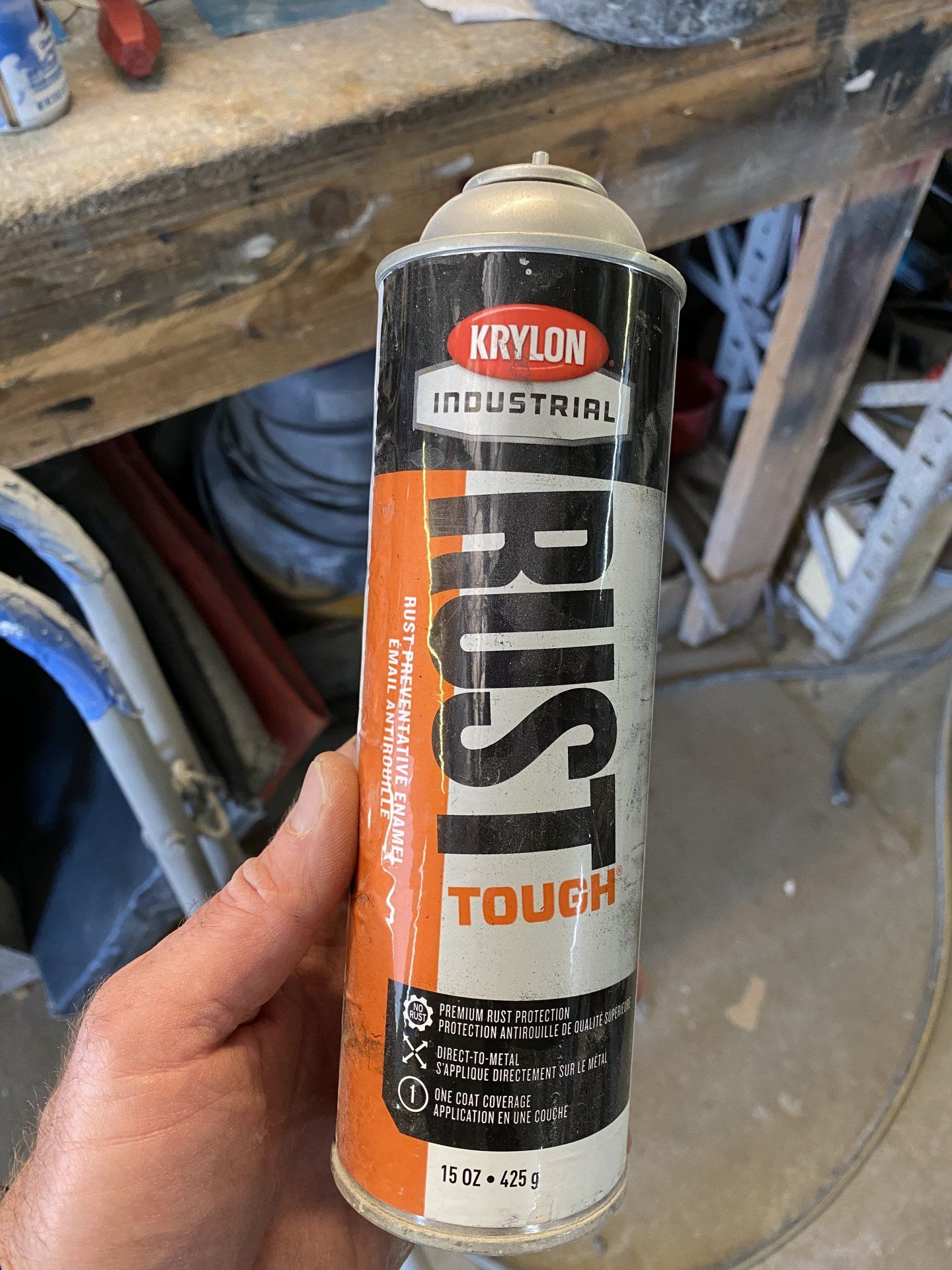

Anyone ever used this paint for the frame etc? It was recommended to me by my body/paint guy
As I look at the product, it shows a direct to metal application, and says it provides rust protection. I'm not sure I'd put that directly on active rust spots. I'd get a true encapsulator, and as I said above, I'd convert the rust as much as possible if it won't come off with a metal bristled wheel.
