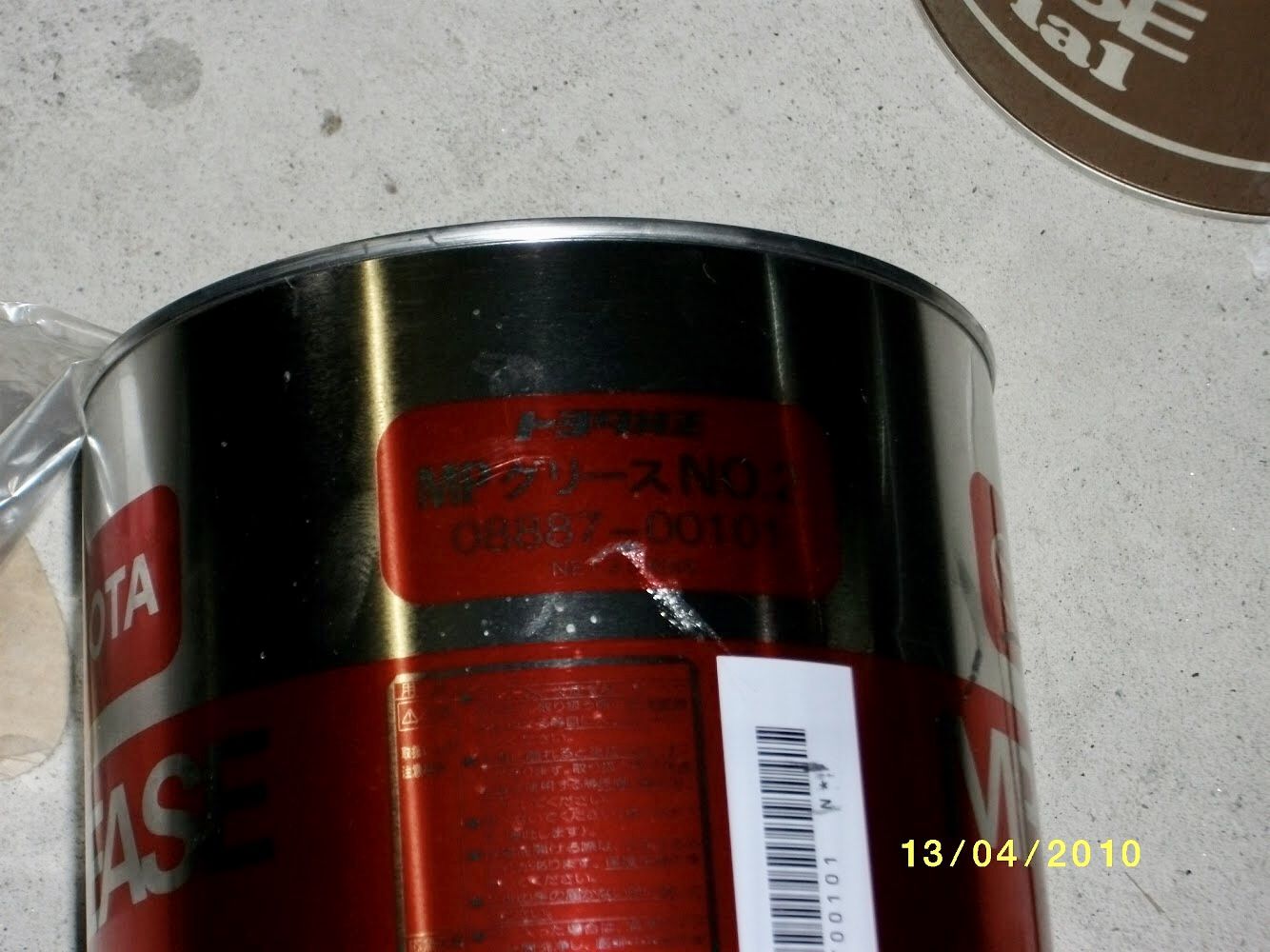

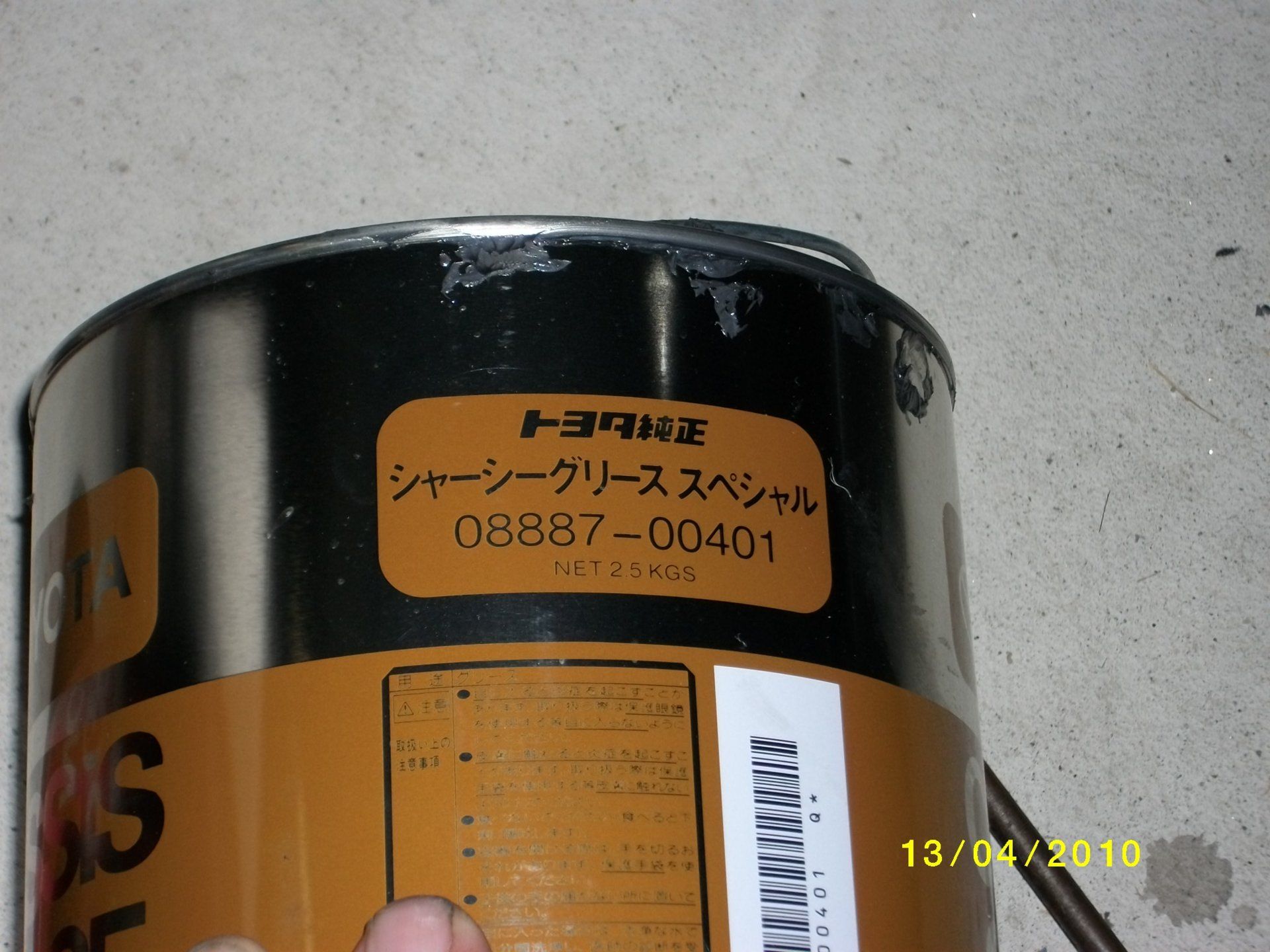

Dumb question but what is the part # on that chassis grease / where do you get it? That tin is awesome
I got the grease from Beno. I don't have the can anymore to snag the part number from it.
Awesome, thanks for that and the helpful videos here!

Saw this requested earlier Ryan. Hope that helps.
* the second picture part number is 08887-00101
