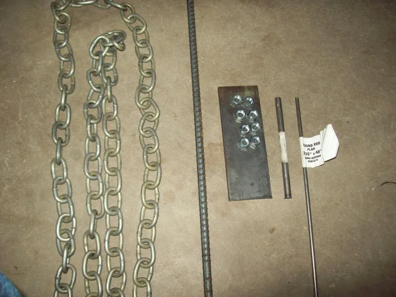

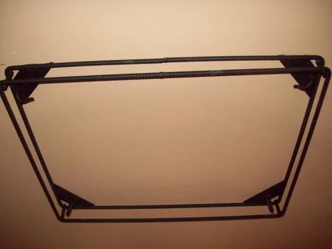

So far, other than some 2x6 blocking and screws, this is all the marerial needed: #3 rebar, 3/16 round stock, 5/16 round stock, 2x3/16 flat, 3/16 chain (cooked in muratic acid), nuts and washers.

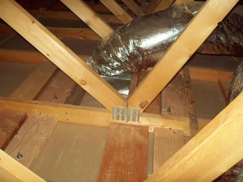

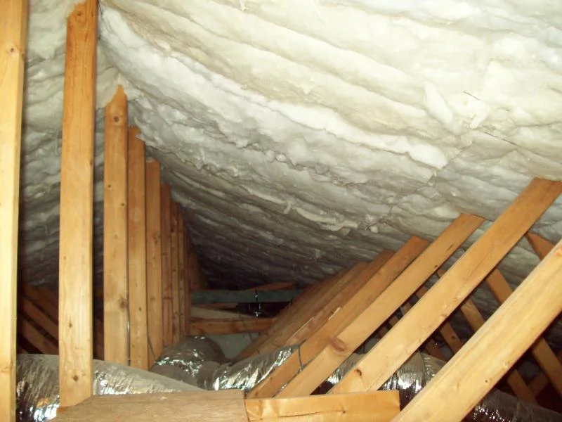

Contorted body attic blocking..

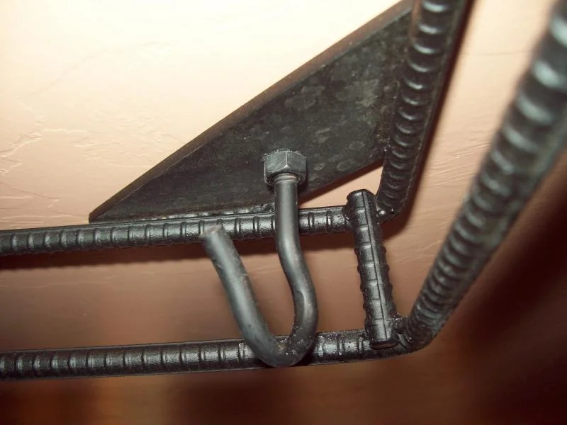

Ceiling mount, with adjustable threaded hooks to take up chain slack..
With luck, I should have finished pics manana.
LOL, I was thinking the same thing.
You have done an extremely good job of removing all of the insulation in your attic in preperation for this project.
LOL
:lol:, one of these, evertime I try to stand up, I come out looking like Santa Clause..

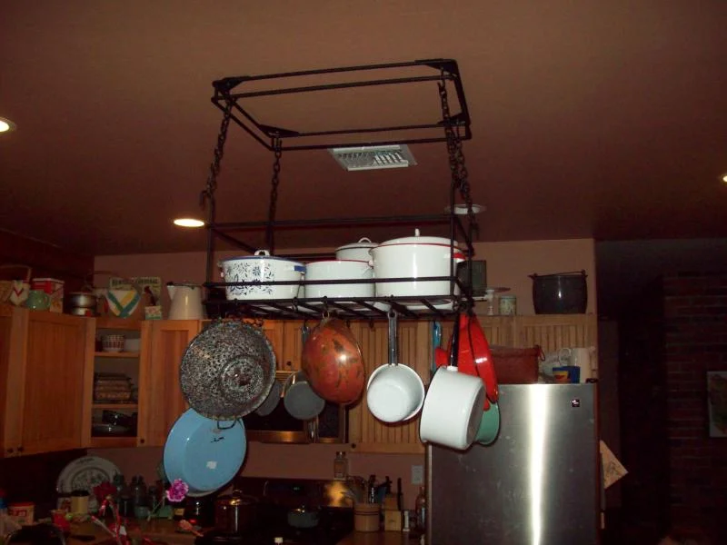

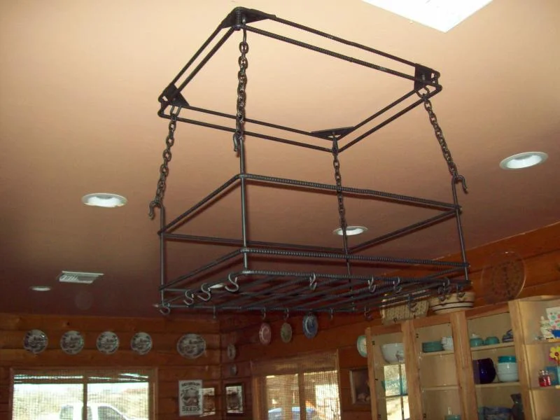

Anyrate, it is done just in time for Valentine's day (if she didn't want something so complicated, I could have finished it a long time ago)..;)
Big hug, and lots spare room in the cubboards now..This was a winner..

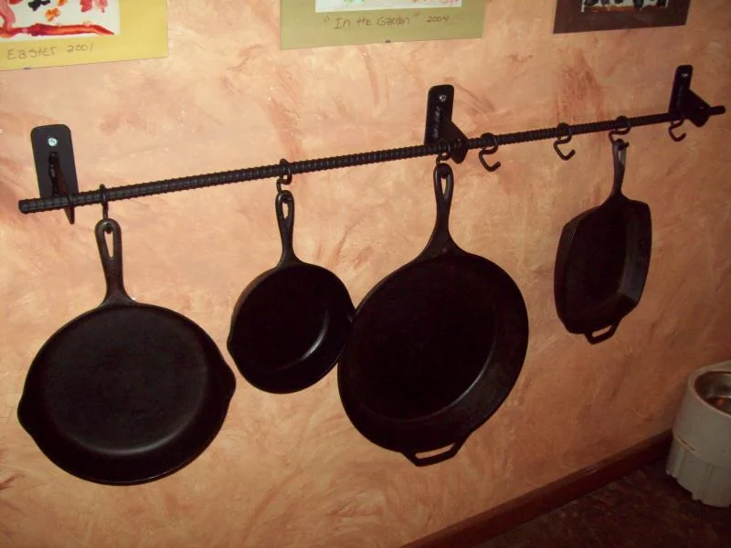

I have the wall rack for all my cast iron stuff..:cool:
Man that looks awsome!:eek:
.........the only missing thing is a light bar with some nice Hellas on there.:hhmm:
Thanks everyone...
Damn nice job....
all that enamelware just for show?
Pretty much, still used for special occations, but from what the boss says, it is hard to come by and should be treated as such.:meh:
