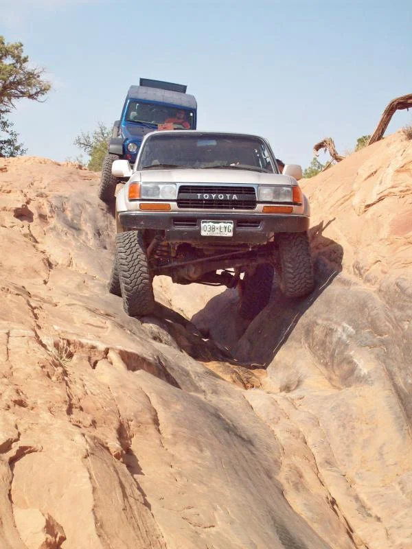

Did I miss something, or has anyone stated how this is possible?
(I'm not buying the dingo excretion hypothesis)
Note front still has heaps of flex in it even with std arms.
The truck is just balanced in such a way that it forces the front to flex more than typical. (I also like that bumper.)

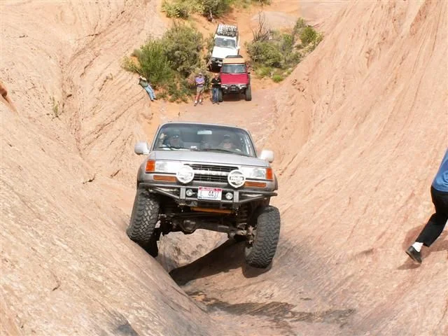

This isn't quite as much, but close to it.

Another example:
attachment.php

:hhmm: Hhhmmm... yeah... I don't know E. Eyeballing where the tires are lining up with the bodies in those photos, it doesn't seem to be a very close comparison to me. Angle of the camera, or trick of the light? Maybe. But I'd say there is something else going on.
...I wonder if he would trade a not-so-gently-used ARB bumper and a pair of straight factory running boards for that bumper.
^^agree, not close
I would this is close but it has custom this and custom that for a front end
^^agree, not close
Meh, pretty close.

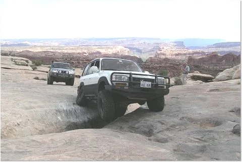

How about this? AFAIK stock but no front sway bar.
attachment.php
https://forum.ih8mud.com/80-series-tech/534611-flex-withou-front-sway-moab.html
