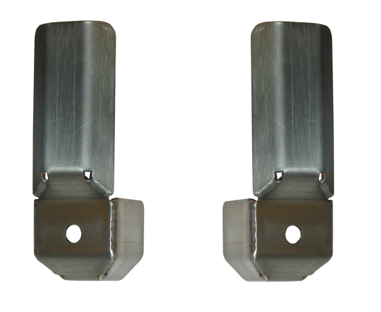

I have these on my Icon Piggy Backs
4Runner Stainless Steel Lower Shock Shin Guard - ICON Vehicle Dynamics
The icon shin guards will fit a Radflo shock, I don't know about a king. If someone could give me the dimensions for the King shock where it mounts to the axle I can verify if they will work.

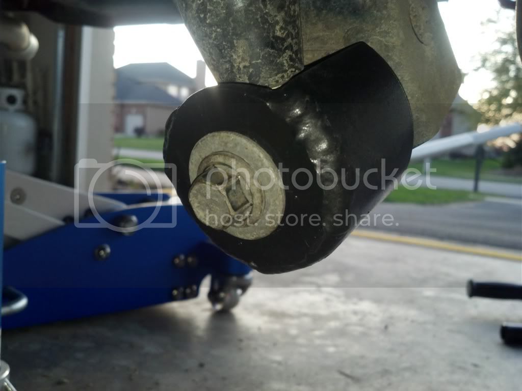

Can you take a few pictures? last time I was under mine my shock mounts were pretty torn up.
This isn't my picture, this is of them on a FJC, but mine essentially look the same. I may just weld on some "shin guards" to block stones from pitting my radflos.

LT - which ones? the FJ or 4runner? Or are they the same? Is there any mods needed to install them on the 100 running Radflo's??
FJ Cruiser and 4 Runner use the exact same shocks, coilovers and suspension links so yes the shin guard will work. I also have a few in stock as well Icon Vehicle Dynamics

So, I thought I would circle back on this. I ordered up a set and went to install them yesterday. As LT notes they will fit the Radflo shock and protect all but the upper 2" or so of the shaft.
However, if you are running the Radflo 2.5 remote Res piggy back in the rear they will NOT work on our rigs. The way you need to position the remote to clear the sway bar and lower control arm when flexed out will cause the Icon shin guard to jam into the bottom of the remote and piggy back bracket. I bolted it up and played around trying to make it work. But there is no way I would chance running these. Something is going to get jacked up!
Now, if you are running a non-remote Radflo or mount you remote in a different location other than piggy back you should have no issues.
These are built up pretty nice and I dont see bending them being too much of an issue. If you are hitting rocks in this area, chances are you will be bending the shocks, lower control arm Sway bar brackets as well. So, you will be screwed no matter what.
