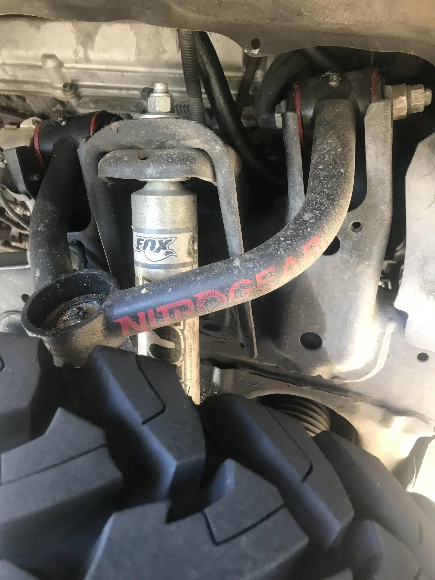

Howdy, I went Nitro upper control arms, an Fox my buddy uses Controlled chaos, with King shocks.. if I was going to do it again, I’d go Controlled chaos an King

Ball joint Nitro UCA vrs uni ball total chaos .. uni ball sounds like the way..

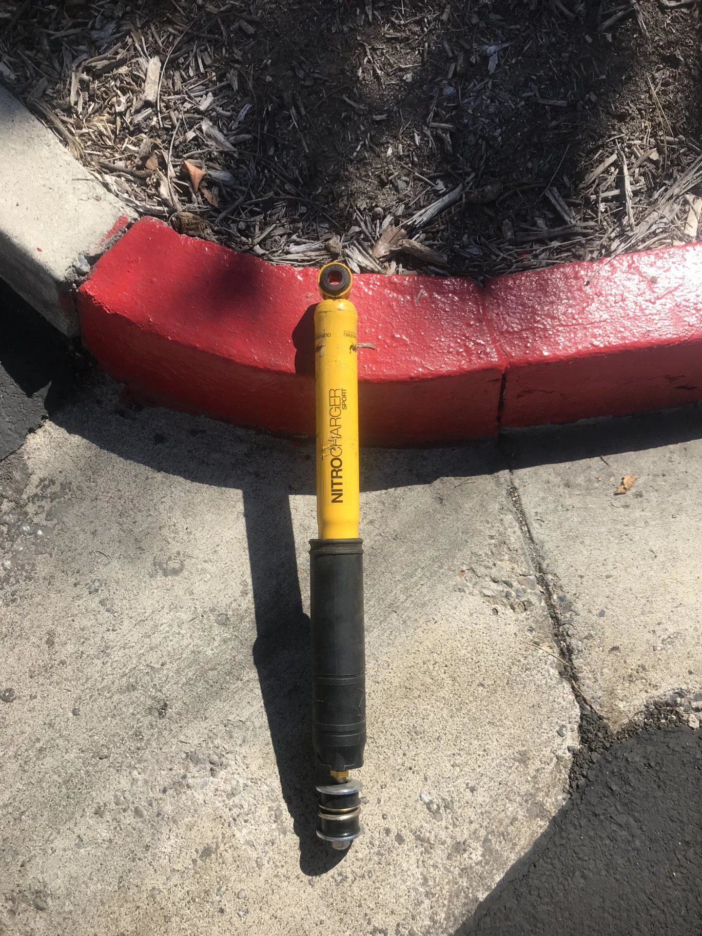

I had old man emu rear shocks, they were nice, not to bad.. used those till the 105 series rear’s came in.. both front an back are loop to pin.... I put the 100 series fox 2.0 rears shock up front.. to give it the extra inch or so.. almost put 37’s with 2 inch body lift.. but stayed at 35’s the weight difference was a lot to add plus a heavier rim.. TRD supercharger helps

what is loop to pin do you have pics of your shock setup? why did you go with 105 series shocks?

Loop just means the shock slides on a bar an ranchets on a stationery tighten....
pin means it go’s threw stationary position to lock down with a nut.. 2000 100series for me...
100 series shocks were too small an we’re really only going 1.5 in the front an I needed more.. so I went with building my own kit.. everyone has favorite an everyone ones idea is good.. create your own work of art , hope it helps j
I followed some builds of the 105 series cause I really like it.. it’s a bit beefier shock , more travel an matched how many rotations I turned the torsion bar.. two rotations an I marked the bar with a sharpie

As I’m sure your aware, the 105 series utilizes a solid axle front suspension while our 100s are IFS. I could potentially see 105 series shocks working on the rear with enough lift, but am honestly shocked to hear that you put 105 series shocks on the front as most of the 100 series shocks options for our IFS rigs allow us to utilize pretty much our full travel limits of our IFS.
While you mention making sure the mounting points are correct, you go into no detail on compressed/extended lengths or any other shock factors.
Just wanted to clarify for future readers that it is not recommended to switch to 105 series spec shocks. I would like further data.
