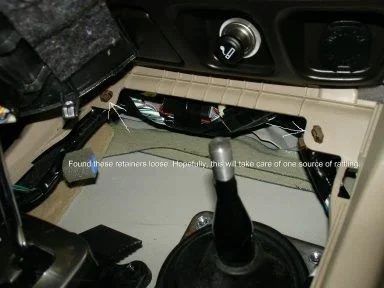

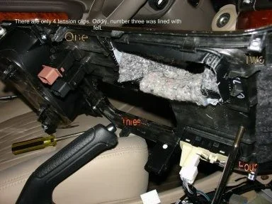

Finally got enough courage to remove the shifter console. Only 4 clips! Here are some photos:

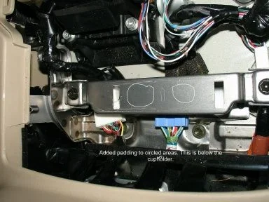

Bringing this thread back from the dead. I have had a VERY irritating creak/rattle in my center console. It seemed to be around the are where the cupholder is joined to the console. When the noise occurred I found I could stop it by either pushing down hard or lifting up.
Anyway, today I got a chance to pull up the console and fix it. Pulling the console if pretty easy -- just need to pop 6 clips as show in the FSM, then disconnect 4 wiring connectors (AHC, ECT, seat heaters).
In my case the problem was that the three screws that attach the cup holder to the console were loose, allowing the two pieces to rattle against each other. A quarter turn each with a screwdriver solved the problem.
I've attached a few pics for others' reference: view underneath the console and two pics showing the placement of the three screws mentioned above.
