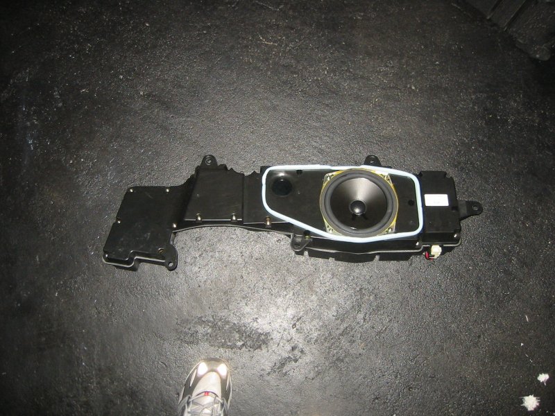

But i might still take that subwoofer out...its just slowing me down.

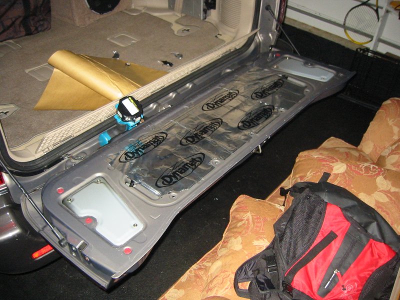

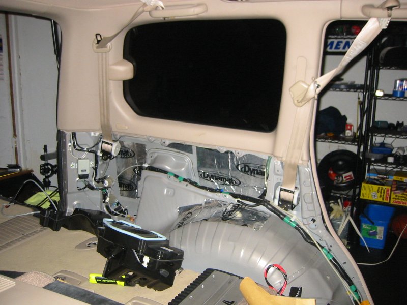

well, had nothing to do tonight so i took out my stock subwoofer that was an extra "6.8Lbs" Well after i took it out i looked inside and i saw my fender from inside the car. I thought, i cant keep that like that, too much road noise will come thru. So i made an extremely fast trip to the local best buy....using the trusty LS430...damn that thing flys. Anyways, took the sub out and slapped some dynamat on the fender for some giggles. I also put it on my tailgate covering all the cables and holes and wires. Basicly just took a sheet and slapped it on the tailgate and cutout the holes for the clips.
As far as rattles i didnt notice any more rattling, but there is a big empty space inside the panelling now...i guess i could stash some extra clothing in there if needed...and gain access to it thru the jack door.
here are some random pictures i took. And for anyone who looks at my sub and goes, uhhhhh mine looks different wtf? I had the premium system for 2000 in the LX470, the nakasushi or whatever it is, lol! jk.
