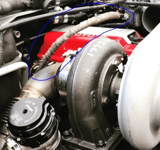

I don't have any pictures but a piece of 1/2' shrink tube from an industrial electrical supply house was the perfect product. It was in 24" or 36" pieces IIRC..
Hi, Electrical shrink wrap on cruise cable also. Mike

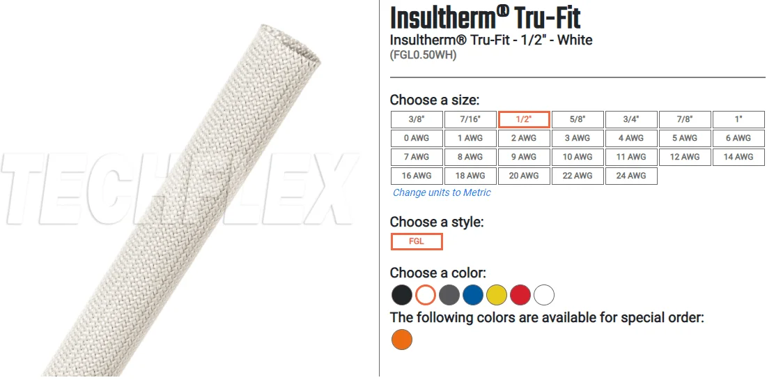

Example fiberglass-foil sleeving advertised, though fiberglass outer would be nicer for incidental hot contact. Or there's colorized fray-resistant fiberglass if just looking to redress over the existing sheath:

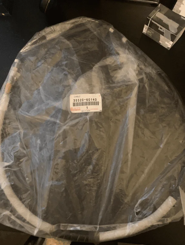

Gotlocked: Can you post up the length of the new throttle cable assembly (housing) end to end without the cable, and then just the length of the actual cable along with close up photos of both ends?
Also, curious how the transaction was processed, any issues with your credit card or other form of payment?

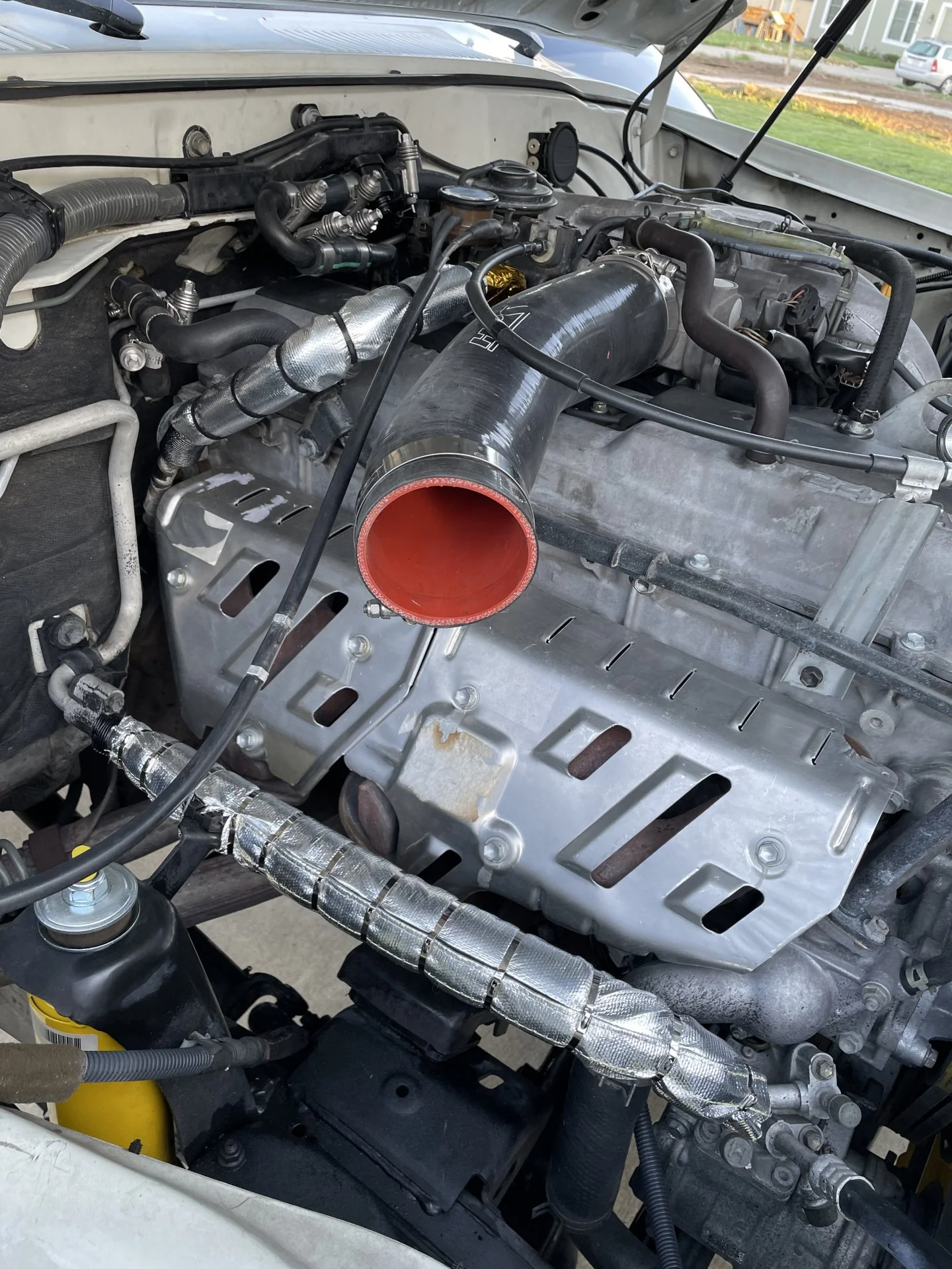

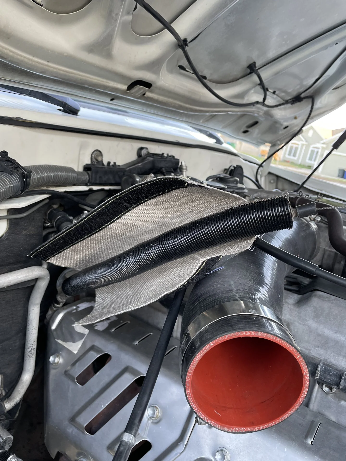

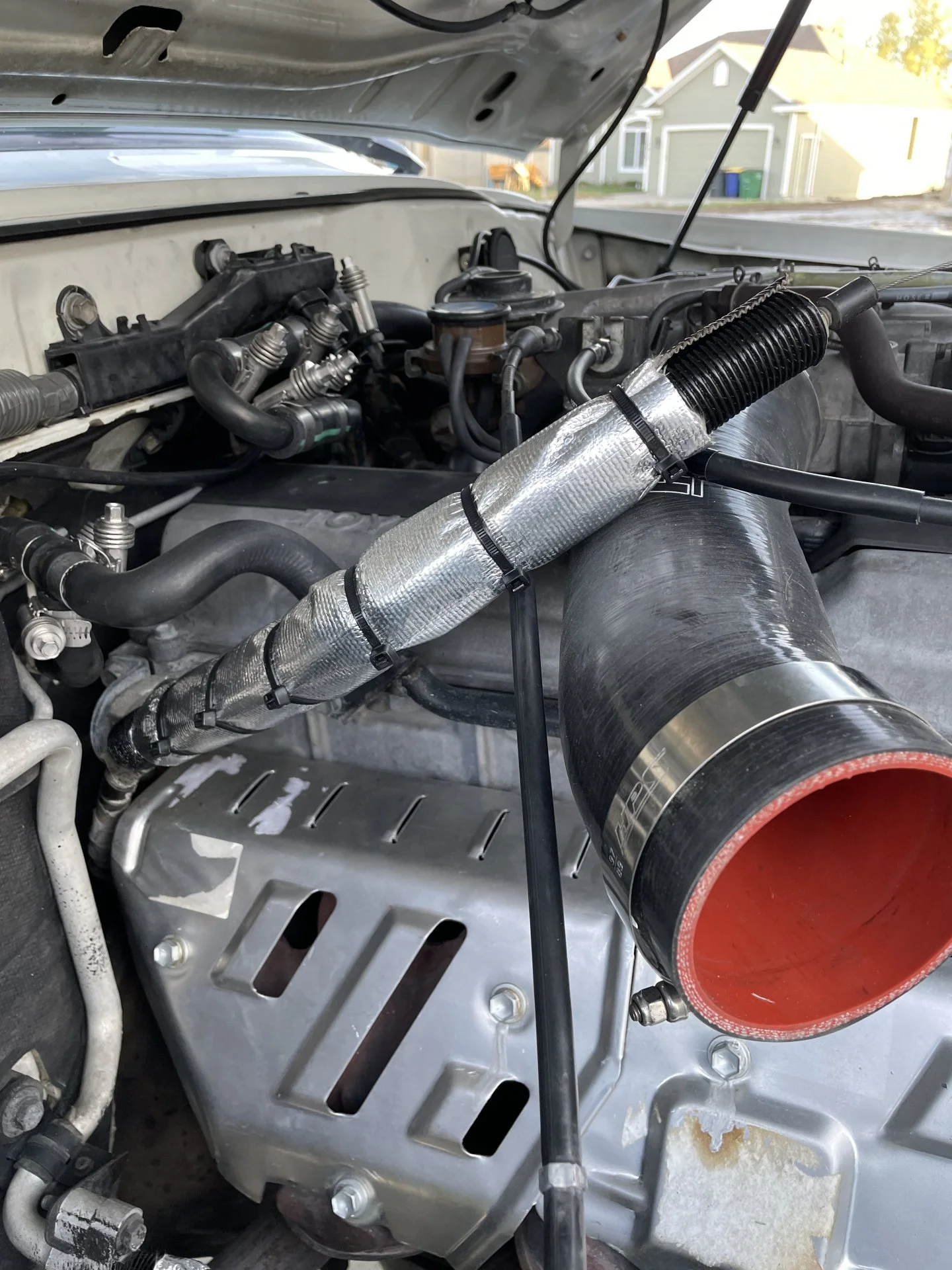

FWIW I rewrapped my cable assy with Tesa tape then slipped a piece of adhesive lined 3/4" heat shrink tubing over that, then a section of aluminum coated fiberglass around the section closest to the manifolds.
For what it’s worth I rewrapped my A/C line and trans cable a couple weeks ago with various items from Amazon. Worked out great and is very much overkill.
Good work

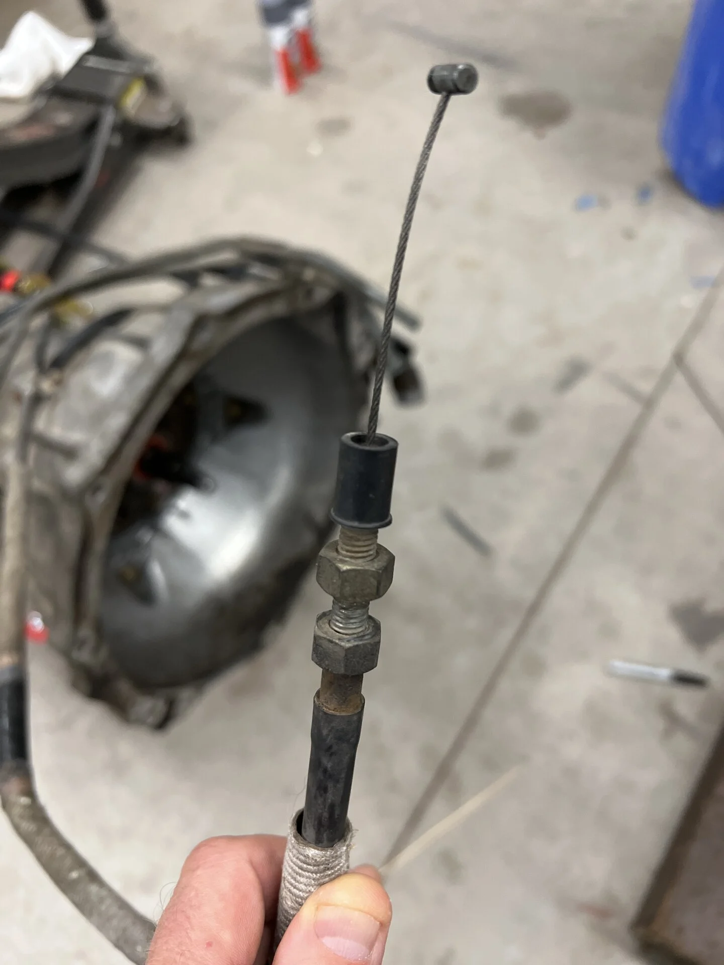

Trying to add some / refresh the protection to the kickdown. Can’t get the 1/2 heat shrink over the adjusting nuts which requires the rubber boot to come off the throttle side. Normally I’d just tear into these things but since this part is unobtanium I thought I’d ask the group. Can the throttle side rubber boot come off without damaging it?
