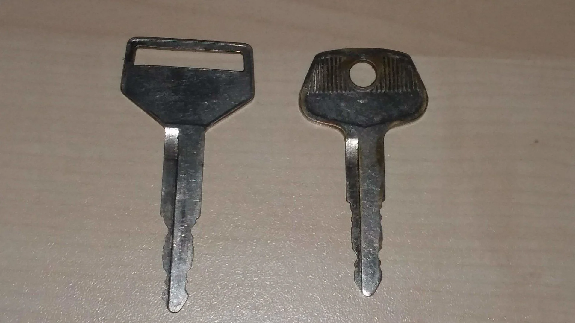

Thanks Andy, taking your suggestion, I just got off the phone with Del Toyota in Thorndale. VIN won't work but as CAZ pointed out, the passenger side lock code seems to hold the "key". I'll try removing that this evening. Del says they can probably source the blanks once I give them the code BUT.....the idea of having a hand crafted, artisanal, locally sourced, genuine, no artificial ingredients CAZ key is a very enticing idea! :hmm:

Hey Andy, the one on the left. I just ran out to the garage to see how difficult it is to access the lock. Awfully nice plastic seal behind the door panel. I guess I'll try to peel that back carefully to see if I can get eyes on the lock itself.
