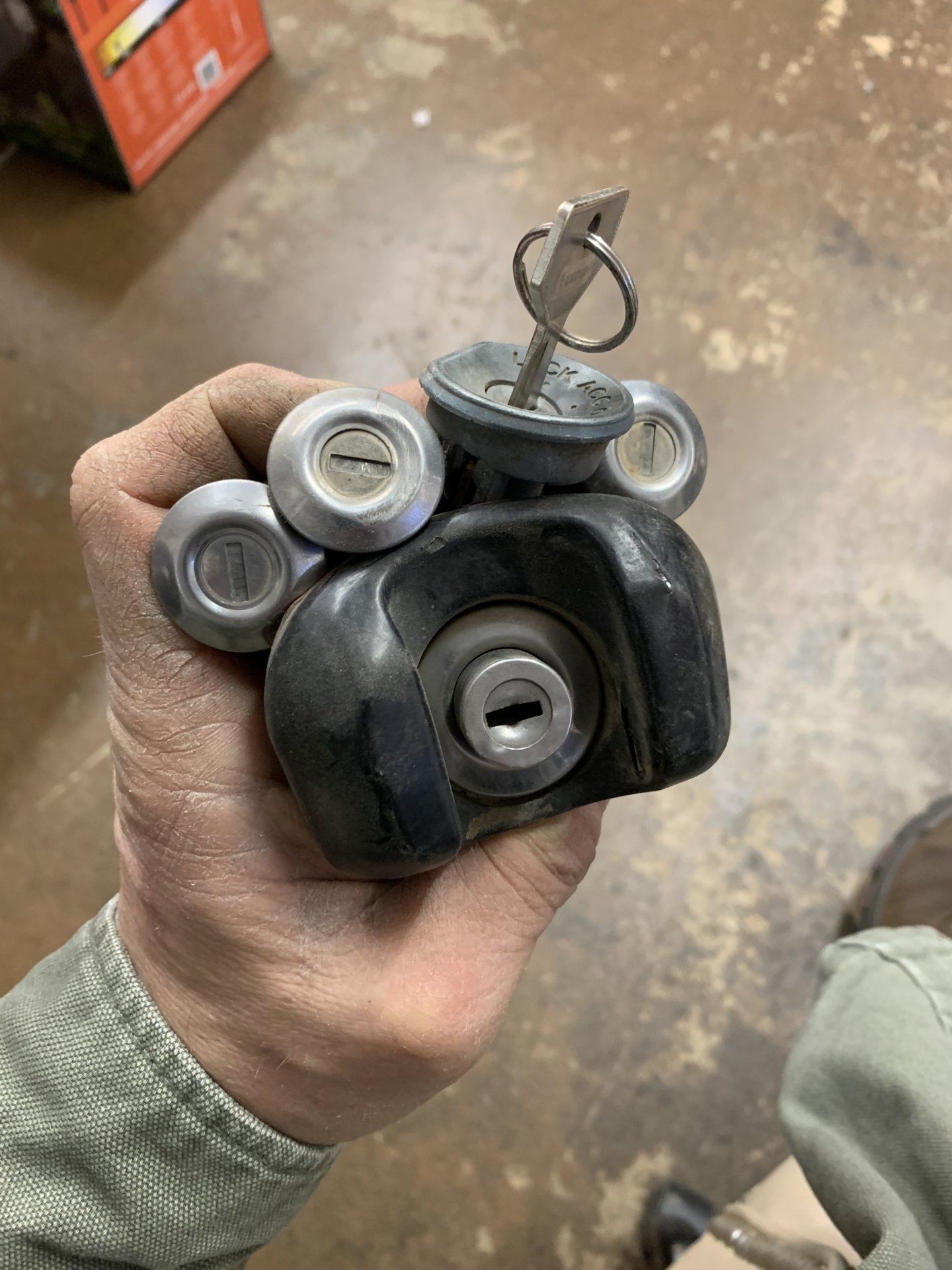

Progress Report: After removing the passenger side lock cylinder I cleaned it up and found a 5 digit stamping. 1 letter followed by 4 numbers. I gave this code to the Del Toyota parts desk and after looking it up in his book, he confirmed it to be a good code. Says he will have 3 (yes 3!) new keys to me within a couple days. If this works, I may remove the ambulance door lock cylinder and see if I can finally get a key for that door.
For those who are wondering, I did use a phone mounted endoscope in an attempt to find the lock cylinder code without removing it from the door. In my case, the stamping was on the top of the cylinder which, had it been clean enough, could have been identified with the endoscope. However, I couldn't see any numbers until I pulled the cylinder and cleaned off the grime. Only then did the numbers reveal themselves.

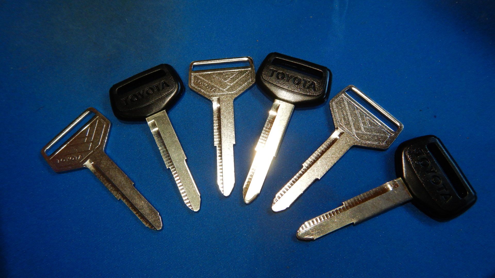

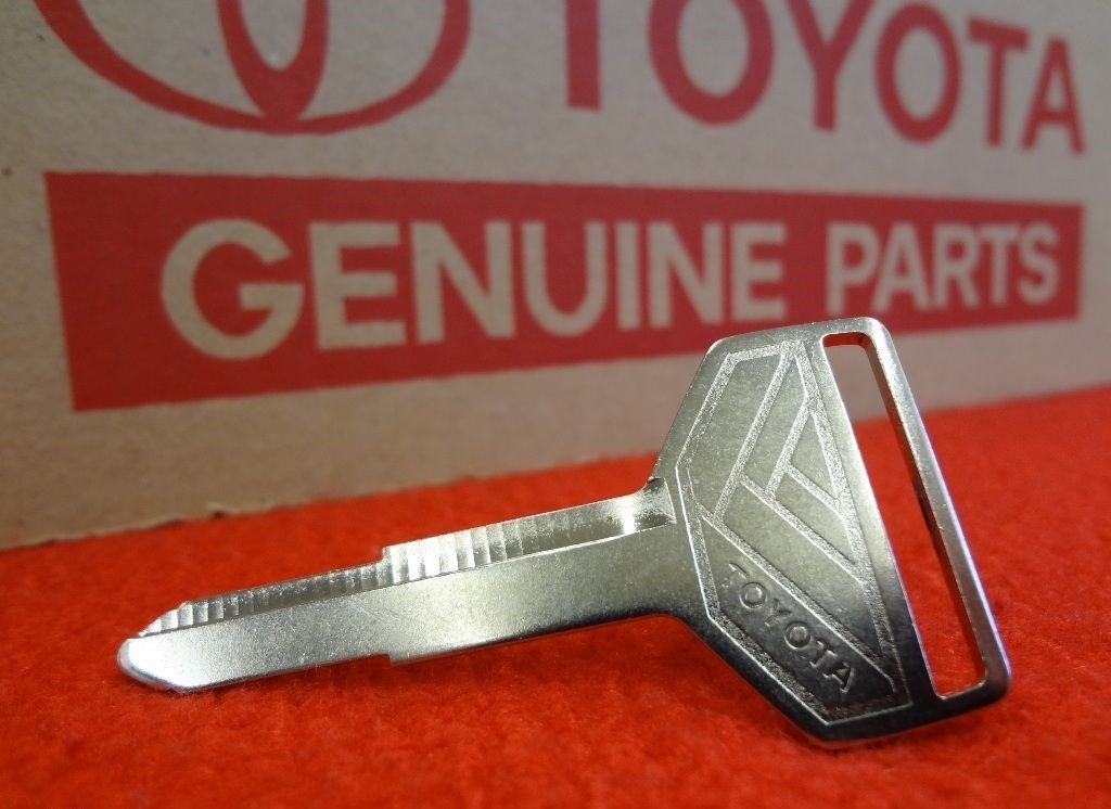

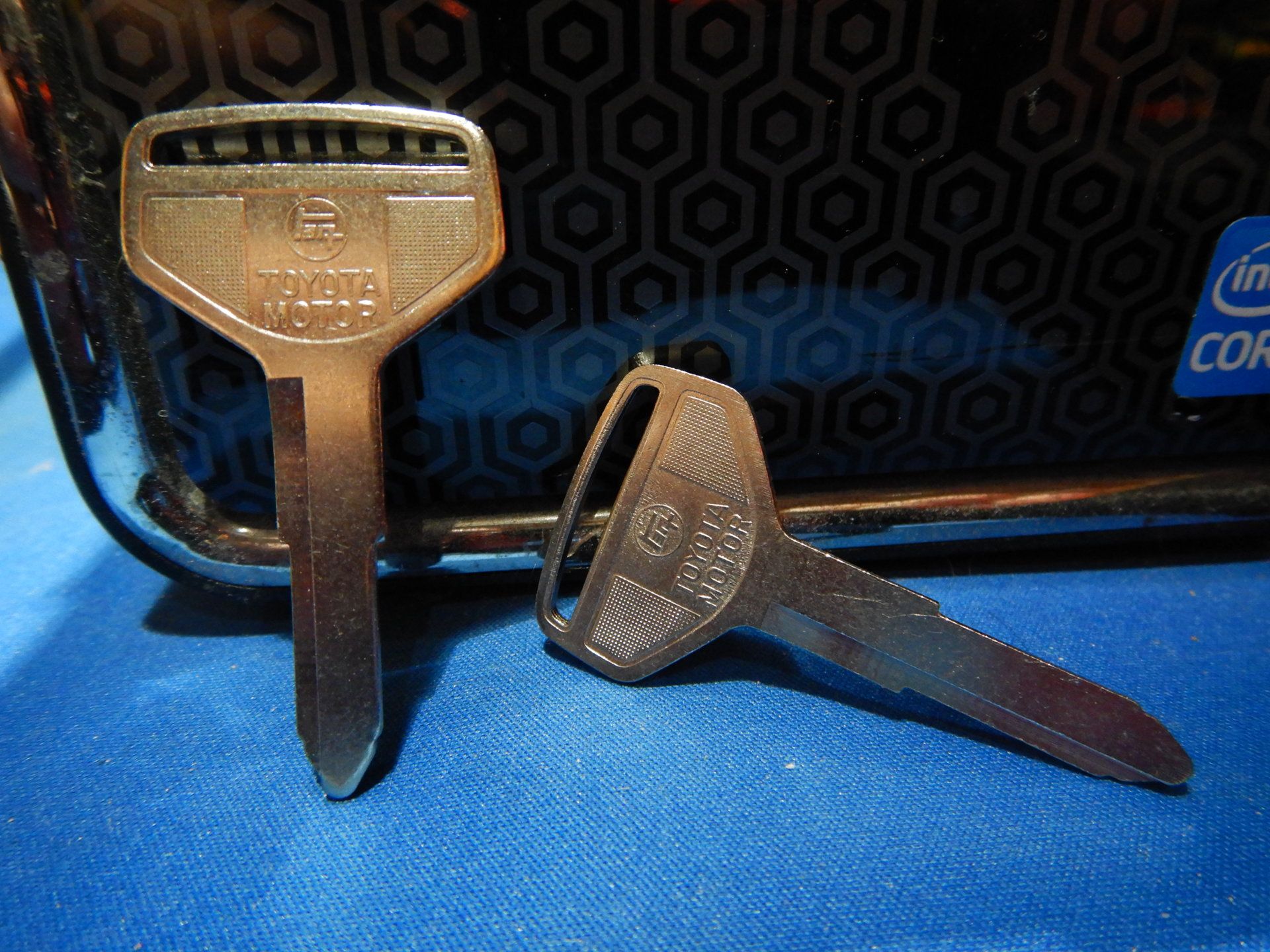

Hi Ken , Matt here
sorry to here about your Lock & Key issues ,
I will get right to the chase :
-I have a SST code cutting machine ,
- Dozens of OEM Toyota Blanks in-stock
- and can have a set of fresh keys cut in 15 minutes for u
now the interesting part , I read the entire thread and gather u are in Lancaster , PA maybe , or near by perhaps ?
- My shop is about a hour and 1/2 from Lancaster , My parents live there , I go to Liditz all the time to shop and hang out
- im north east of Washington DC
- i have 2 ideas , u come get the keys from me , Keys in hand in 90 Minutes
- or i take them to the post office before 1PM EST and U get them in the mail tomorrow VIA USPS Priority Mail Express
service
Let me know I will Help U out any way I can if Your stranded without your 1980 FJ40 Ignition & Door's

The day after I gave Del the code taken from the passenger side lock cylinder, they had several blanks waiting for me. The service manager cut one key from the code I gave him over the phone. We decided I would try that key to make sure it worked before he cut any more. The key worked so I had him cut a couple more spares. Ran about $10.00 per key.
