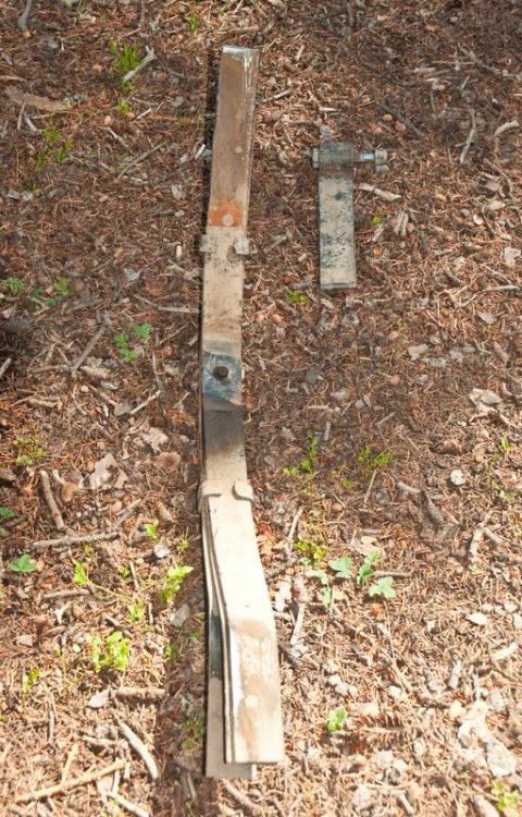

In the morning we headed off up the mountain toward the road to Kerr Lake. Being old and seemingly without memory I got us turned left when it should have been right looking for the lake road. My bad. We were turning around and heading back out to the right road when over the radio came the words "catastrophic failure". Again, not real good. The left hand side leaf spring on the Ali's Kamparoo had sheared completely off. Ash's inventive genius came up with a trail repair. We pulled the axle into alignment with my winch and then used big ratchet straps from either end of the trailer to keep it in place. Whatever works.

The next day the spring was reinstalled along with some steel tube bracing. I decided to follow them home, just in case.

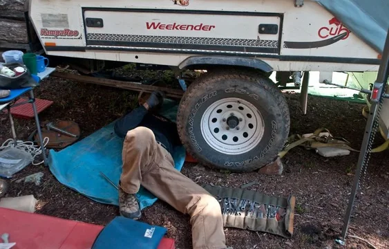

The broken main leaf spring was a bummer but between Lynn and I, things were moving quickly enough. Thankfully, Pagosa has a spring/welding shop that knows what they're doing and fixed me right up. Welding on a spring is futile but we had no other choice.

Spring repair pics

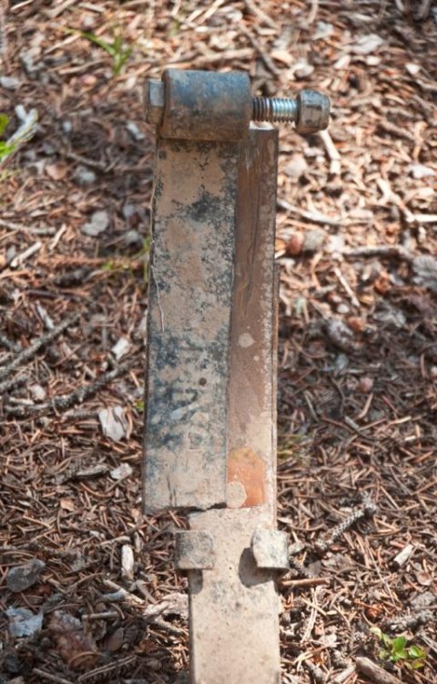

I think he was talking about the blocks/ubolts that sandwiched the springs.
and I said those were the "The PO did a 1.5" lift and those are the redneck blocks that he had someone made up." Maybe I'm confused?
Not the lift. These?
Sounds kinda grouchy today.
Ahhh, those are my field dressing splints. Never seen those? I'm filing a patent application as we speak. :flipoff2:
Those look like a good idea.
I could see those being useful on a regular rig too, not just a trailer. I've seen more spring breaks and bends on the main rig over the years than many other carnages. birf's exempt.:flipoff2:
Those are pieces cut from a piece of square tubing Ash brought up from Pagosa Springs. Never forget to take a long a portable Sawzall with a metal cutting blade!
