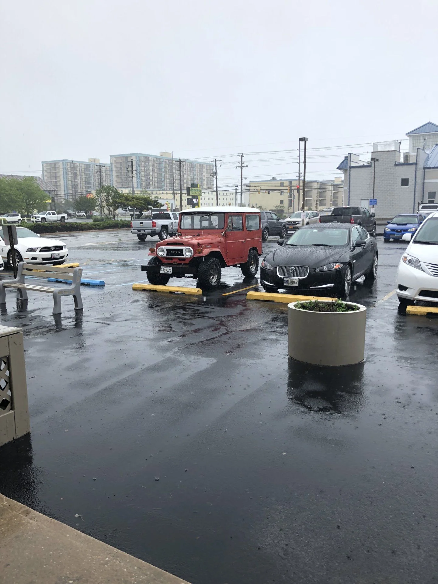

im riding around in OC for cruisn weekend and it’s POURING. Standing water on the road, some deep puddles. Water splashing over the hood etc. we stopped for lunch now the truck is totally dead. Like the battery is completely discharged. I jumped it with the jump pack, first go I got nothing. Maybe bad connection? I gave the connections to the starter a giggle then tried the jump pack again and the truck started.
We drove around a few minutes and went to get some gas and it was dead again. Hit it with the jump pack and off we went.
Maybe water on the starter or ignition coil is discharging the battery??? What do you guys think?
The amp meter stays kinda normal in the center between -30 and +30
Yeah just drove for 15 min and stopped and it’s toast again. Super weird that the battery never even got weak or anything...?
Just drove 3 1/2 hours to the beach maybe something happened to it on the ride? Overcharging or something? I’d have seen that on the amp meter though?
