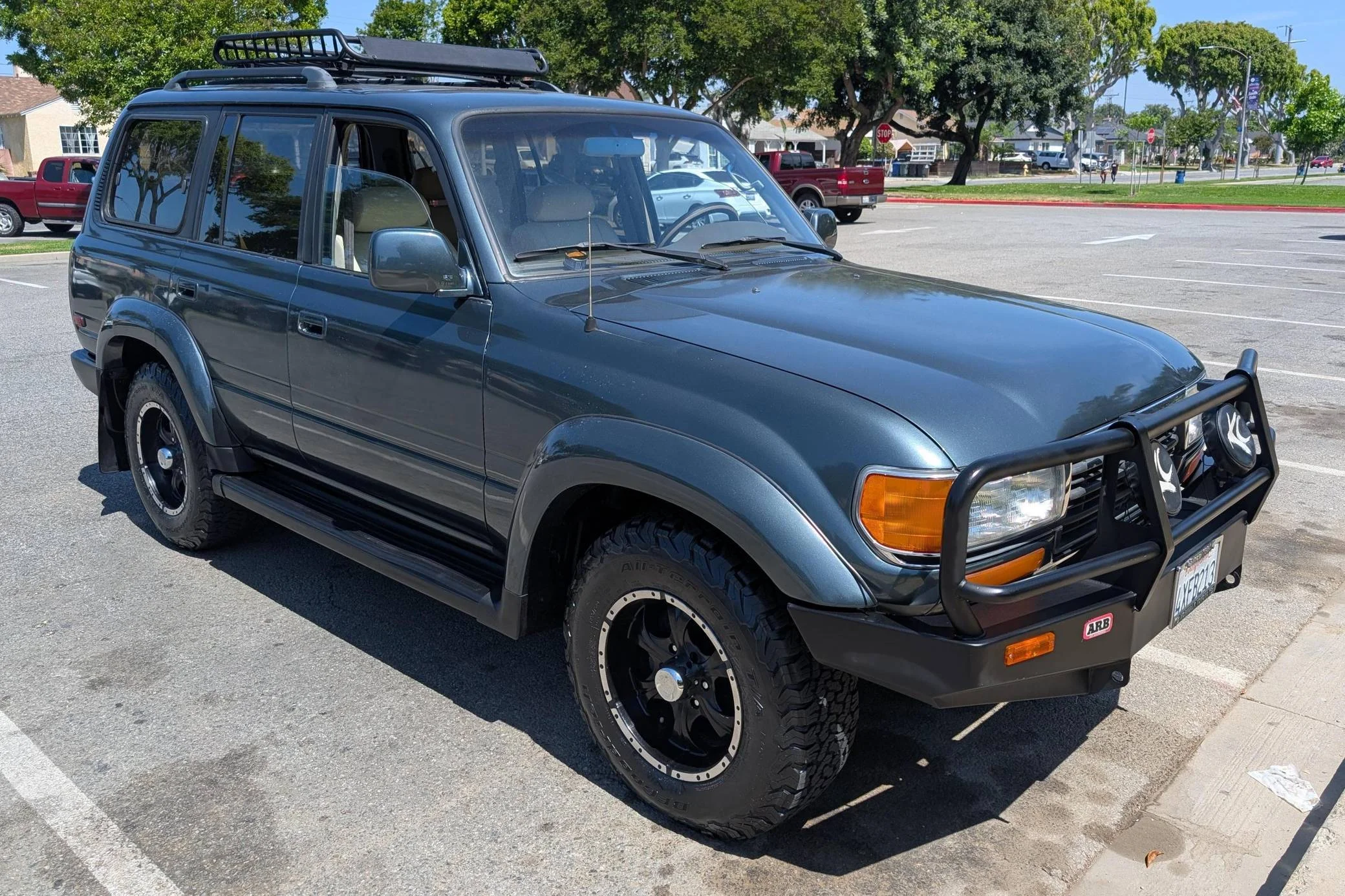

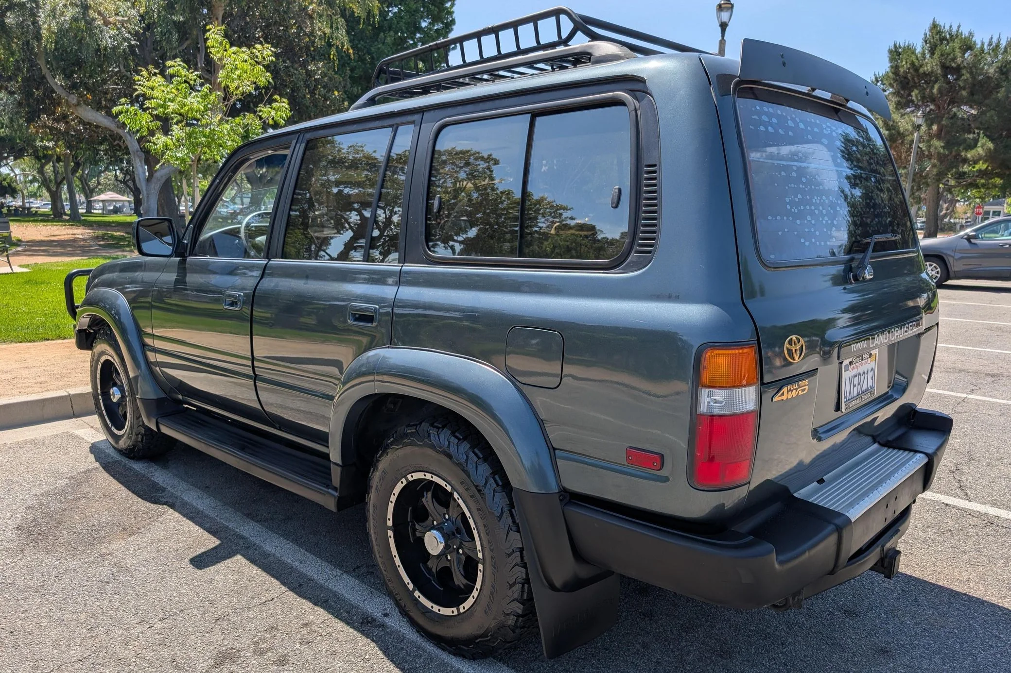

Hello everyone! I just won this 1985 cruiser at auction for $7900 (which I was not expecting 😂).
Here’s the auction:
https://carsandbids.com/.../1995-toyota-land-cruiser...
It has triple locking diffs and seems largely in good condition buy does have some flaws:
Odometer not working.
Fuel gauge not working.
Needs front brake replace.
Some wheels missing lugs.
I just bought myself a GX 470 to daily + take on some road trips, and I can only keep one car. This cruiser is all the way out in California but I have no problem driving it back. Once it’s back i could either sell it and keep the GX or sell the GX and keep this.
What do you guys think it’s worth? Did I get a good deal or should I back out and pay 400 dollars in fees.
Any advice for driving it back? Common issues? Any information is appreciated.
Thanks everyone! Sorry if this is not posted in the right place.
Very nice looking Cruiser there. Drive slow and stop and see what there is to see.
Looks good to me. As others' have said, go over anything mechanical.
Your washer hose is disconnected. Since you are in Florida, clean, prime and paint anything metal, and then use something like fluid film religiously.

Looked closer at all the photos: it's been repainted, maybe a quickie job, looks like body damage in a few places (?Right side),hood paint
doesn't seem to match the rest. Rear hatch emblem cracked
Interior seats redone with ?cheap ventilated leather covers.
Missing center console lid.
Shifter leather missing/removed
Steering wheel leather likely in bad shape (cheapo cover)

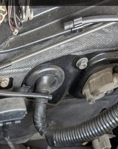

Engine (or head) may have been removed at some point, but at least one lifting hook is missing??
Ground strap to the firewall is in the wrong place.
PHH has been bypassed
At least one missing bolt for the valve cover.
Blue spray paint on the throttle body
