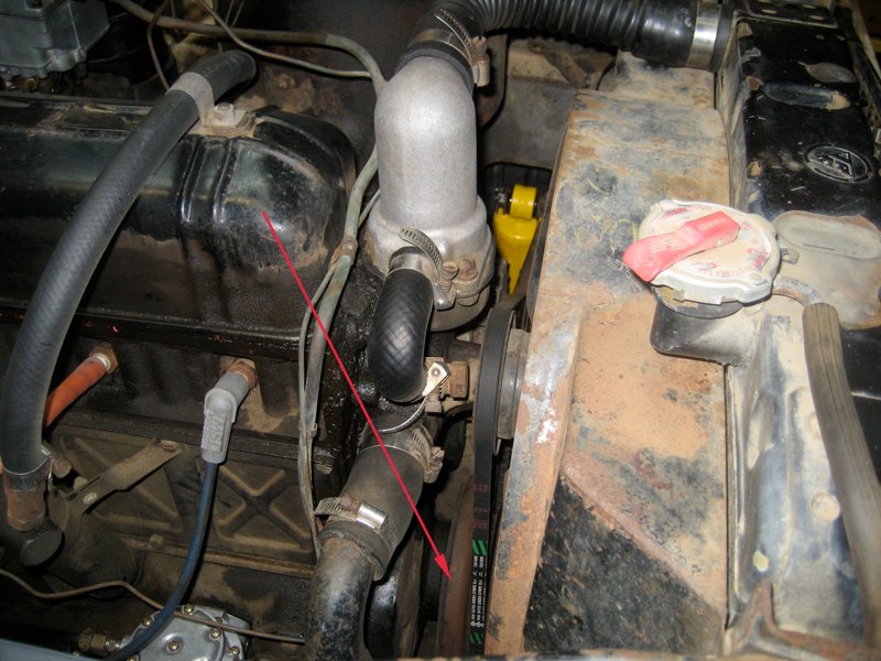

Well after driving the 45 up to work one day I decided to make the rounds of a few cruiser outfits up in the L.A. area. My first stop was to MAF for a couple small items for the 40 and then on to SOR where I met up with Marv. He came out and admired the 45 and gave it a once over while asking a few questions. I explained the "custom" rear spare tire holder contraption to him and we went over a few items I was looking for. He was also able to answer a few questions I had.
While checking out the engine compartment he seemed a little startled to find my crank pulley VERY loose. "I wouldn't drive it..." :eek:

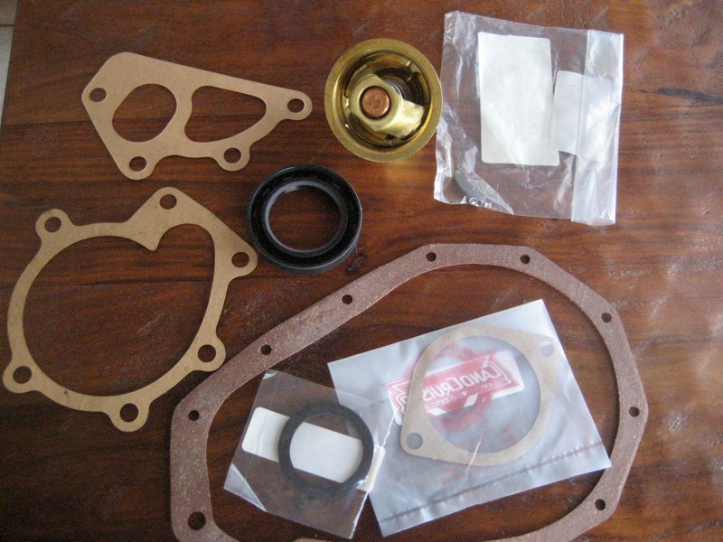

He explained how the lower pulley is pressed on and with it this loose it would probably just fall off. The worst news was that it probably wore out the crankshaft as well and I would be looking at a possible rebuild if it had. He had a temporary fix suggestion that I could probably get away with until the motor really needed an overhaul. Either way, I walked out of there a little stressed but with a new used crankshaft pulley, key, seal, thermostat, and gasket.
Then I limped her over to Mark's and chatted with him. He looked over what I had and made a few more suggestions as well as gave me better insight on the pulley issue. He also hooked me up with the other parts I would be needing once I pulled the pulley. He suggested I clean up the whole front of the motor while I'm at it. I got water pump gaskets, timing cover gasket and a few other small items and a much better understanding of what I was up against. He also suggested a much better fix if indeed the crank was worn and the new pulley would not press on correctly.

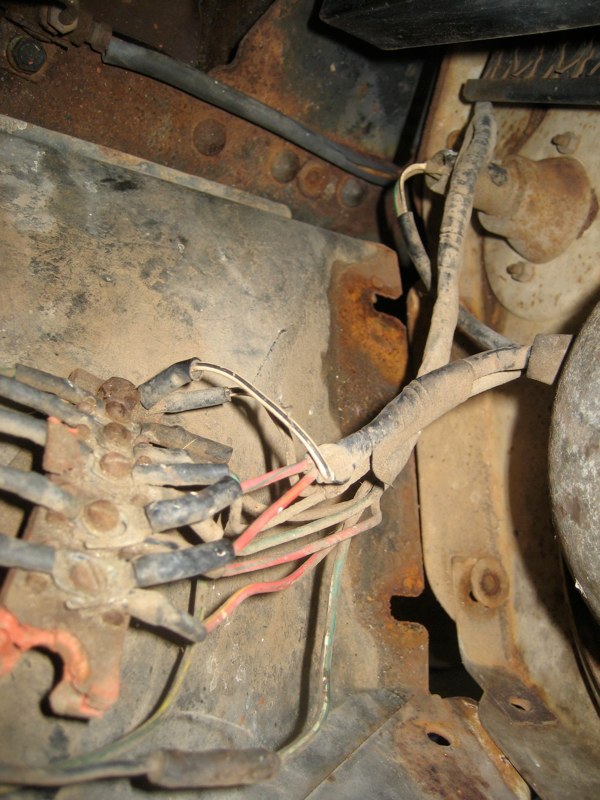

Then I noted the wiring configuration of the terminal blocks and unhooked them. These barely stayed together and both need to be replaced...

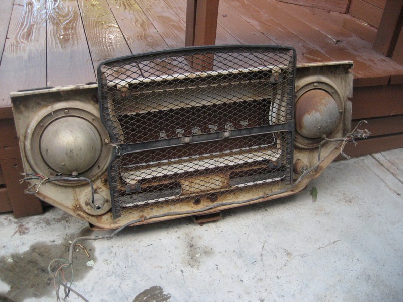

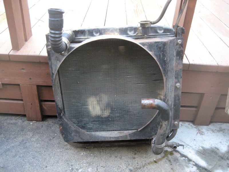

Removed the front bib and unhooked the coolant hoses, unbolted the radiator support and pulled the unit as one. I did my best to go slowly as to prevent breaking off of the two lower support bolts but one did. :mad:

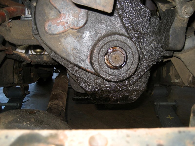

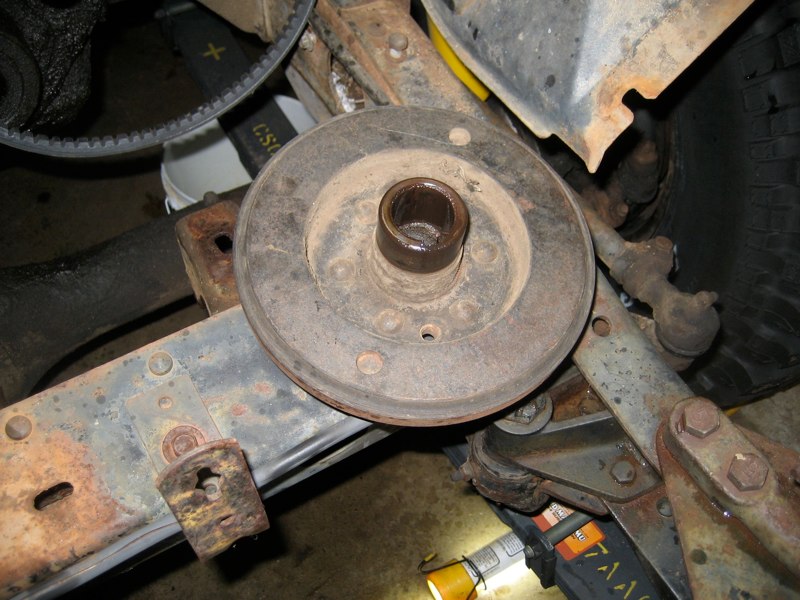

Once the radiator was out I had a clear view of the front of the motor. I had plans to change the radiator hoses as well as the thermostat and heater hoses. Mark had suggested I clean up the front of the motor and take off the water pump, timing cover, etc. since I had it all apart. The first order of business was to remove the pulley. Normally this would be done with a puller, but after looking at it Marv assured me I wouldn't need it...

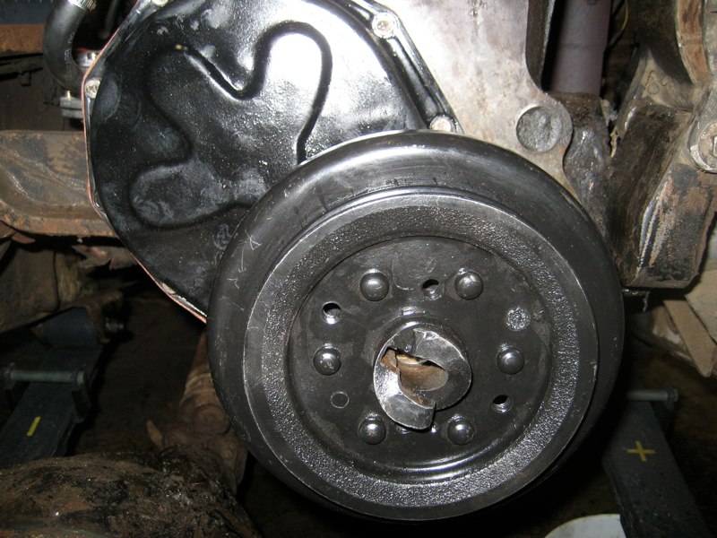

Well he was right. As soon as the fan belt was removed the pulley nearly fell off and did exactly that as soon as I touched it.:frown:
After removing the pulley I took a look at the crankshaft...

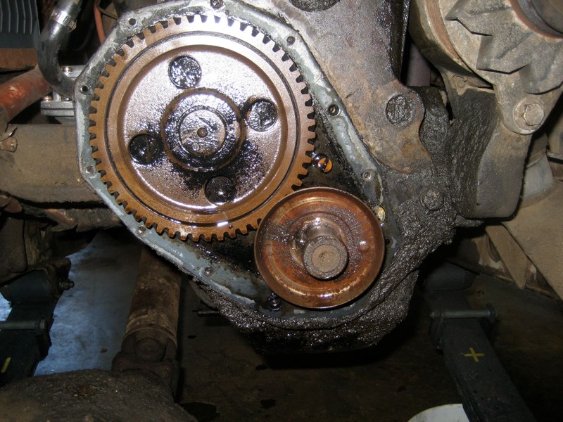

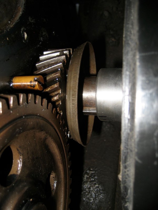

Then removed the timing cover and checked the gears for wear and slop...

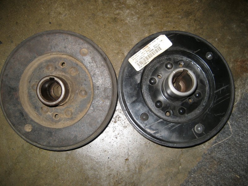

The two pulleys...
Now the moment of truth. I slid the new pulley on to see how loose it was going to be. To my surprise it barely went on before it stopped. Maybe 1/8 of an inch or so. :confused: I must not have lined up the keyway I thought. But no, it actually was a very snug fit! :clap:
Now I felt pretty good about the repair and gathered up the rest of the parts...

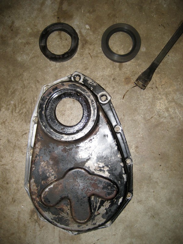

Removed the timing cover and removed the old seal...

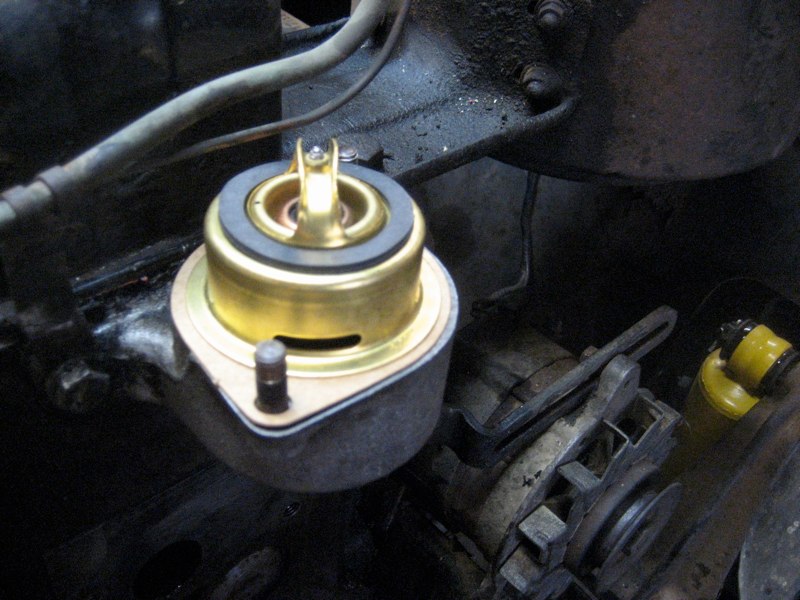

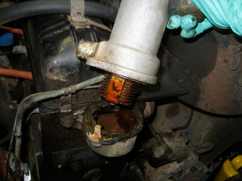

After pulling the thermostat I was a little more convinced that this truck really does only have about 50,000 original miles. I think there's a chance this is the original thermostat. I also just flipped 50,000 and the 5 is close to virgin white while all the other numbers are very discolored.
I cleaned up the housing, scrapped off the welded on gaskets, re-installed and placed the new thermostat in...
While I had all this stuff off I cleaned, sanded and prepped all the parts for paint. After a few coats of primer and paint everything looked better for the re-install. I cleaned up the gears and removed all the crap that had been built up over the years on the front of the motor. Then I pressed in the timing cover seal and re-installed it with a new gasket and pressed on the new crank pulley...

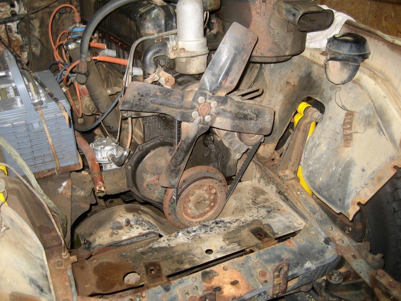

Now that the initial problem was solved it was time to put everything back together. I put the fan back on...
http://www.dominicsmith.com/1965_FJ45_Pulley_files/Media/IMG_3072/IMG_3072.jpg

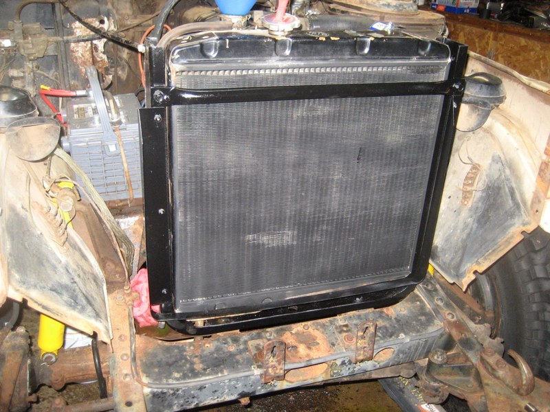

Put the radiator support back in...
[IMG]http://www.dominicsmith.com/1965_FJ45_Pulley_files/Media/IMG_3073/IMG_3073.jpg
And slid the radiator back in...

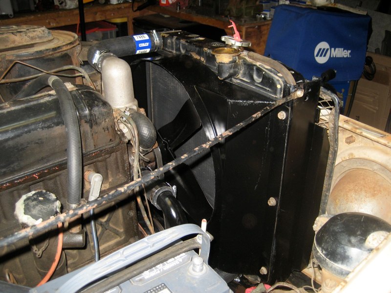

Finally I put the shroud back in, reconnected all the hoses and refilled the radiator...
I re-wired the terminal blocks, placed the bib back on and that was it!
