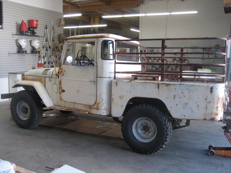

Mike helped me mock up what the SWB would look like with the OME 2.5" lift and 33x10.5x15 BFG muds. At least as best we could.
We started by measuring his truck from ground to frame at all four corners (He has the OME lift). Then we swapped 2 of his tires onto my drivers side and raised my frame to the same measurements as his on all four corners.

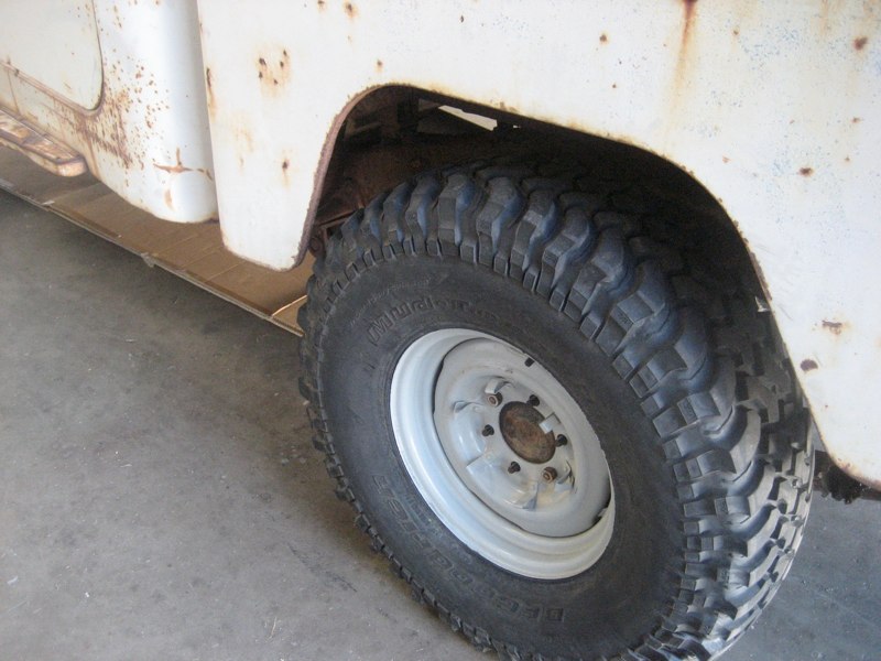

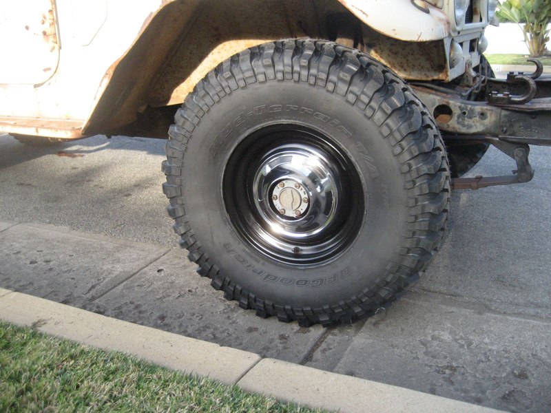

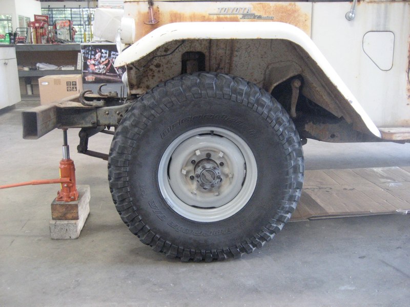

Here's what it looked like...
Front...
Rear...
If I do go this route I'll hold onto all the stock stuff so it can be returned to stock height if I ever decide to. The springs on it now are not level and all the tires have to be replaced too.
(EDIT: I normally wouldn't do the lift and tires first, but I need new rubber to drive this safely and would rather do it once. The springs need serious help as well...)

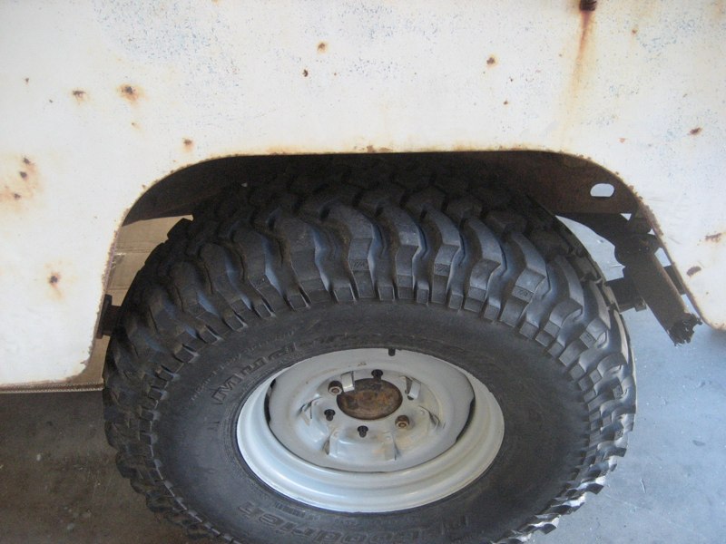

The rear is a little tight but we articulated as well as we could with some ballast and the tires tuck nicely inside the rear fenders but I'm not certain they would clear the fender just to the front of the tire. Another 1/2" back would make it perfect. If I choose to, could I slot the spring perch on the bottom of the axle to allow the spring eye bolt to clear and push the axle 1/4" to 1/2" back? :confused:
Man,...haha, now you guys are just hanging out playing with your toys.
BUT with that said, the mock up looks pretty good to me. I say gopherIT.

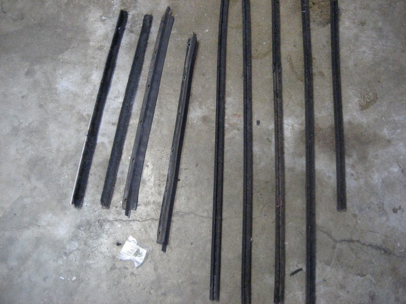

Here are the window felt channels and trim pieces that Mike gave me (with new clips to boot!!)...

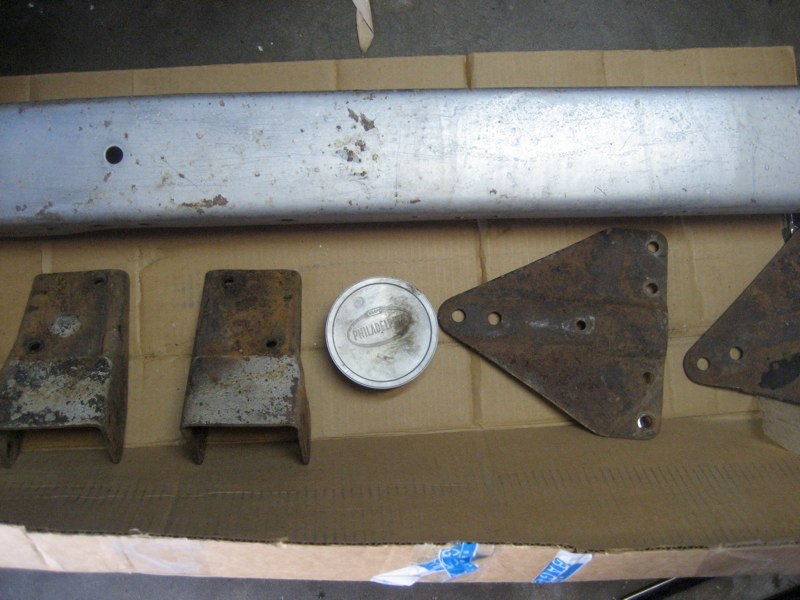

And Jim (centerlineseal) drug a stock bumper and brackets on a plane from Idaho for me to replace the welded on channel bumper... :grinpimp:
Thanks guys!

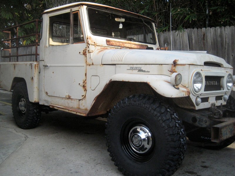

3 coats of rattle can primer and 3 coats of rattle can semi-gloss and they don't look too bad. I also took some polish to the old hub caps and here's what I got...
EDIT: OOPS! Should have added that these are 33x10.5x15 BFG M/T KM

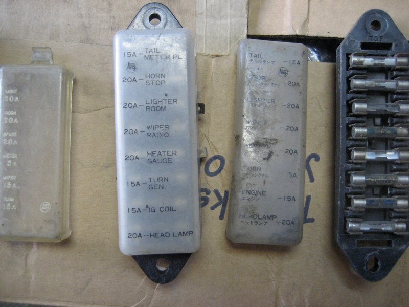

And to think I have been asking around and searching for a fuse block cover for my 73...
Found a set of these I'm considering adding to my ride after a little cleanup/resto...

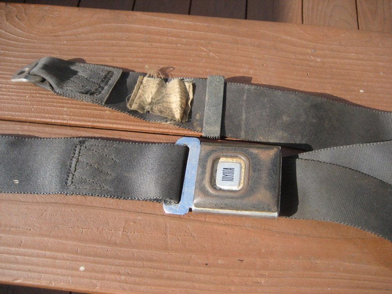

I have everything except one of the button (female) clips. I'll open a few more boxes of stuff to see if I have one somewhere.
I'm thinking it would be good to have seatbelts...
:grinpimp:
Hey Dom, I've got a full set of pretty good lap belts from my 73 I just pulled a couple months ago for my shoulder belts you can have. I might have some other parts kicking around the garage you can use as well. Need to see what else is up on "that shelf" Let me know if you want the belts.

Thanks Dan. Yeah, the springs are beat and they need replacement. I mocked up the 2.5" OME and I like the look of that. I also went on a ride with Mike in his 45 and that OME is damn smooth. The rear tires almost rub the tub and the exhaust pipe and there is not much room up front either.
