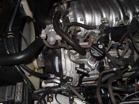

Look for sticker on timing belt cover that states when T-belt changed. If you find it then don't change until 90K miles more, and go find different mechanic that can see better. If no sticker have changed.
Timing belt changed sticker, on DS T-belt cover just left of engine oil. Sometime place on PS T-b cover:
