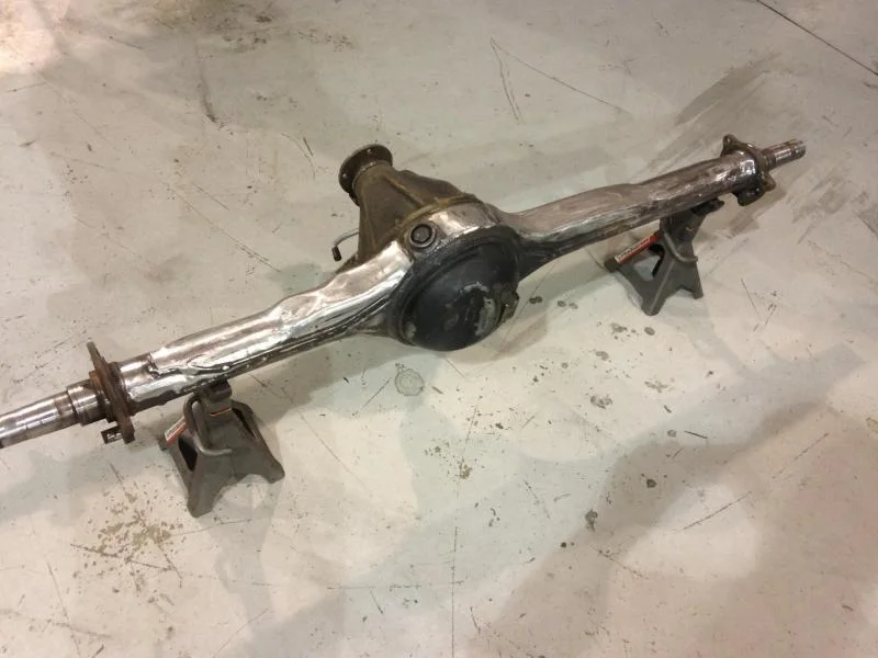

80 Series rear axle housing stripped of factory brackets, getting ready for double triangulated 4 link and 12" coilovers in the rear. Lot of work cutting the brackets off, thanks Tacklebox!
