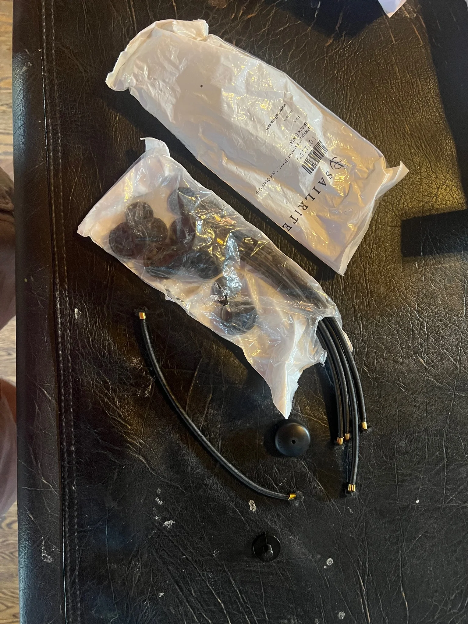

In the box that she sent me were a couple packages of Sailrite Stayput Shock Cord - and fasteners.
Does anyone out there have this magnetic Soft Top - - or does anyone have any information on how the shock cords are to be installed?

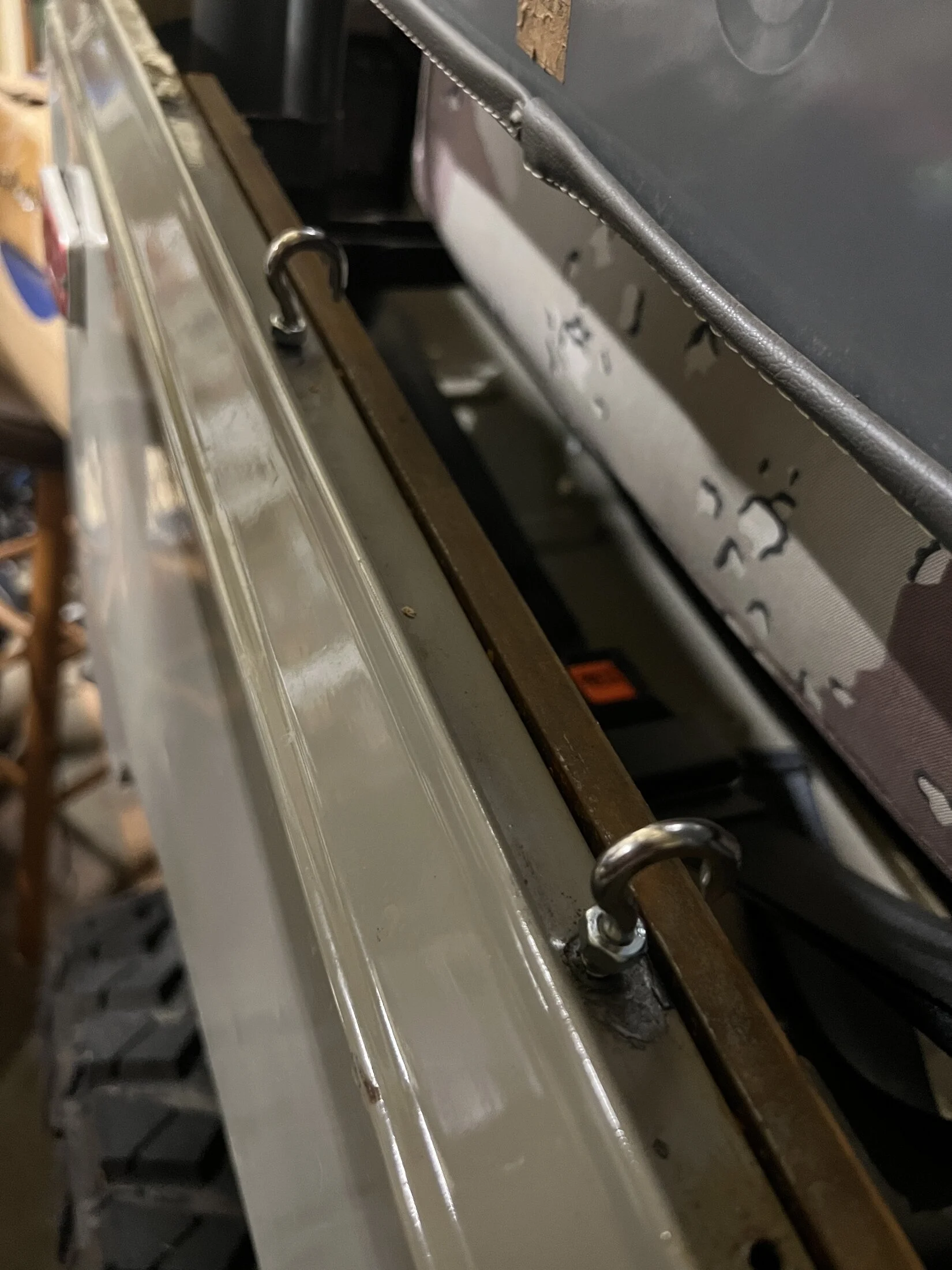

I have one of Julie's tops, and yes took quite some time to get but that was years ago now. Those Sailrite Stayput Shock Cord - and fasteners go along the inside edges of the top near the tub, and then you fasten the loops to the tub. What I did was buy threaded hooks same size as the hardtop mounting holes, cut to length and then screwed into the holes used for the Hardtop Bolts. I can take some pics and send you this evening

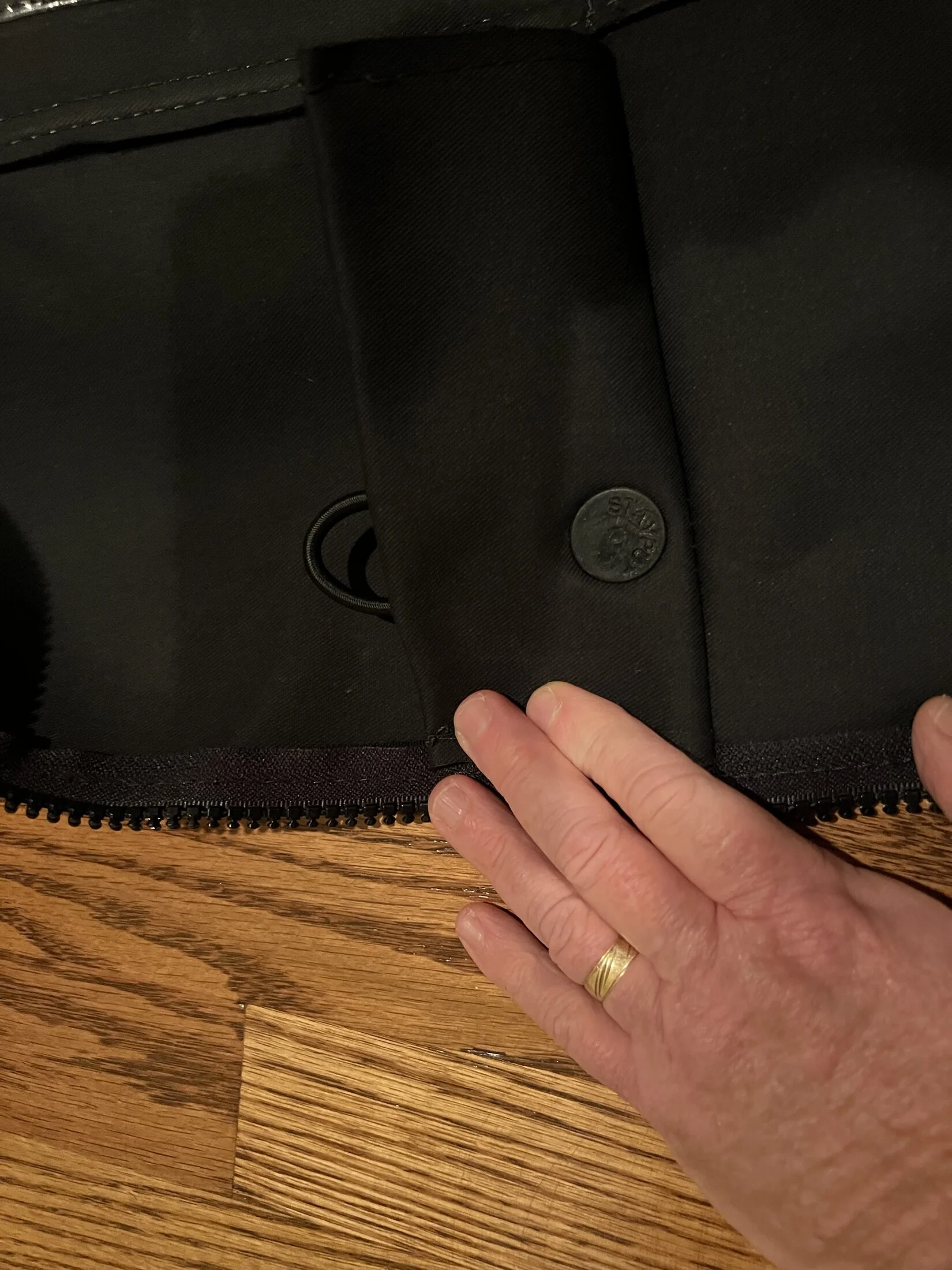

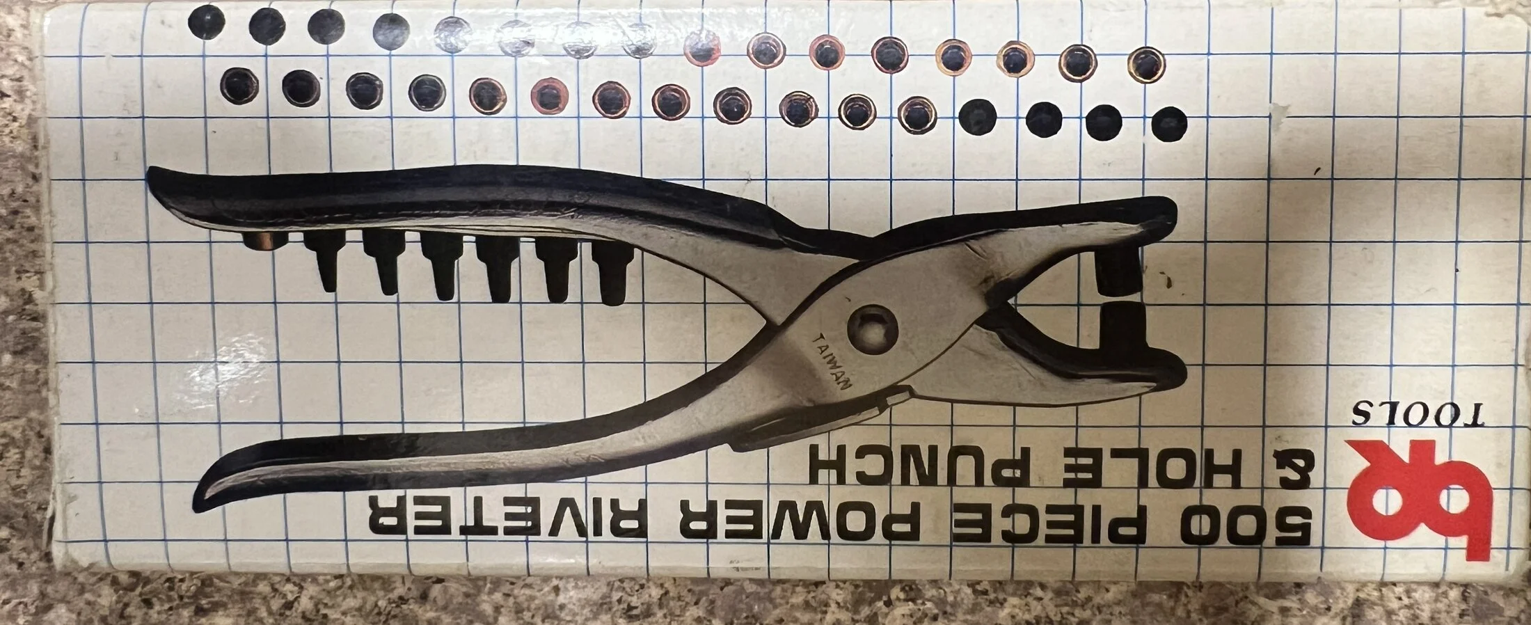

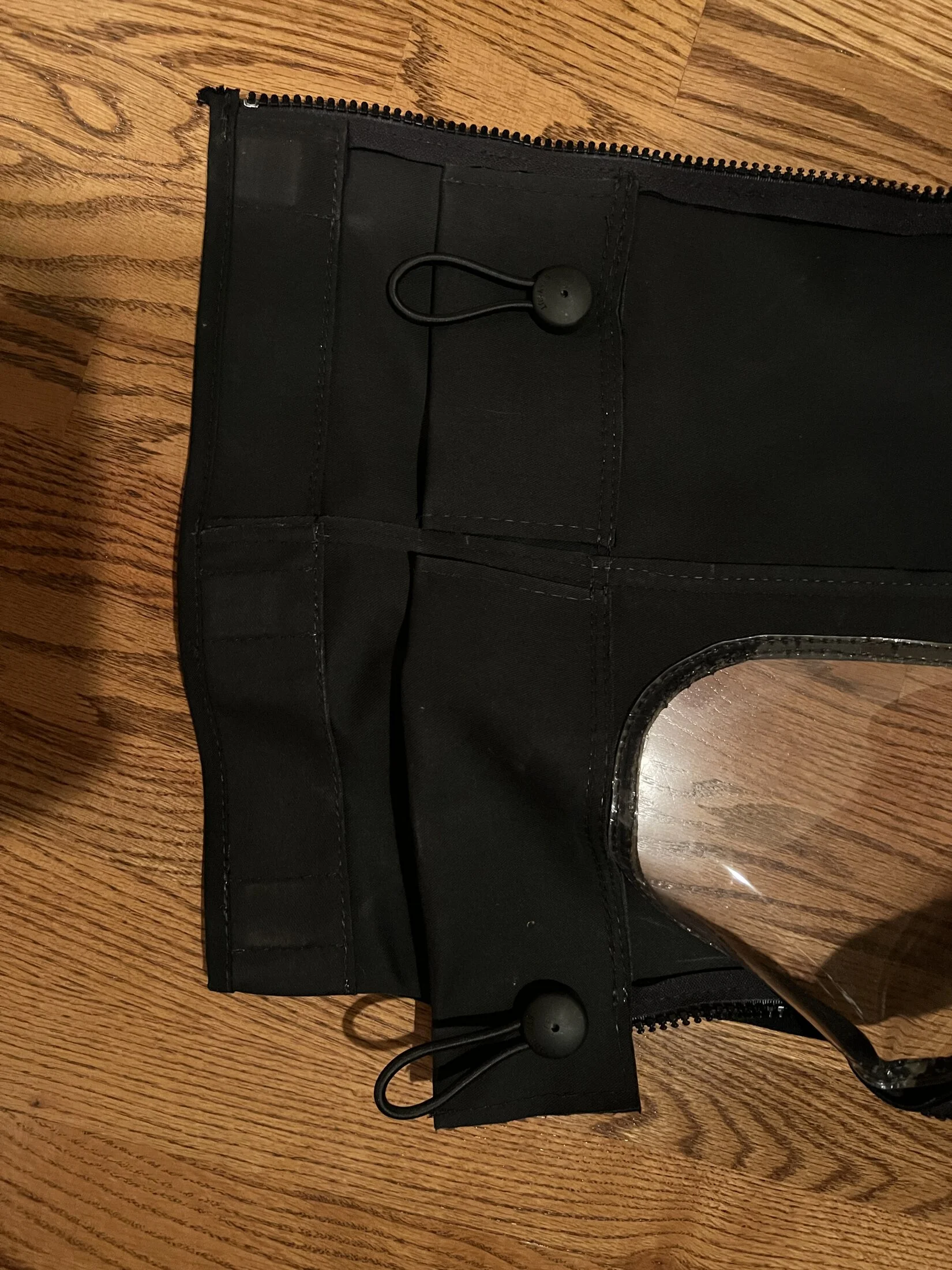

Ok, here you go. Apologies in advance as I am not the best with adding pics but, below are pics of the hooks installed (I am currently putting hardtop back on so just out 2 hooks in for illustration), then you can see the tool I used to punch holes in the inside flaps of the top, then the frontside and backside of the installed loops onto the flaps. I had to call Julie way back to figure this out as it was not obvious to me. Hope this helps.
