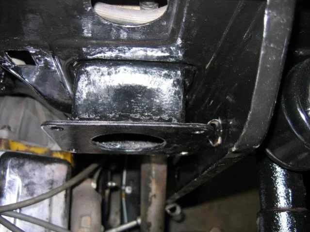

if you are talking about the adapter that goes from 3 bolts to four bolts i dont know how long but it does clear

is not early model gee i thought it was it is a 1970 model and it does go to the edge of the rib and if you look it does clear the rib

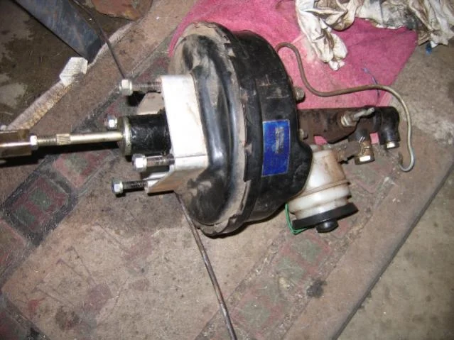

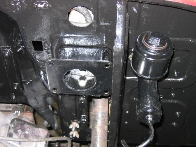

I just built an adapter for the '79 mini truck booster to install on my '65. Pics attached. The booster came with an aluminum spacer and steel plate. I used the steel plate as a mounting plate for the adapter, as it already had the right hole pattern, and just welded it to four plates and a face plate with the original 3 hole pattern + a big center hole. I placed the booster/MC up on the firewall and measured how much spacing i'd need, happened to be the same as some flat stock i had laying around which I used for the four side plates. Worth mentioning I have a SBC so length wasn't a real concern, but I also didn't want it any longer than needed to clear the rib. Sorry no pics of it all installed as I've found that the booster now heavily rubs the clutch master cylinder (which wasn't installed at the time of fabrication), so my works not done yet...:beer: I will use the aluminum spacer still. FWIW my adaptor is 2 1/4" in length, and the aluminum spacer is 1 1/4" in length, so call it 3 1/2" total.
Hmmmm, I thought clutch cylinder clearance wasn't going to be an issue if I can find an early mini truck booster.
I probably wouldn't be had I made my adapter with the clutch M/C installed. Honestly I'm fairly certain it's a goof on my part. The interference is probably no more than 1/8".
