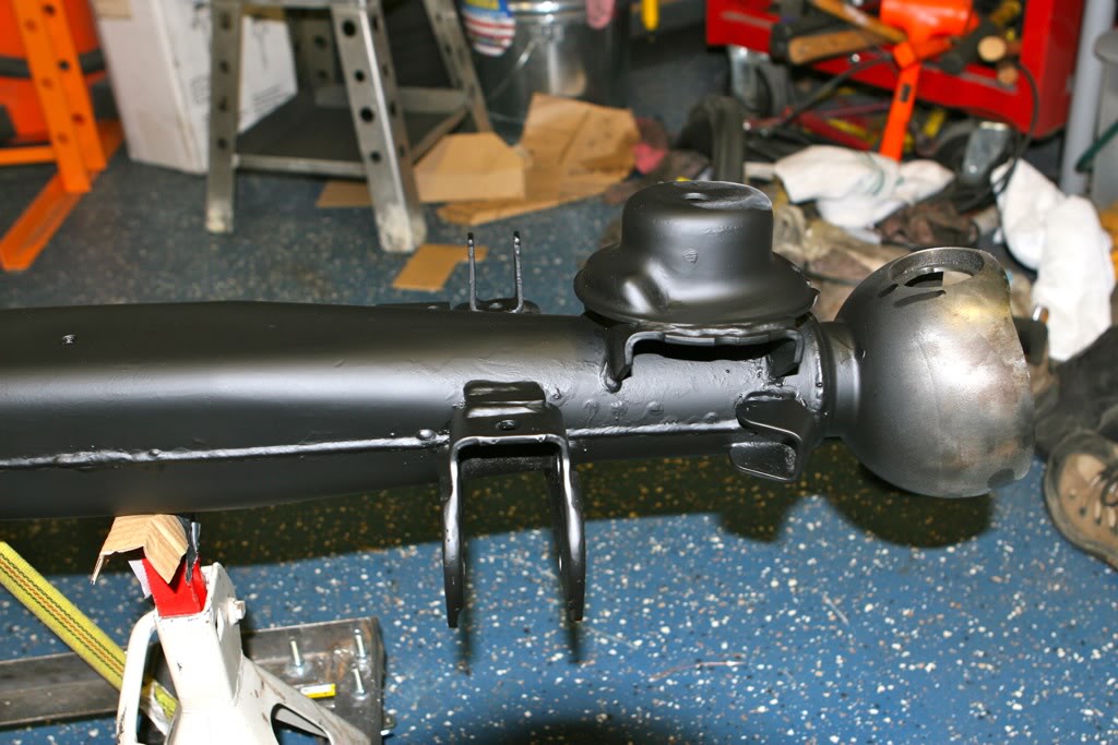

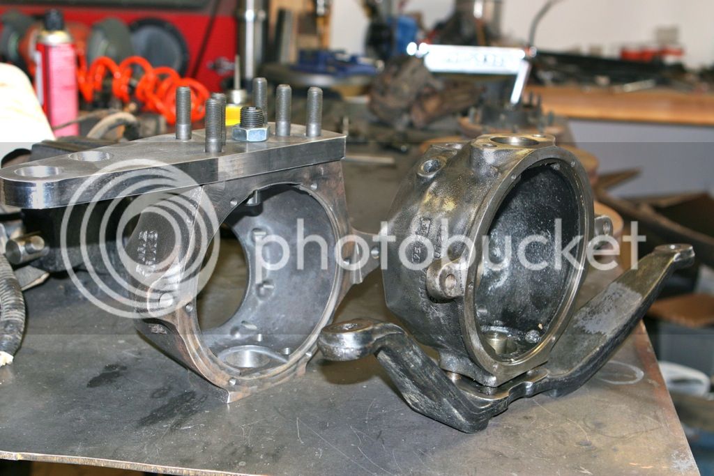

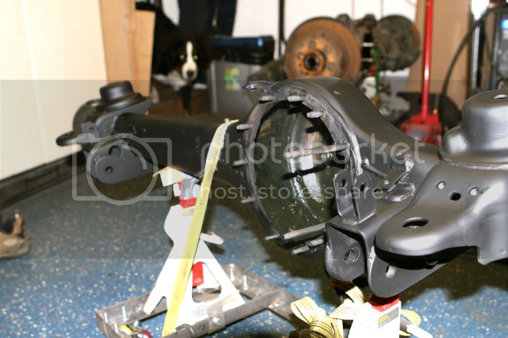

I have the front pretty much ready to put back together. Still need to clean up the inside of the axle housing, blow out any debris and flush to make sure its ready for all the fresh parts. Landtank brackets drilled and welded into place.
Pics of the progress...
Fresh coat of paint...

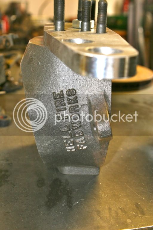

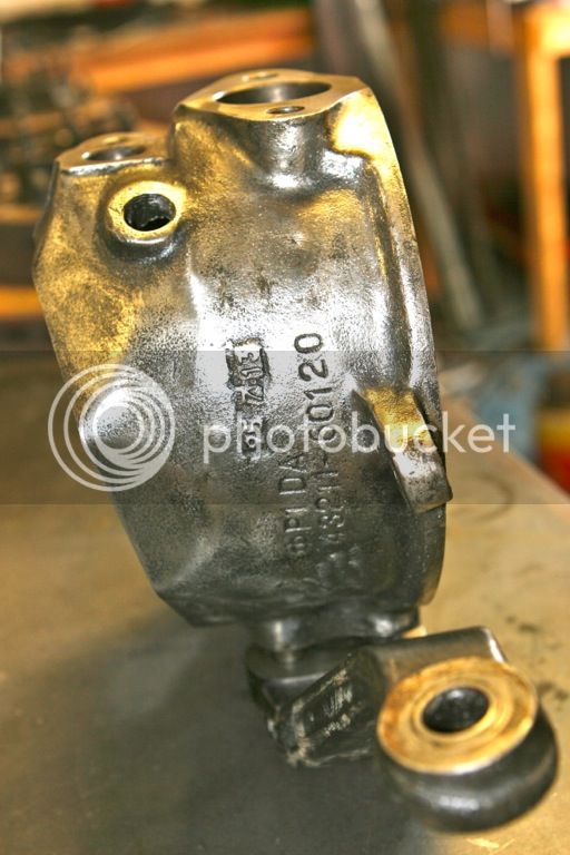

Knuckle choices, just pieced together for pics, which to choose from...
The pile of parts. These came with the axles when I bought them from Chris King who works at Toyota of Dallas. There were a few pieces I had to get from FA but it was very comprehensive...
The Hellfire knuckles are destined for the non-lockers that will be built with 4.88's and ARB's front and rear. But, that's for another thread down the road, hopefully...:beer:

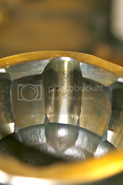

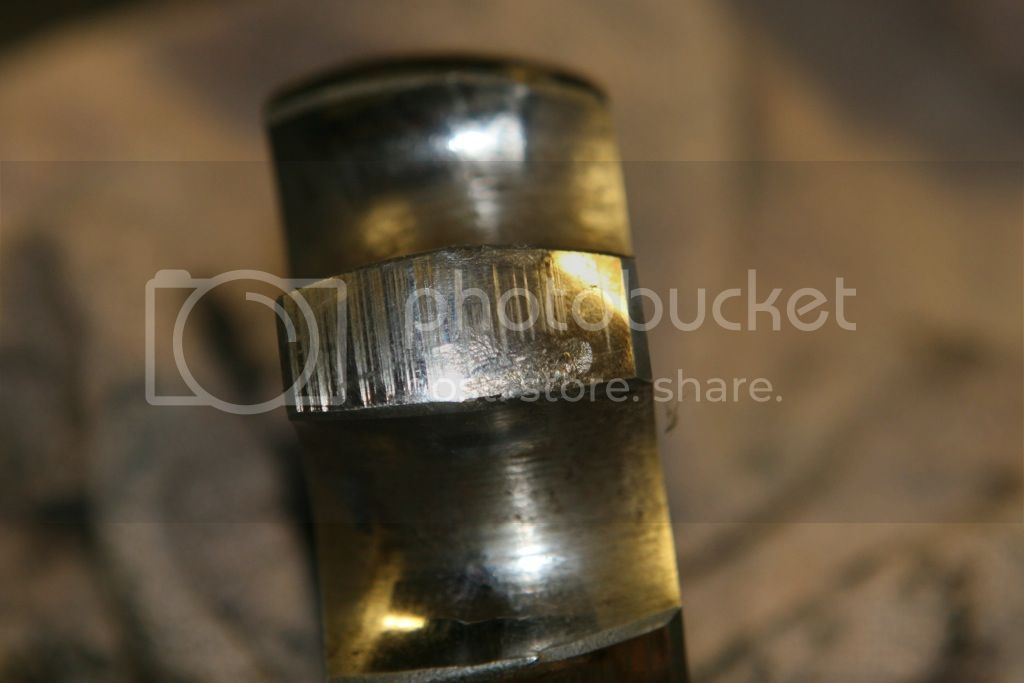

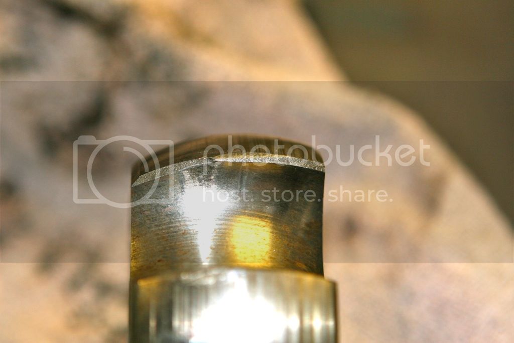

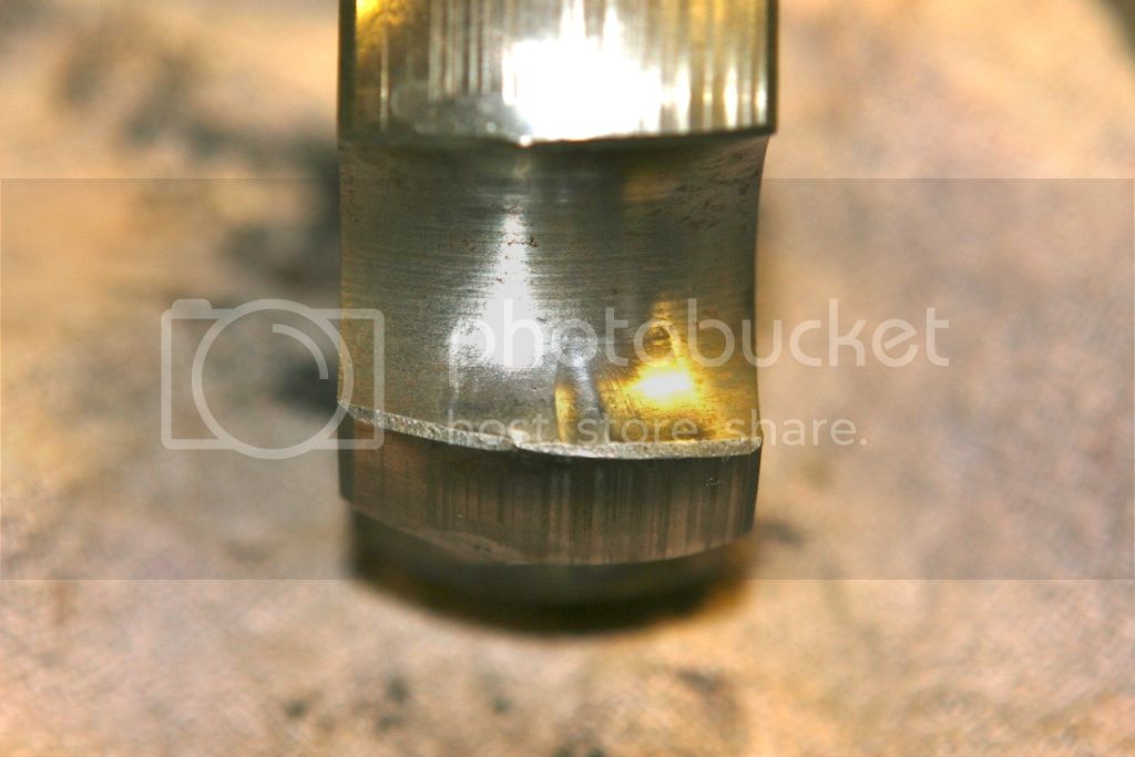

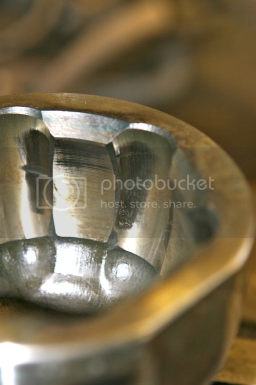

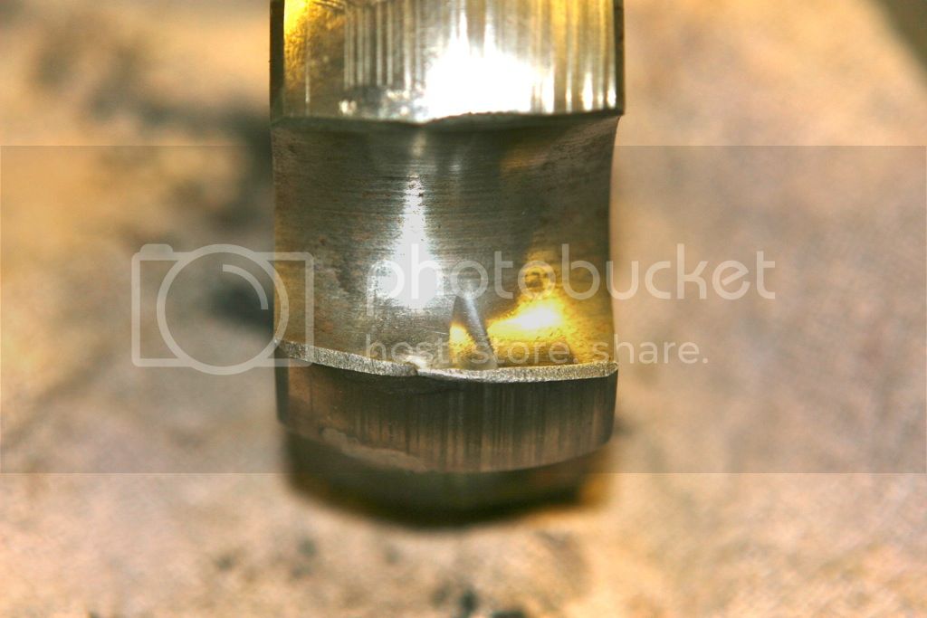

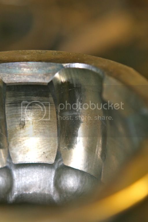

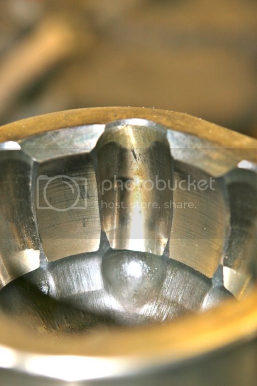

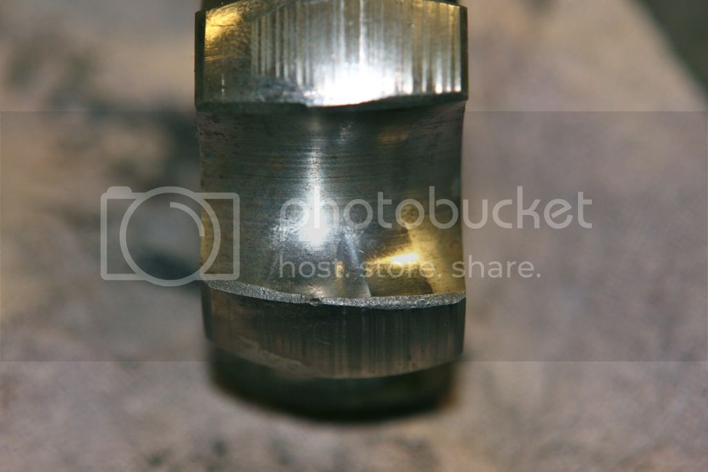

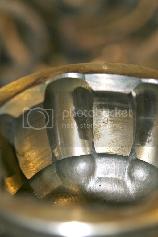

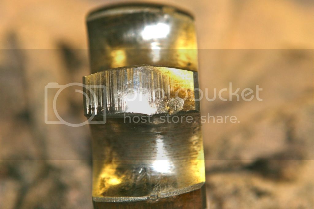

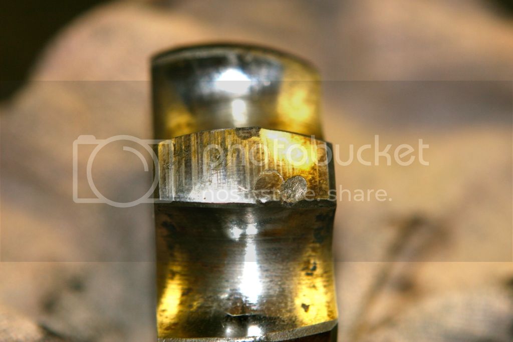

Being stupid and lazy, I saved the dirty job for this morning...cleaning and breaking down the birfs so I could switch them, getting more life out of them. Now, I'm not the sharpest tool in the shed, but I think I can see I have a problem, but you can tell me.
Pics of the pieces out of the "short" side...
Pics of the "long" side, or the good side...
From my inexperienced eye, I'm looking for a new set of birfs. It appears to me, beside the obvious, that they have already been swapped sides with the wear on both sides of the cup and both sides of the stars. Nice chunks missing out of the driver's side. Clearly, I should have spent the time to clean these up before now. I've had them soaking in solvent, thinking it would help make the clean up easier. Yet, if I'd known of this issue, I'd been able to get some replacements coming.
Oh well, now what to do. Go big with Longfields, try the Nitros or other aftermarkets or ???
hmmm hell fire fab knuckles :D:D
Go with longs, or used
Depends on which truck the birfs are going back into IMO. The longs are softer and will wear out much faster in a full-time 4wd driven on the street. The set pictured would be good for a set of trail spares, but if I had the means of picking up another set, I would.
Go with another set of stockers ( low mileage obviously ) or a set of stock replacement aftermarket birfs.
I agree with both of you. These are going on the 80, Brianna uses it as a DD to and from Green Hope (>2 miles) and will only be from mid-Feb to June. The future also holds a chance of a transfer case modification which will make it part time 4wd.
I considered Nitro's but the cost is virtually the same and I'd rather go with a known if I were to go CroMo.
After wading through all the threads, posts and such, from Bobby Long included, it appears that the change made to the Longfields put them toward the top for my choice. I'd rather opt for strength over longevity at this point, even though OEM is a close second. Assuming Bobby's predictions are close (half-life of OEM), that he can rebuild them for $80, Longfields it is. Of course, they are back-ordered, which is a good thing since I'd have to consider faster (expensive) shipping to get them here before Sat.
