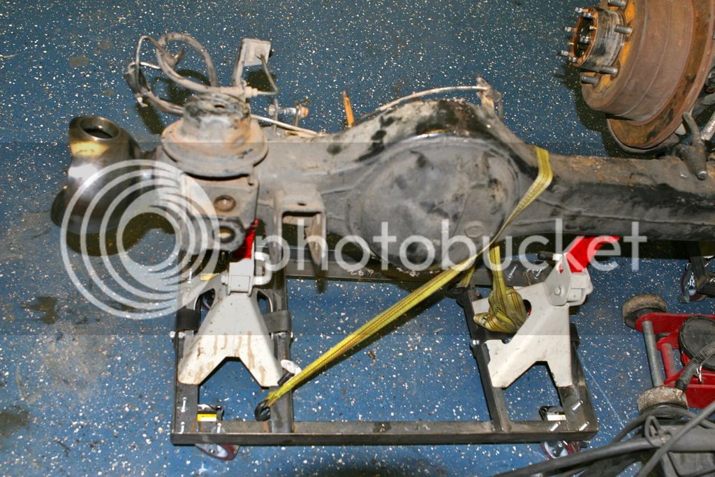

It took way longer than I had planned, but I have both 3rds out and ready to have re-geared. It took longer because I thought I was being smart, making some "rolling axle stands" as seen on one of the shows on Spike TV. Well, their idea sucked so I went with plan B, using some small jackstands I had.
That sucked also since there were too many moving parts, not stable enough such that when I tried to pull the 3rd on the rear axle, it all came crashing down, onto the drain pan, making a HUGE mess. Stupidly thinking I had it figured out, same thing happened with the front. So, I had to come up with something reasonable.

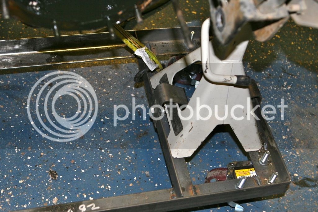

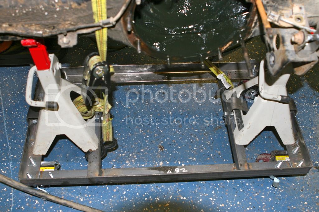

I bent some steel to make a kind of clamp to hold the jackstands to the frame, then using a small ratchet strap to hold the axle down on the jackstands. This works well. Now, I can roll the axle into the work space and tuck the other out of the way.

The rolling axle stand...
The mickey moused clamping system...
Tucked away for the night...

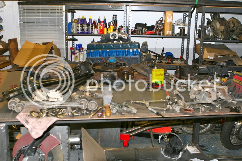

The mess/mass of parts, screws, bolts, axles, birfs, rotors, calipers, knuckles and just stuff...
