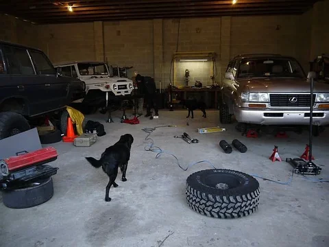

Photos from the weekend
Here's the pics...I realized my picture taking ability drops as I consume beer..(notice the blurry night time pic:D)
Ill upload the video tomorrow, but I dont think I caught too much...we shall see!
