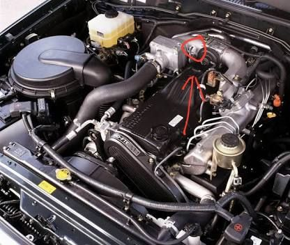

Check the small black hose going to the MAP filter and MAP sensor at back of manifold. Make sure the filter isn't cracked either
