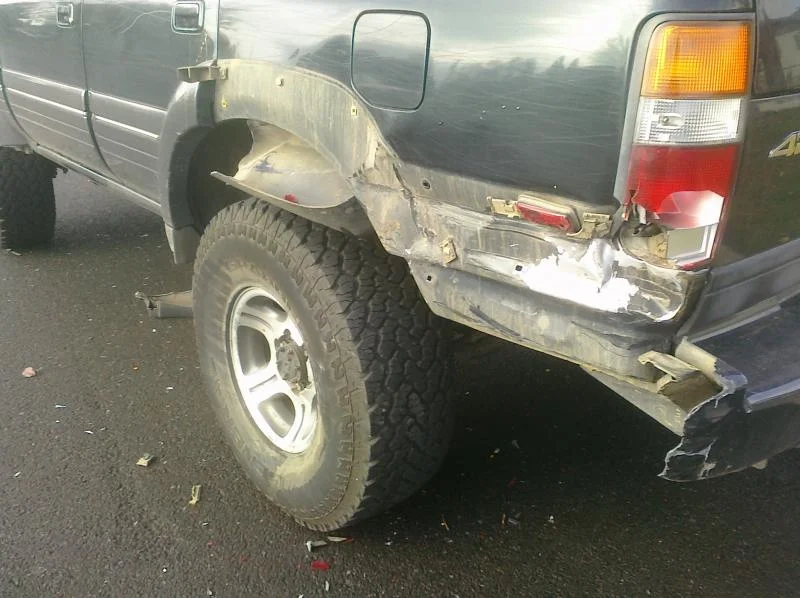

Damage done:
  • Rear quarter panel and body cladding (obviously).
  • Rear cross member is tweaked pretty good. Looks like the frame horns are still in good shape.
  • Rear tire and rim is fairly scuffed up. Tire sidewall is scrapped pretty bad. Frankly I'm a bit surprised I don't have a flat.
  • Front tire (but not the rim) is a bit scuffed up. It looks like she hit the rear quarter panel, bounced past the doors (:eek:) and then tagged the front tire.
  • Small scuff mark on the front bumper corner where she barely scraped it.
  • Steering wheel is cocked over about 15* to drivers side. (Drives straight and true, nothing obviously bent in the front end.)
  • Idle is low, about 400 RPM (AC on/off doesn't seem to matter). :confused:
Anyone got any ideas on the last two? The last one especially seems odd, but this is something that occurred only after I fired it up today. Any other places to check for damage?

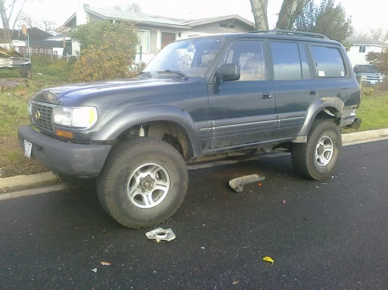

And so now for what you all really want, pictures of the damage. Buncha jerks. :D

One of my buddies here in town with a JDM was rear-ended last winter in a similar manner. The local Toyota body shop wanted to replace the whole rear quarter and D-pillar panel, plus all the other necessary parts. He ended up getting it fixed somewhere else (with less work involved) and managed to get a Kaymar bumper out of the deal.
Low idle: maybe one of the hoses on the filler neck came off and is causing it?
Steering: check the pitman arm and the sector shaft closely. They have been known to get bent with an impact on one of the front tires. Your tie rod ends, drag link and tie rod might also be tweaked.
Good luck getting it all fixed up!

damage doesnt look to bad. mostly cladding & plastic bits that can be replaced. hopefully they wont have to do significant body work, except maybe pull the one dent by the gas cap (or is that just funky reflections?). that might mean a respray, and having 3/4 pinstriped body and 1/4 fresh paint sucks.

Looks like you live right next to a school. So not only do you have regular traffic but you get every stressed out brainless stay at home mom and or stressed out work aholic mom for each of those kids driving by your car at least twice a day. Odds are high with you getting taken out.
Doesn't look to bad though. Depending on what you do with the truck hopefully it gets totaled you can fix it yourself (bodywork isn't rocket science) make it a dedicated off-road vehicle and get yourself another rig. But really it doesnt' look all that bad. I think you are going to be fine.
