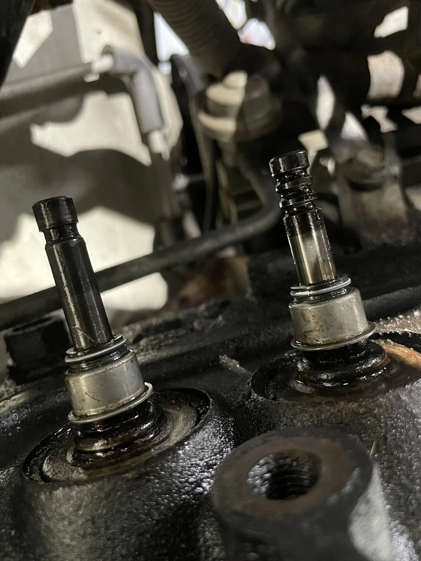

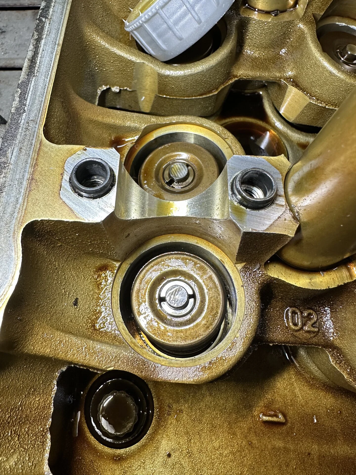

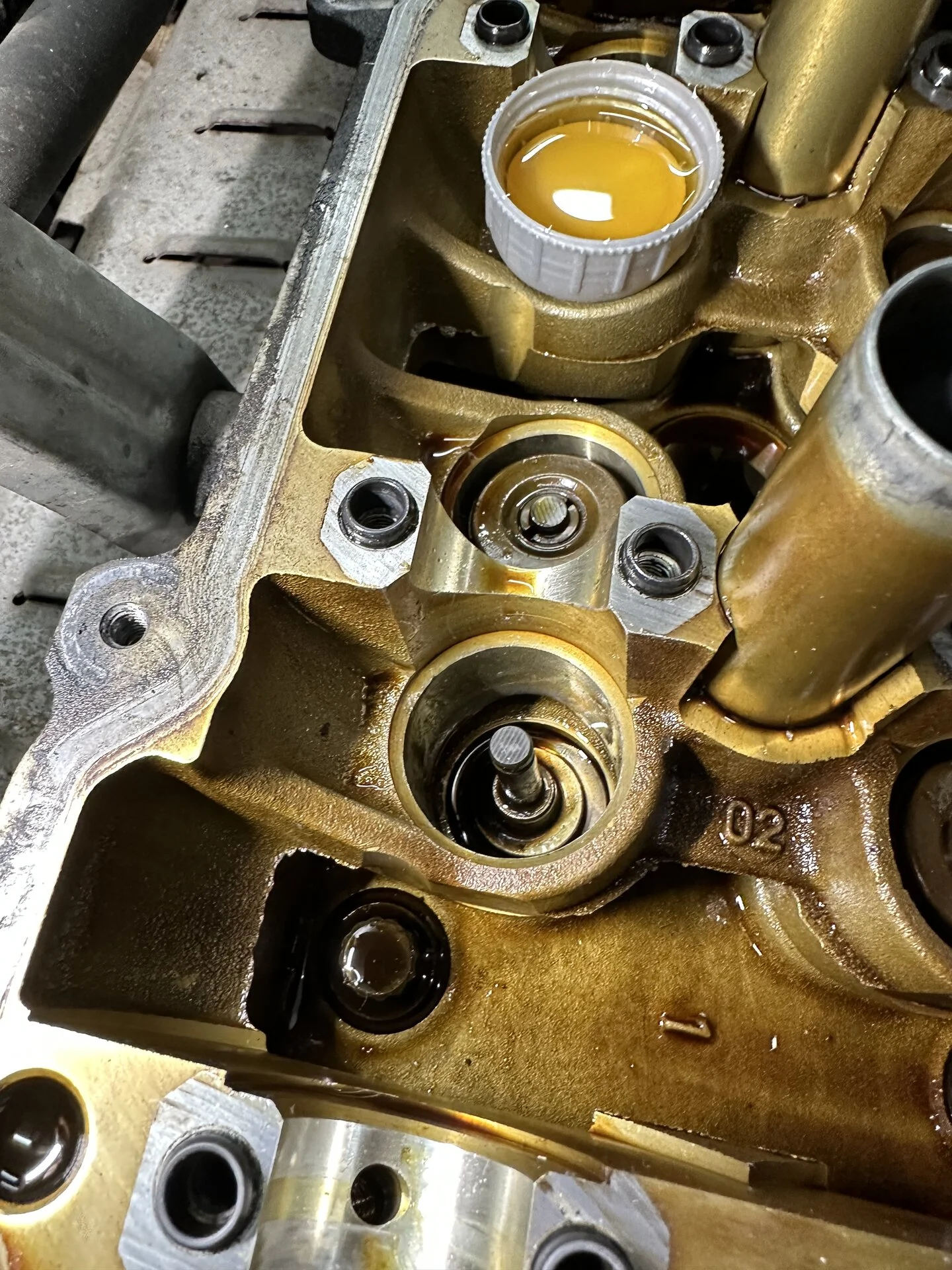

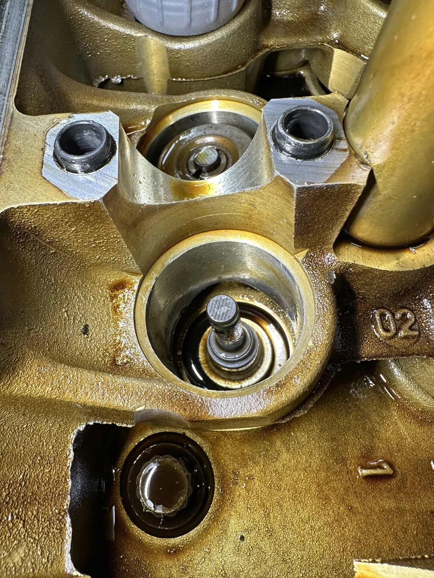

Got around to putting some of the oil seals on. Overall, not that bad. Was lucky my harbor freight compressor works after sitting for 8-9 years.
Of course i had the exact quantity of oil seals and I broke the first intake one. It just felt like it wasn’t seating all the way, so I’ve pushed it further down and it split.
The exhaust seals look like they’re pretty much sitting all the way down, do I press them flush with the housing?
For the intake seals, there definitely feels like a gap from the bottom to the seal, is that right?

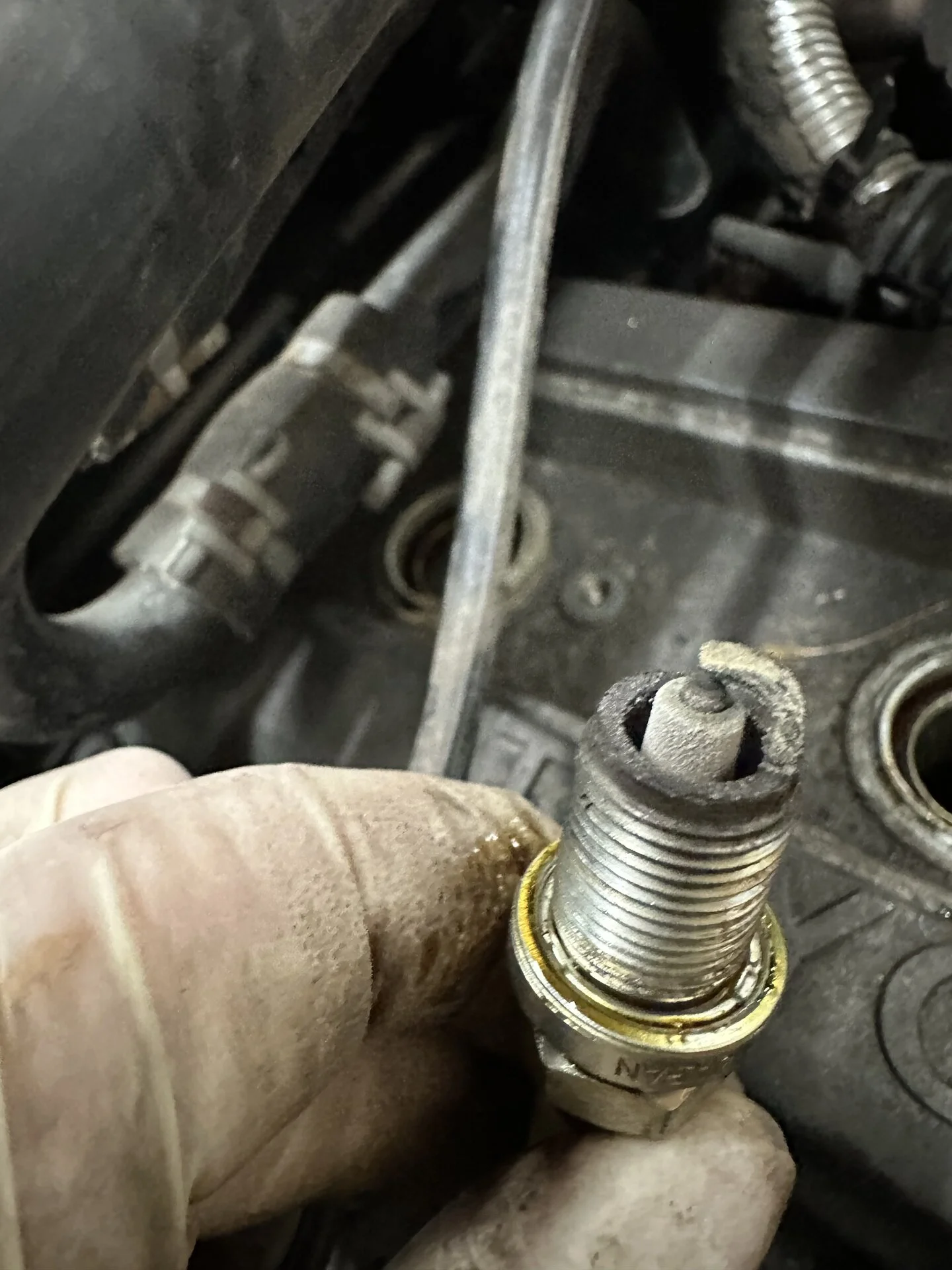

@BILT4ME Curious what you think about these plugs
Well, since there are no immediate reference positions for these other than order of photos in the previous posts, I'll go from there.
Pic 1, 2, 3, 5: Burning oil. Plug gap is way too wide Worn out. The gray ash buildup on the plug is what gives the reference along with a black residue near where the threads and electrode are.
Pic 4: Oil fouled or it was dropped in the oil after it was removed or the plug tube seals had failed and when it was pulled, it got soaked in oil. It is still a wide gap and it looks to have been burning oil due to the ash volume remaining on the plug. Also worn out.
So, all in, I would say across the board your engine is burning oil. Where is it coming from? Rings or valve seals? This is where the compression and leak down test will reveal.
Having a significant vacuum leak (such as failed tube seals) will also increase oil consumption because it allows air into the engine that is then sucked up by the PCV and sucked into the intake. Get all your vacuum leaks fixed and your oil consumption should decrease.
Replace your valve seals and your oil consumption should decrease.
Replace your VC gasket and your oil consumption should decrease.

I just did the valve stems seals on a 3FE. Engine in car, head on was not too fun with work space and the springs were ridiculously stout. Regardless got it done and no more burning oil. Idk about your situation, but the valve stem seals for the 3FE do not sit all the way down. I was confused of this and thought it to be wrong but was not. I have some valve stem seals left over if you want them. Might not fit though. They do look like what you pictured.
Oh wow didn’t see you already did this. Thought the thread was only one page. My bad
Yes, the seals do not sit all the way down. I was confused by this as well and ruined 2-3 seals. All it takes is to hear a click and feel it go over.
