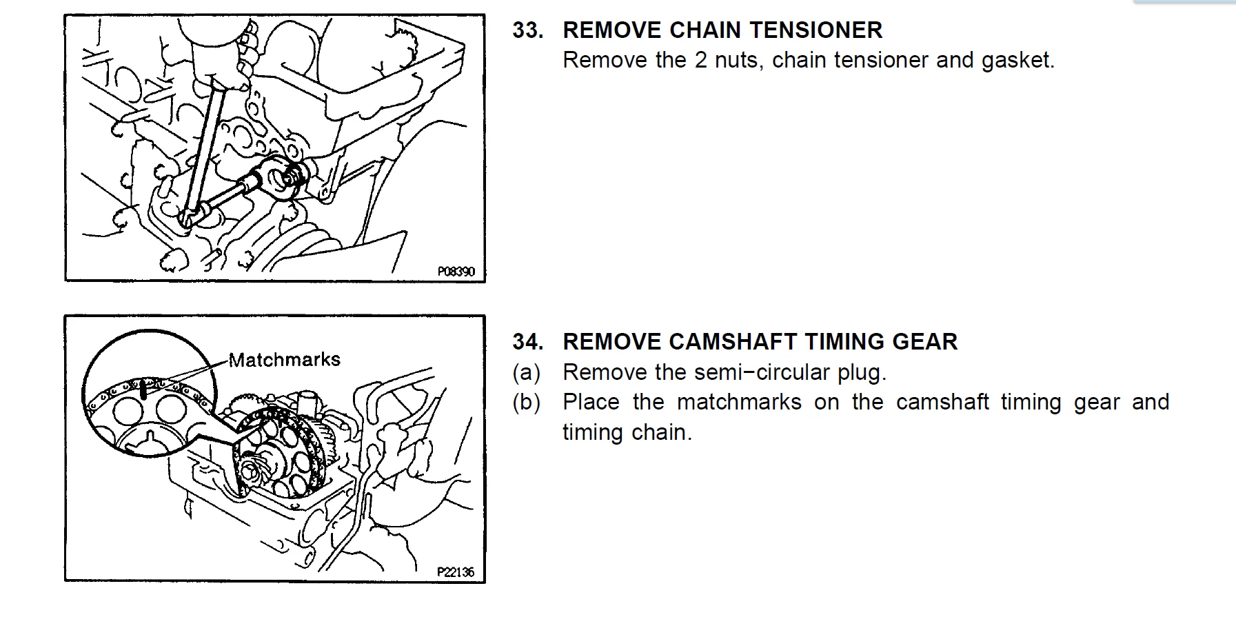

Typo, I meant the chain& its guides and the sprocket (all are cheap).
For the timing chain & cover it’s a lot easier if I was to pull the head and install the gasket.

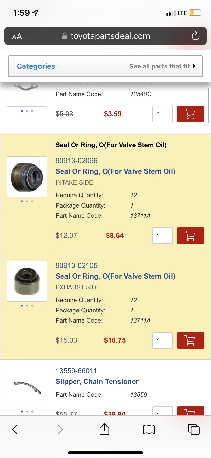

I pulled my engine and had it rebuilt primarily due to valve seals. My oil consumption was roughtly 1qt every 3K miles for several year however it had started to increase over the past year and a half. Right before pulling the engine, it was 1qt every 1K miles. On top of that I had a valve cover gasket leak, spark plug seal leak, lower oil pan leak, upper oil pan leak, rear main leak, and 275K miles on the original headgasket. I plan to keep the truck till I die and figured it was time.
I purchased the LCE master rebuild kit but replaced a few of the items in the kit with OEM parts (seals and any rubber bits). I brought home my original pistons and was surprised at the layer of cooked oil on top of each piston from the leaking valve seals.
Total cost was about $3000 with the rebuild kit, labor, and parts but I wouldn't hesitate to go this route again.

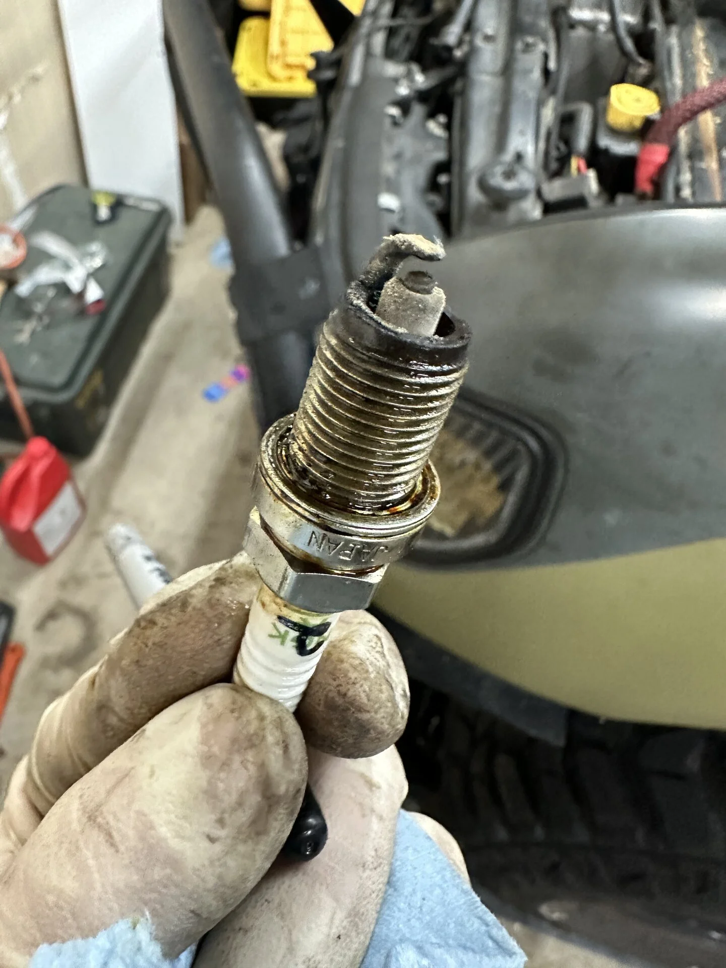

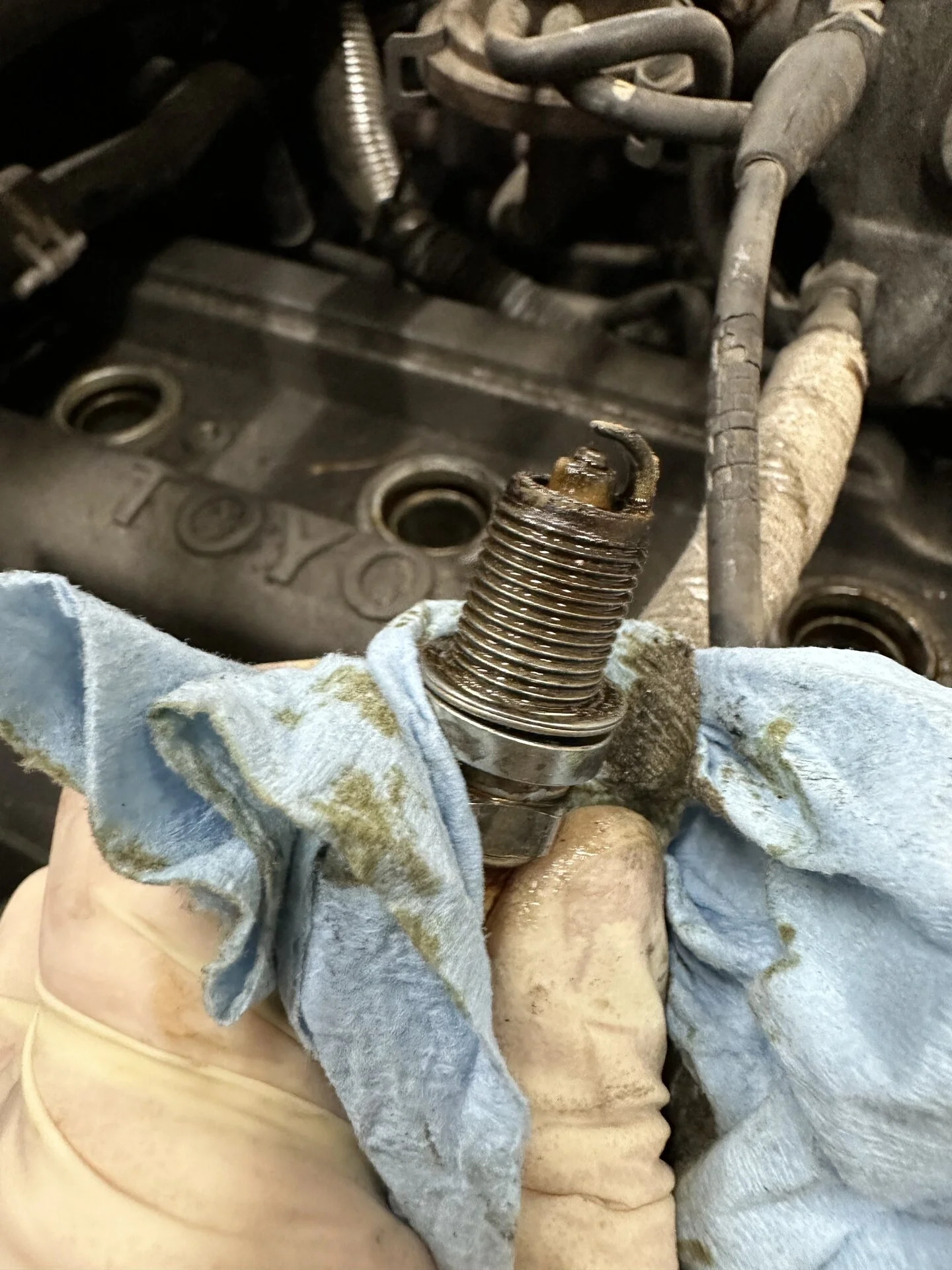

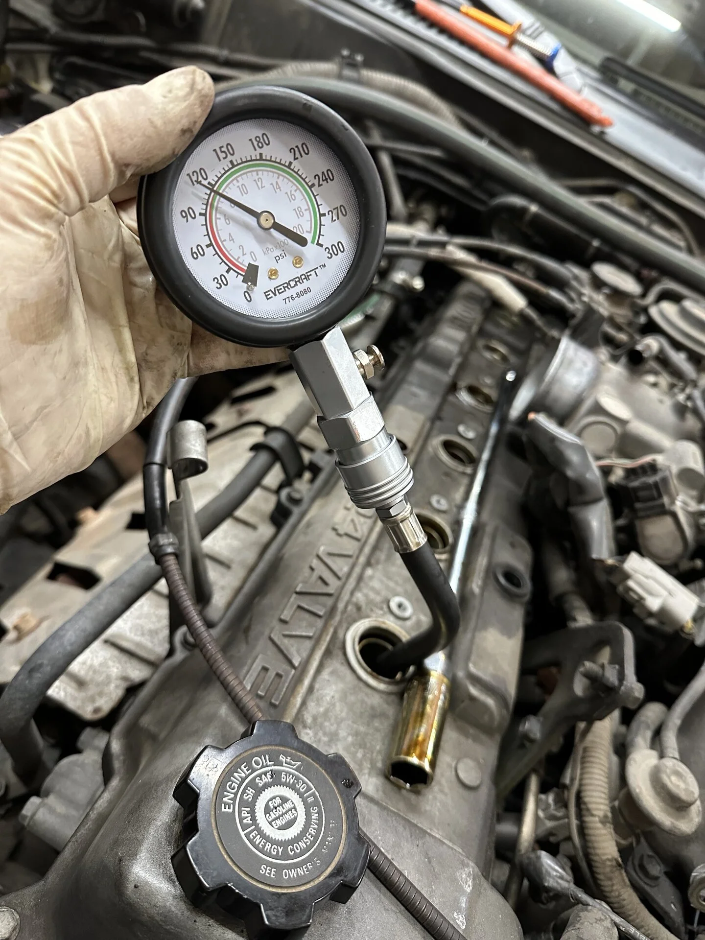

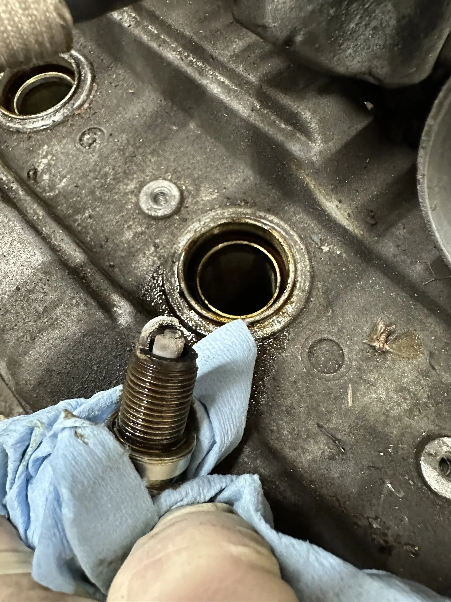

Got around to pulling the plugs today, 4/6 are in a pool of oil. Plugs look like the might be burning oil as well, maybe you guys can tell me. I’ve attempted to do a compression check but it didn’t work out. The gauge wouldn’t hold pressure, and i was getting all sort of wierd readings on a cold engine. I felt like it couldn’t have been in accurate as some cylinders got a little bit of oil when i pulled those plugs. Cylinder 1 and 6 were reading 150 and 120. I’ll try to retest tomorrow.
I have a video but on a few it would hit 180 and go back down to 0. I’ll see what’s up with the gauge tomorrow. It’s a rental from NAPA.
If you have oil in the cylinders there is no point in a compression test; it won't be accurate. Adding oil into a leaking cylinder is the test for leaking valve seals versus leaking piston rings.
