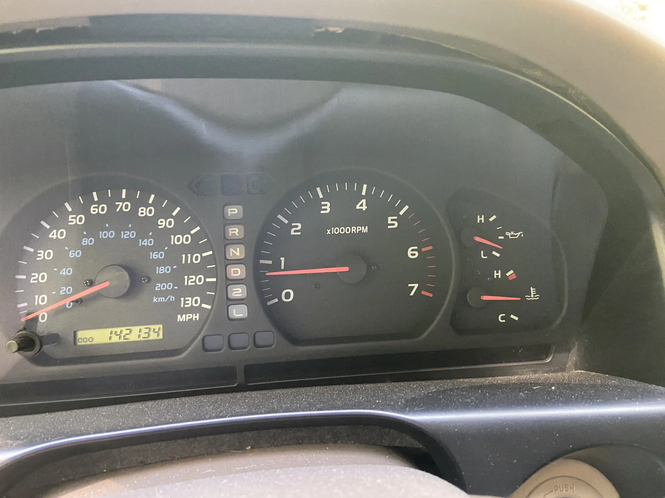

This is at idle, after a 30 minute highway drive, 86F outside. At 25-30mph, the needle sits just below halfway. At highway speed, just above halfway.
Does that seem right?
Yours reads higher than mine at startup

To the OP, my dash is also right at that line at idle
lots of threads on this, I had a situation where mine went FULL max on my 02 with 276K when driving around, and then after I pulled the single wire on the sending unit it went to almost nothing. I replaced the sending unit, and it acts like it has lost its mind. Startup max above the top bar, then slowly comes down as engine warms up. After warm at idle it sits at the bottom hash.. when driving it moves around. Going for a m1-209 filter this oil change and I might just put an actual gauge on there at some point if it keeps this up just for peace of mind. I think it's good that it is moving. Sender is a :banana: job, you'll lose about 1/4 a cup of oil.

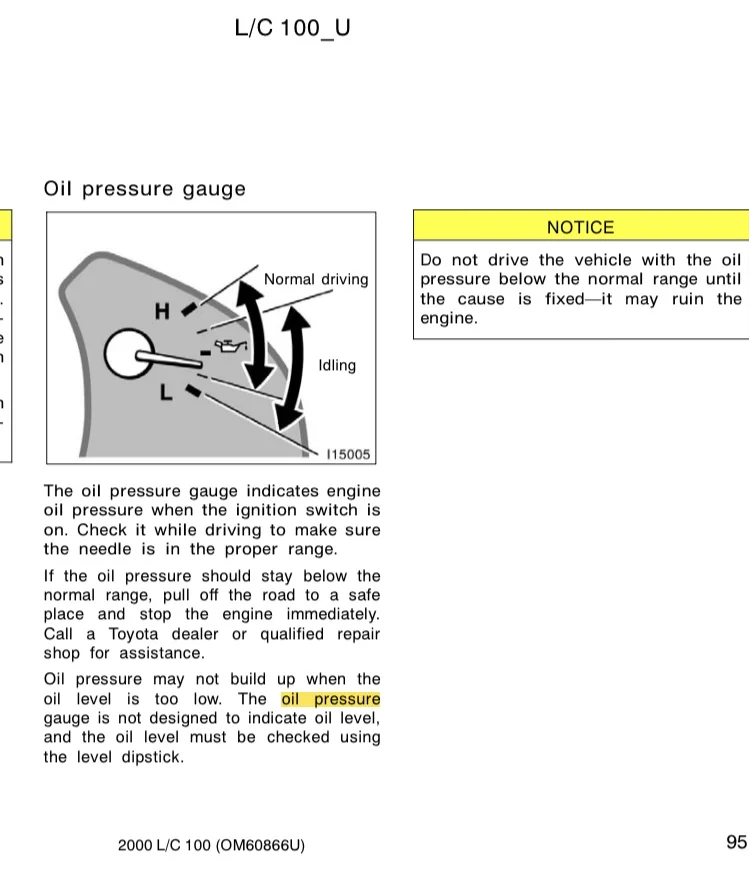

So my guage reading below the tick mark when warm at idle = 15PSI on a harbor freight mechanical oil testing unit.
