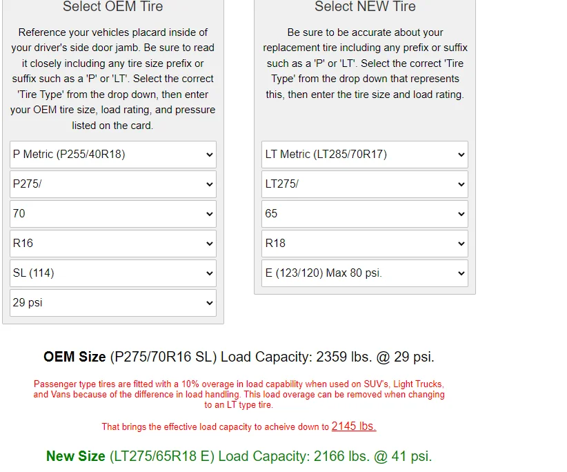

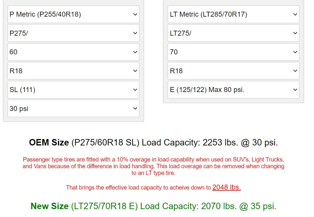

Is below correct for 2006-07 LC from stock to BFG KO2 LT275/70R18?
No, look at the numbers that is converting to a 17 inch tire . Then again the bottom shows the right info , idk , click link below and just make sure your entering the proper info from the p or sl rates to the e rated
Click link below and enter your stats to get some info
>Tire Pressure Calculator - Tire Pressure Calculator - https://tiresize.com/pressure-calculator/
Hi Mike, thanks for the helpful info. I think the "LT285/70R17" in the first line on the right side is just a default example of the tire size format. The lines below are what I specifically selected.
