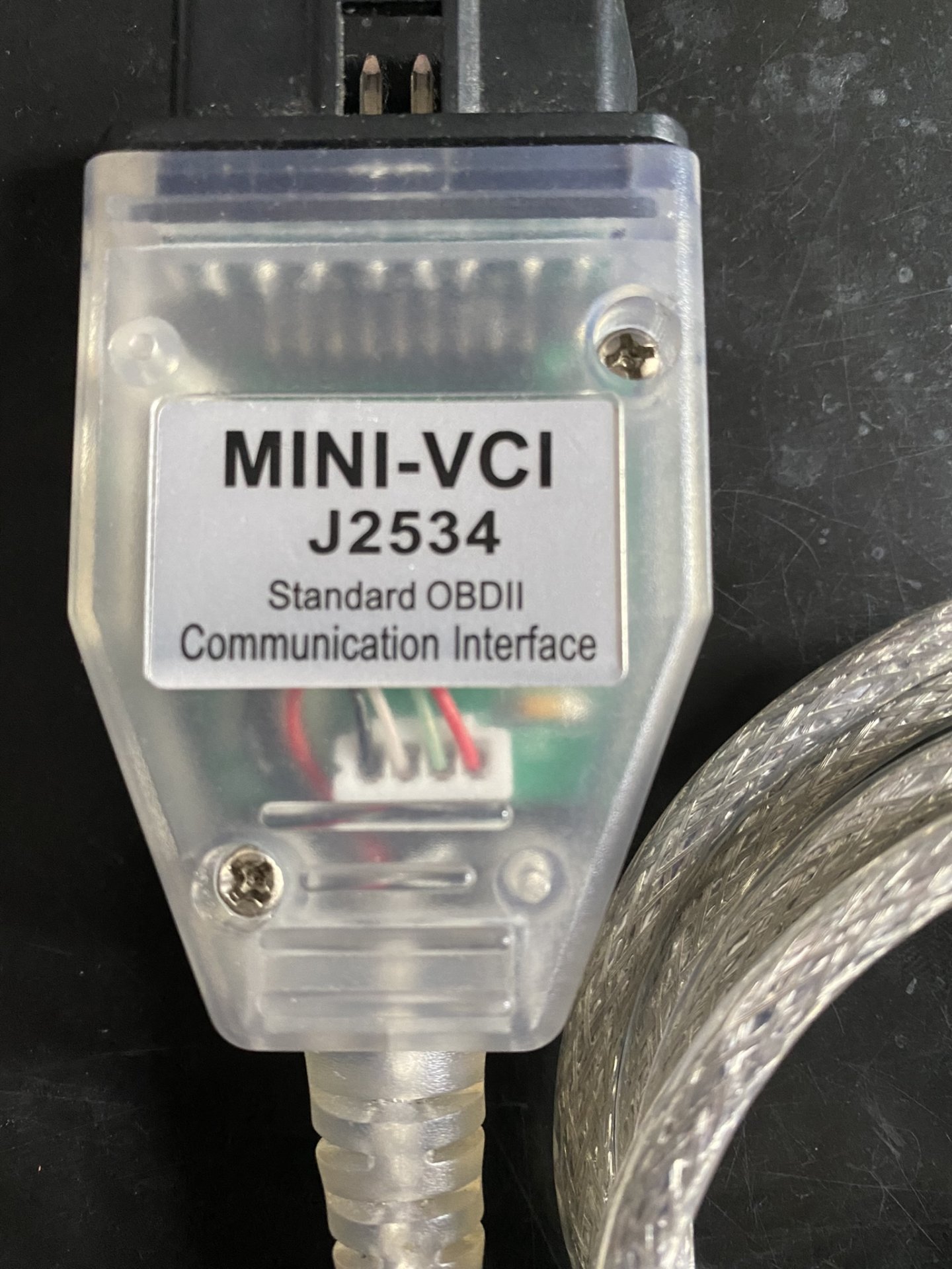

I'm have issues with Techstream 12.20.024, getting into all data in a 200 series (2011LC currently).
I use it very often in 100 series, without any issues.
Anyone know what it may be. Is there a newer version of TS, that I must have for the 200 series?
What cable are you using?
I bought is as a V2 as at the time it was what was recommended in mud.
Does it look like the one I should be using?

Seems like that cable should be fine, but considering source and nature of these cables, who knows?
Do you see other engine data in the "data list" properly? If you get nothing when you connect to "Engine and ECT", then it may be your cable. AHC is a different "bus", so the fact that it can read AHC data and not Engine data is possible.

I couldn’t get that cable to work for TPMS or live engine data, but it would work for resetting codes and some other functions. All finally started going right when I got a VCX nano or whatever they are called.
Edit: everyone here that I’ve seen go for the VCX nano finally got everything working.
Mongoose is the "authentic counterfeit" Techstream cable. Then the ones we buy for $50 or so are copies of copies of copies. They all look the same, but quality varies widely. I bought on Amazon, not eBay, and looked for an item with a lot of positive reviews and it ended up working fine (this was five years ago so I doubt the seller info would be of any use now). If you want to be really sure of getting a good cable, get the real Mongoose from Drew Technologies. $500, but still a lot cheaper than real Techstream.

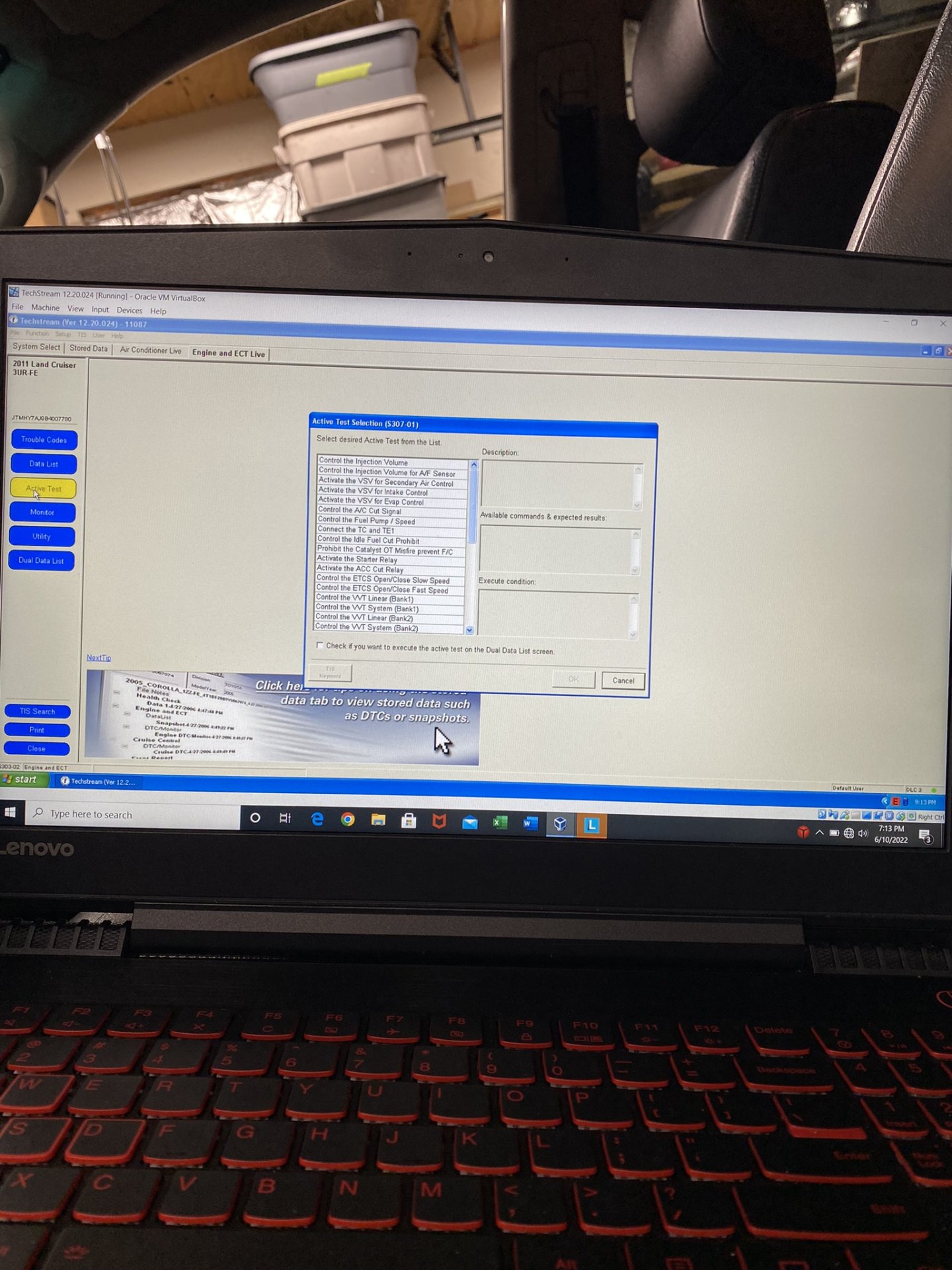

I hook into tech stream again yesterday, in a 2011LC. Checking what other info in engine and ECT date I could read if any. I see all! I also opened a few other windows. All I did check, open and display data. Engine was not running.
Engine & ECT live, DATA: Fatal Error code 0xC0040001
Other screen in engine & ECT no problem bring up, also copen some of the other area in tech stream. No issue in any.
Am I the first to have issue in just engine data of 200 series, with miniVCI running TechStream 12.20.024 or any version?
As stated above: I used this miniVCI, mostly running through Oralce VM Virtual Box, on XP 64 bit on a daily basis for years in the 98-07 LC & LX. I've also used on 200 series from 08-16, less frequently. It's worked for everything except engine data of 200 series.
