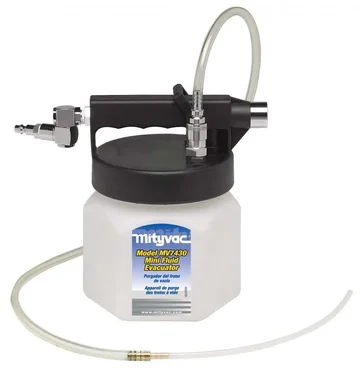

I have Mitivac like this
http://www.mityvac.com/hq_images/MV7430.jpg
and find it usefull for flushes but for whatever reason it will not evacuate all air from the system like one must do when replacing a caliper, MC, brake line, etc. In this instance I revert back to the 2 person method.
