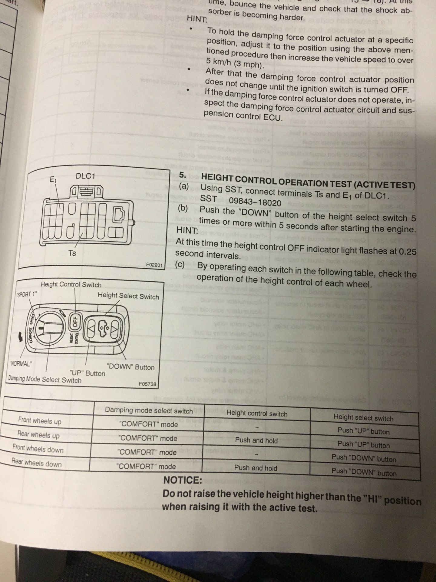

If you're not confident in trying to remove the busted bleeder (it's the port on the front, the other is a blind, plugged port and isn't used) then I'd recommend just driving the vehicle down on to the front and rear bump stops using the active test. This will push as much fluid as possible back into the reservoir from the 4 actuator shocks and the height accumulator. Then you can either siphon the old fluid out and replace with fresh, or at the least you will facilitate any entrained air in the fluid to be released and bubble off (like opening a can of soda) when it hits the relative low pressure reservoir. I wouldn't mess around with trying to loosen any hydraulics lines on the height accumulator as in all likelihood you'll just bust a union and go from an ok situation to a bad situation.

Thank you @PADDO for all ur help ,,,
So basically u r suggesting doing a 2nd flush after I bled all 4 corners,,
I dont think I want to dump more money into this system, I think my conclusion is that it is dying and not worth more investment ,,, better put money on replacing it ,,,
With regards to circulating fluid and getting air out,,,, I mentioned I lowered and raised it over 30 times after the flush ,,, the reservoir was FULL when the LX was down to the bump stops, then slowly decreased, now when I put in LOW, the reservoir is full up to the lower half of the container, so this tells me there was as much air in the system as the upper half of the container ,,, correct?
