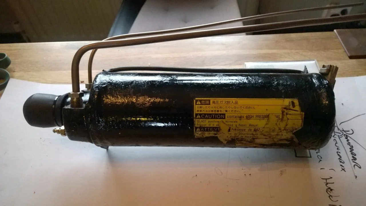

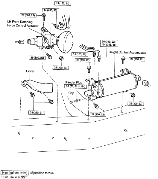

Yeah, AHC fluid shouldn't be black or brown. Did you have any "froth" aka bubbles in the fluid that was bled? If not, you are very lucky. If so, that is usually a sign that the nitrogen in the globes is nearing the end of it's life and need replacing.
The big cylinder is the accumulator and needs to be bled as well. First pic is of the entire assembly. The bleed valve is not covered by the big plastic cap. In the second photo of the actual height accumulator, you'll notice the bleed as the brass colored valve in the lower left.

Yes, I saw the diagram and the video u attached, thank you, but mine just does not have that bleeding valve!
It only has the dome shaped plastic in the front, and electric wire from the back,

It's very unlikely that any air of significance entered the system. I suspect your height accumulator bleeder may have been broken off, post up a close up photo of the front of the height accumulator. The bleeder port should be located adjacent to the solenoid (aka thingy covered with big plastic cap). Did you follow the bleeding procedure and let the vehicle drop to the bump stops so it can expel as much fluid as possible?
The bleeder port is not broken off, it is just not there,,
Scrape off the mud and any anti rust coating or whatever on the front face and you'll find where the bleeder should be. I can see what appears like a "patch" over the bleed port.
