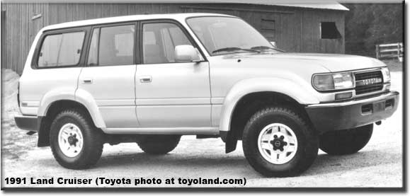

If they came on the '84 and '85 Mini's & 4rnnr's, as I recall them doing, then at least those would have the correct backspacing since LA Mini's & 60's share the same general outer front parts. I don't know if the IFS Mini stuff continued to use the same offset wheel or not. I think so, but I can't state it for sure.
I saw an FJ 80 running a set of these that had been painted black and was wondering if the would fit on a 60 without spacers? I tried searching but nothing came up, I think they are off of the 1985 - early 90 Trucks and Forerunners.
Just installed a set on my 84 60 about 3 weeks ago, and I had to use spacers on the front wheels - completely locked up on the tie-rods. I used 1.5" spacers (got cheap off of CL) but you might be able to get away with 1". The rear wheels bolt right up, no problems. I'll see if I can snap a picture tonight. It was also a jump up to 31" tires, so I now have to fix "saggy 60" in the back, so I have the same clearance and appearance I had with the standard 275/15 stock tires.
Have yet to black them out, but its on the list of things to do.
