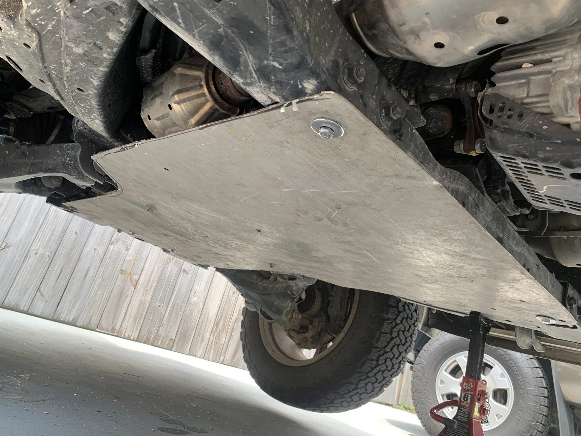

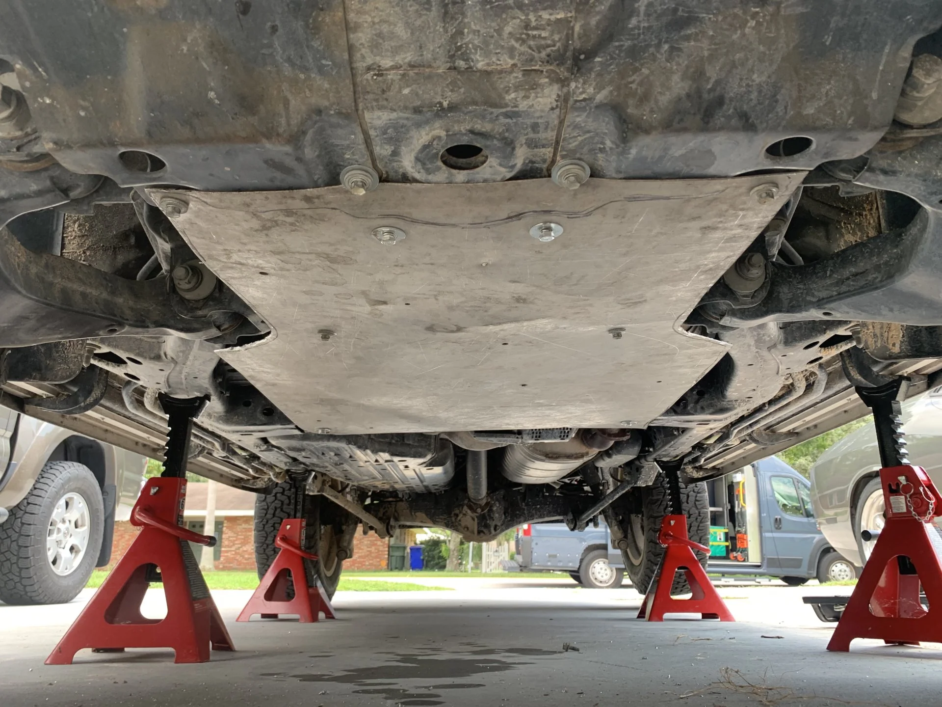

Attached are photos of the homemade skid I made out of a construction road sign to replace the plastic engine skid (first pic) which extends to cover the transmission/cats (second pic).
Road sign skid is bad a$$. Well done HighFructose.

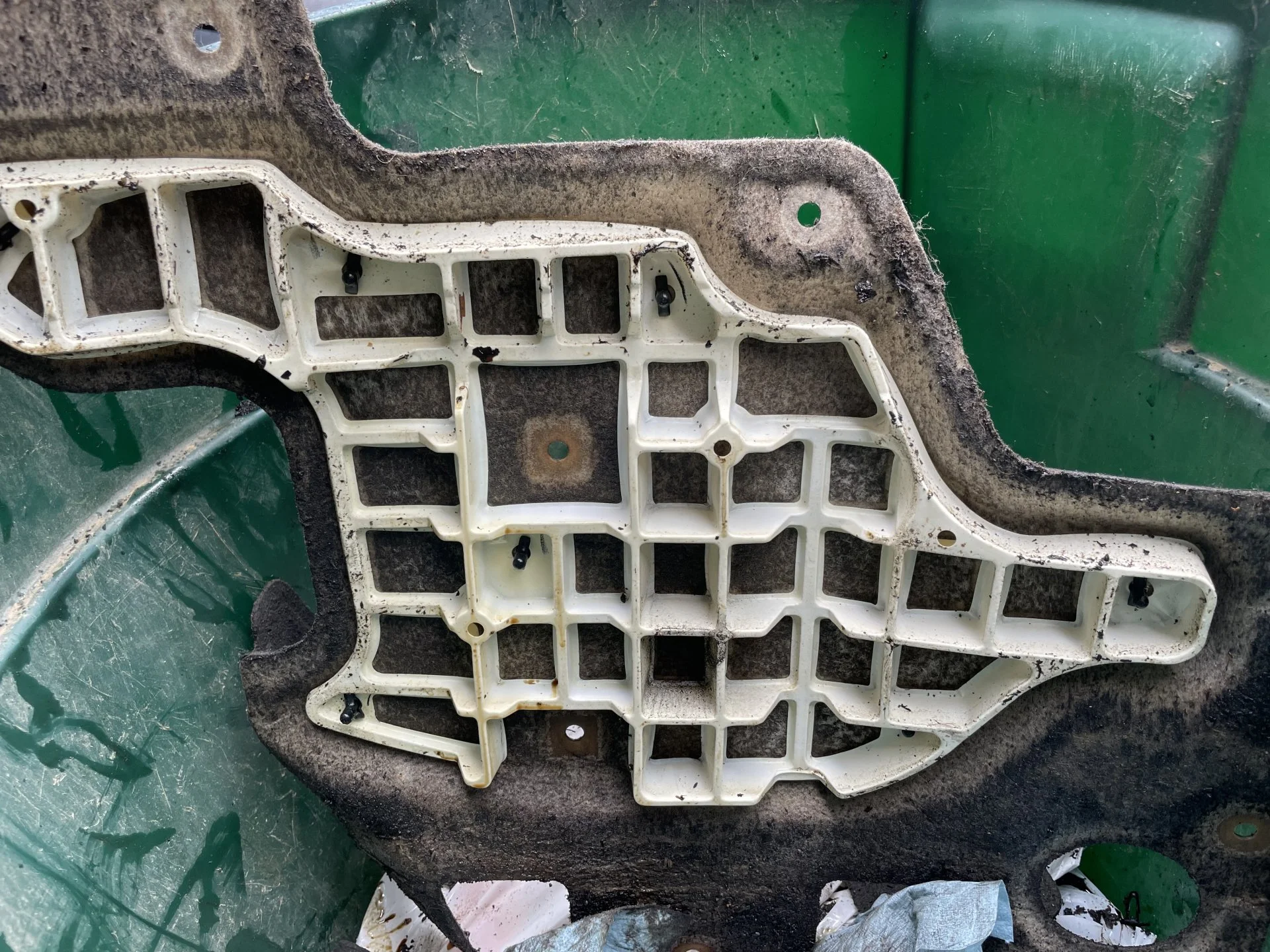

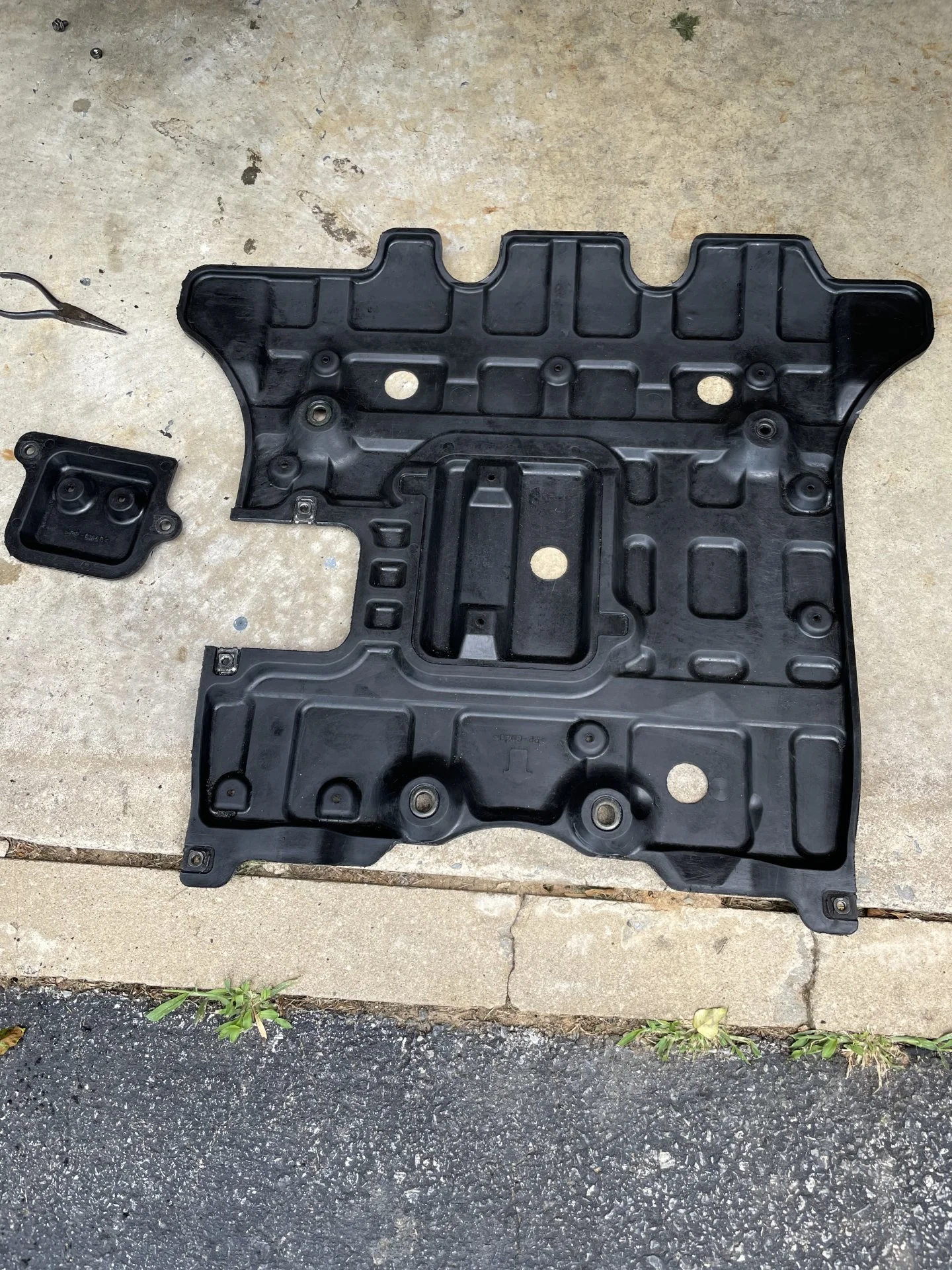

Today I pulled the skids from my newly acquired 08 LX 570. First pic is after I cleaned 14 years worth of oil and grime. Second pic is some darn fabric filter insulation stuff that was laden with about a quart of old motor oil. Does that thing serve any purpose other than to collect used oil when doing an oil change and not removing the skid?
