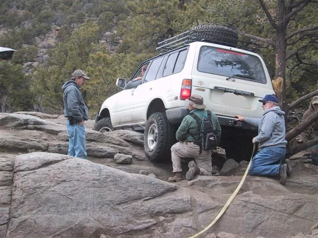

When I can manage to actually get out on the trail, I play in the relatively big rocks with a minimized lift for my tire size. I have the Slee skid and have high centered on it back when I had OME. I haven't found any need to have more coverage or strength, so for a very moderate rig, it is plenty.
What is often lost in these armor to the hilt discussions is weight, which is not your friend, and more coverage often means less clearance, which is also not your friend. I'm not saying anything bad about the IPOR skid - I simply want as little heavy gauge metal on my 80 as possible to provide reasonable protection, because this thing is a pig out of the box.
It is easy to add a thousand lbs to an 80 and end up with a rig that is over 3 tons with gear. Keep it light whenever you don't need all the extra coverage. Once you have Slee's skid, the real at risk component is the rear driveshaft. Mine is wonderfully candy caned yet still vibe free :D
Sitting on the skid waiting for extraction on OME medium and 33's.

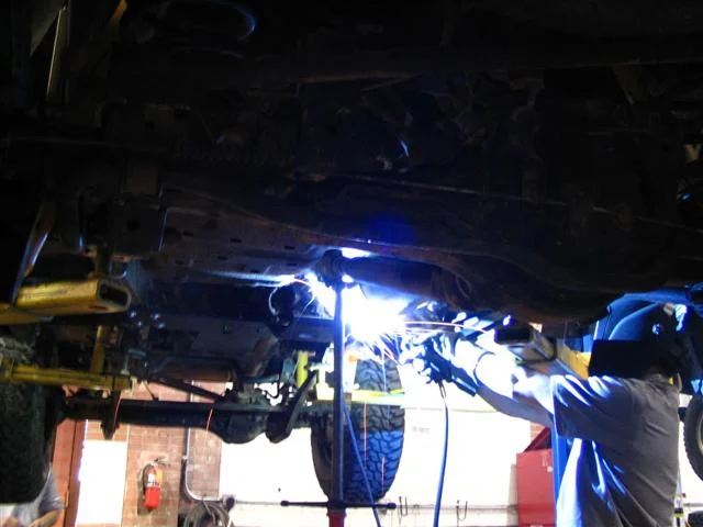

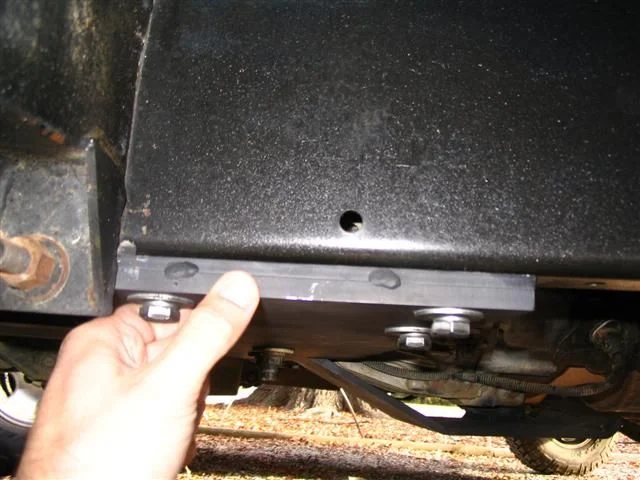

here is a shot of my rig at IPOR getting the skid installed.
