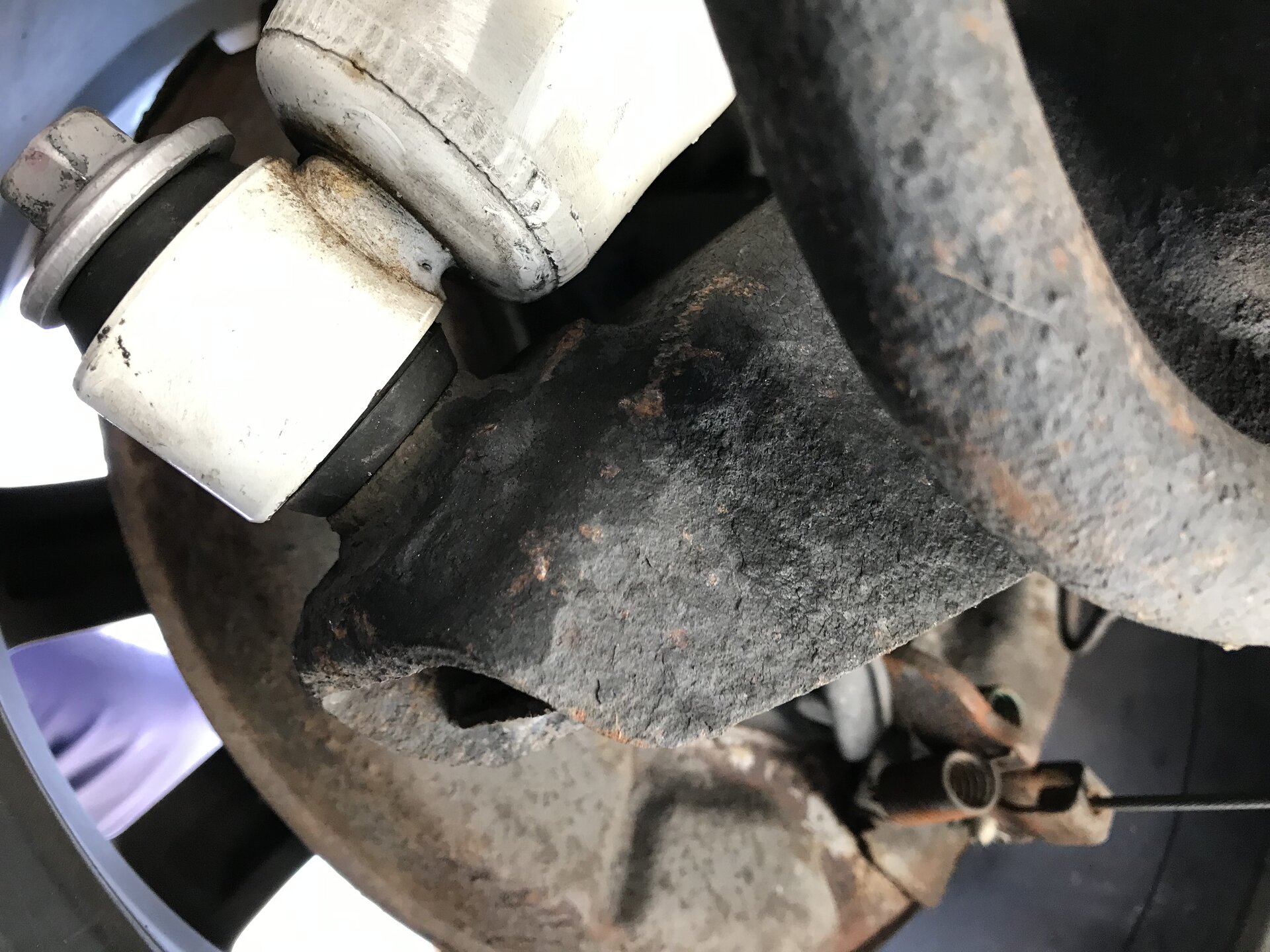

Yes my rig is crusty. But here is a picture of the same shocks reinstalled with the new bushing and new bottom bolt washer. Manual specified torque spec. Do I need to tighten the ever loving s*** out of it to compress the bushing a eliminate any space gap in the bottom mount area
Absolutely no. Do not over tighten these else you will be googling “helicoil” and learning things the hard way like I just did :)
I was confused- that’s definitely not a 100 series front end then I saw the 4Runner avatar
Never changed my avatar, but it 100% was a pic underneath my 2003lc
