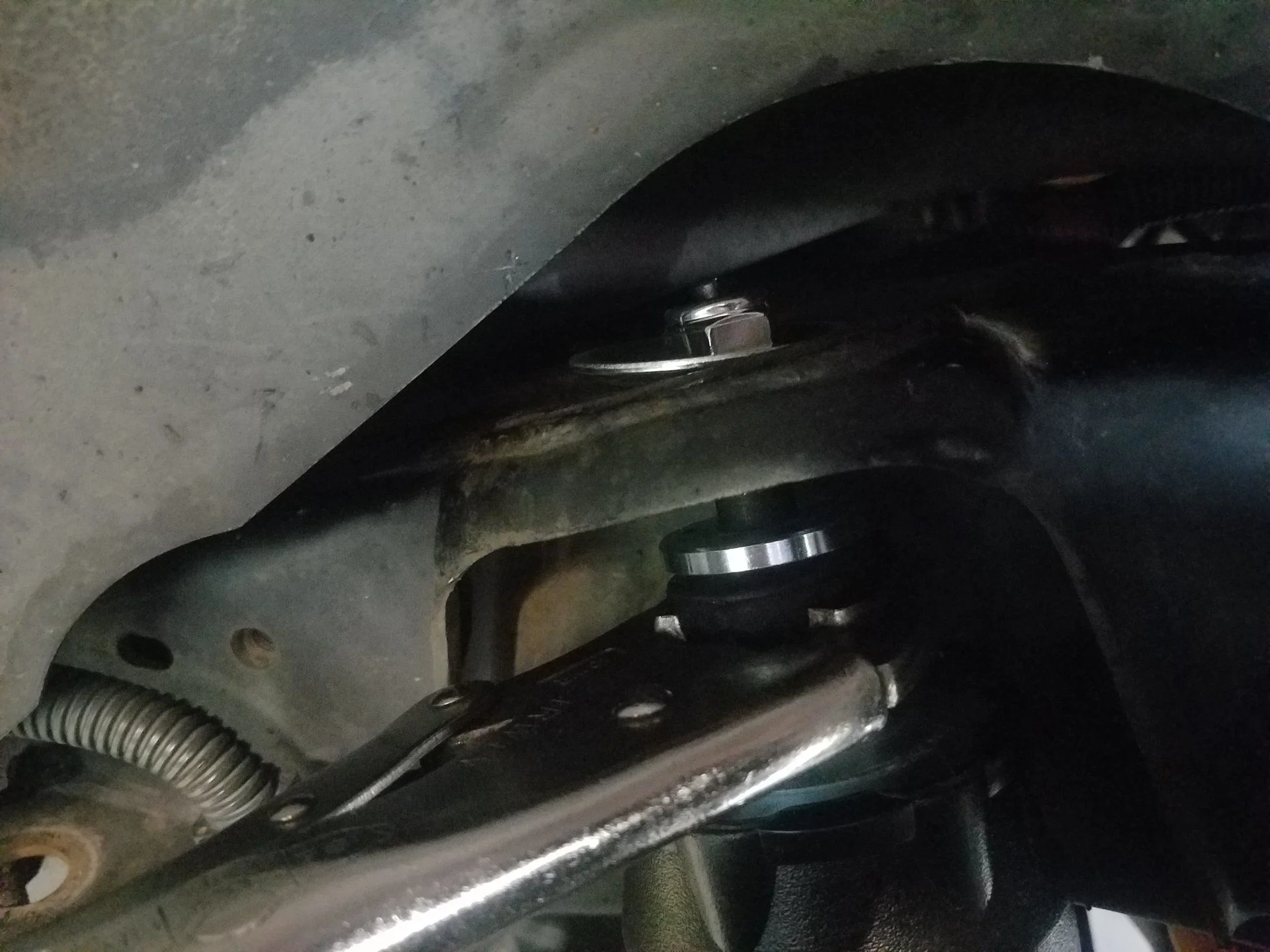

Trying to install my suspension today
Front worked super easy and are in
Back...wtf

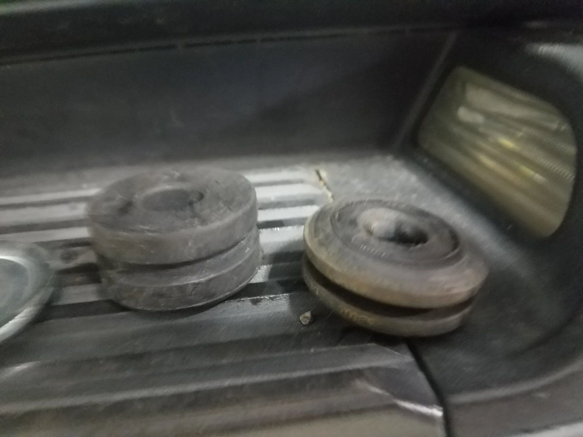

Ok so the conversion kit is on and springs are in but there isn't any clear cut orientation or order for all the washers or spacers for the struts.....plus the foam cells seem to be topped out as in they won't extend far enough for the top nut to go on even w the smaller/thinner factory bushing/spacer
A simple pic would be nice of the setup but any help other than pulling said fuses and a pic of their places is pretty self explanatory...
Did I receive too short of a strut?
Whata the order and I assume the metal sleeve goes on the bottom of the frame.
Called metal tech and they emailed me the of they shipped w the set and i can't get up w anyone thats a specialist.
Driver side w no top bushing yet...barely enough room for nut to start

Looks like you got the passenger secured. Did you try using a jack to lift the side of the axle that your working on? If everything is currently disconnected and the truck is at full droop, that may be what’s causing you difficulty.
Now that one side is secured, jack the drivers side of the axle up until you’ve seated the strut.

Presumably you have the rear springs fully seated on/around the coil conversion disc, with the coil end seated properly?
Foam cells are not like normal shocks. I always put the top in first then use the weight of the truck to hang on it and let it slowly extend down to the axle mount. They dampen on the up and down stroke and are not pressurized, so you can do things a little differently.
Edit: I have even used a jack to shove that SOB up into the top to get a nut on there and then attach the axle. It is pretty simple really once you realize those shocks don't act like normal shocks.
