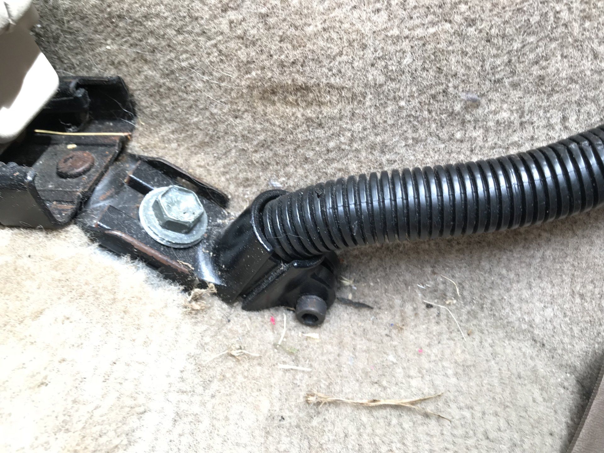

Ram has a bracket that goes under the passenger or driver’s front seat bolt.
That is exactly what I need - Just drill through the dash? What kind of hardware?
