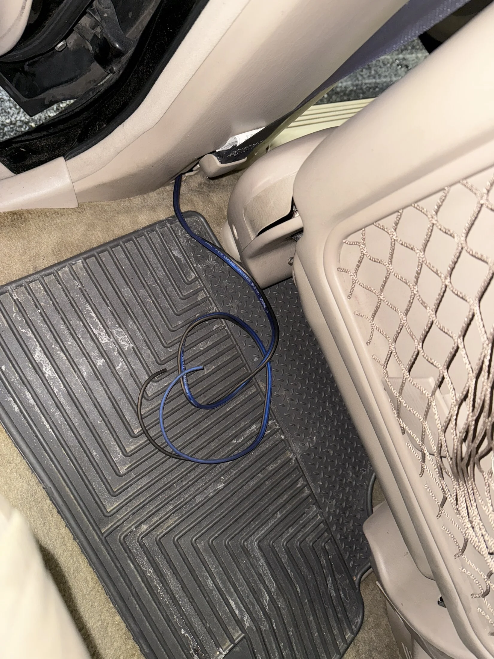

Now you can run that wire from the back of your radio and down and out from under the dash where your gas pedal is, slide under the top of the carpet and poke back out from under the carpet by your fuse box. Then you can fernangle around with your rubber grommet which houses the harness that crosses over from the vehicle body to your inner door, and once you hurdle some how getting a wire or two thru that tight harness, run that wire thru a big hole in your metal door to meet up with your speaker and you are home.
Drivers rear speaker:
It starts out the same, but you run your wires under the drivers seat, after removing driver seat, and you can wiggle wire across under the carpet to poke out by the center post where the front seat belt is mounted. From there you are screwed. Harness is too tight to get wire thru…. Thoughts?? Maybe I’ll keep going and get something good sounding going in the back…

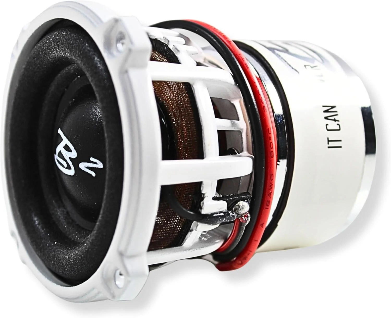

I might use that wire to place this little RC subwoofer under my seat. check it out:
