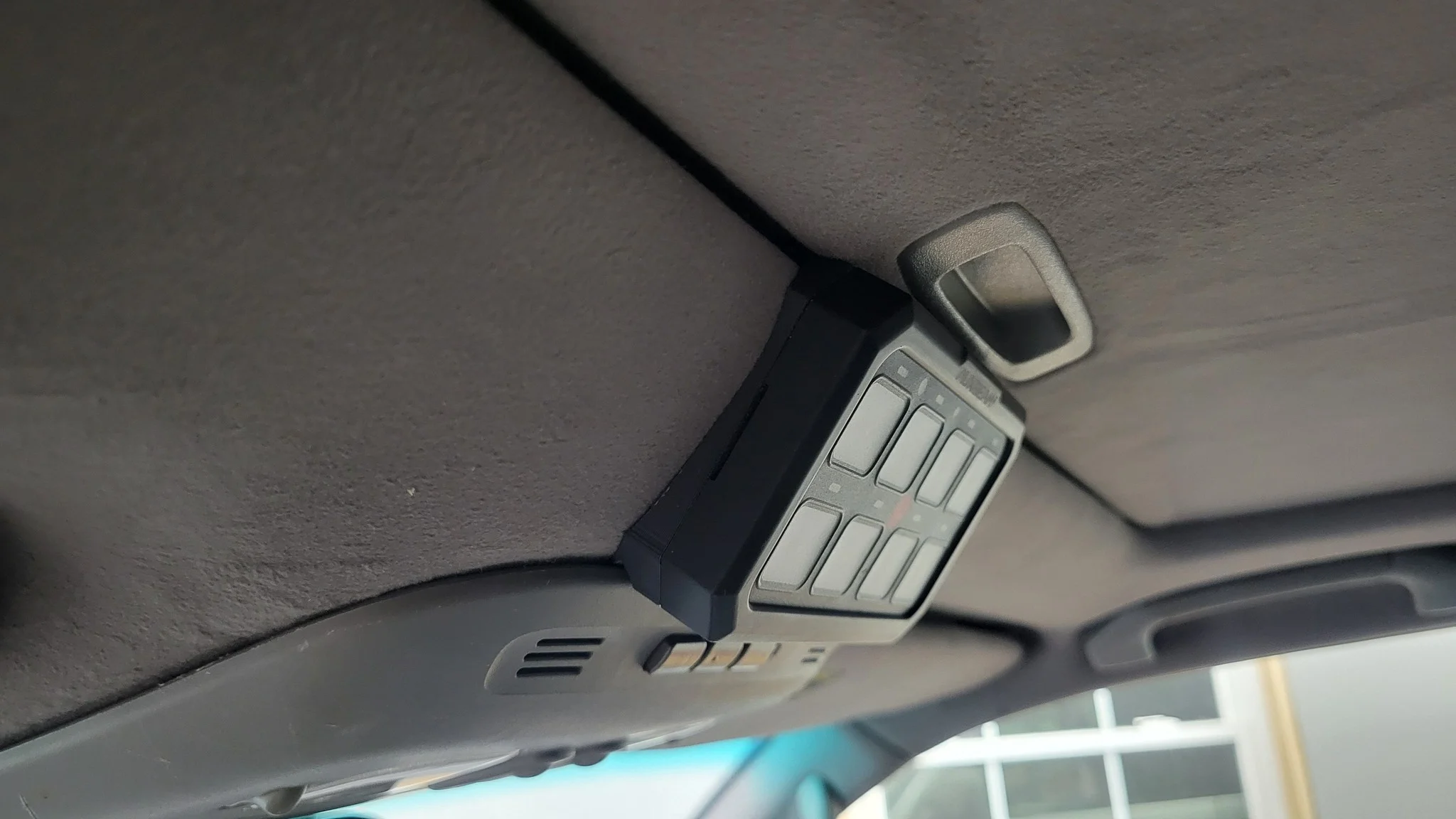

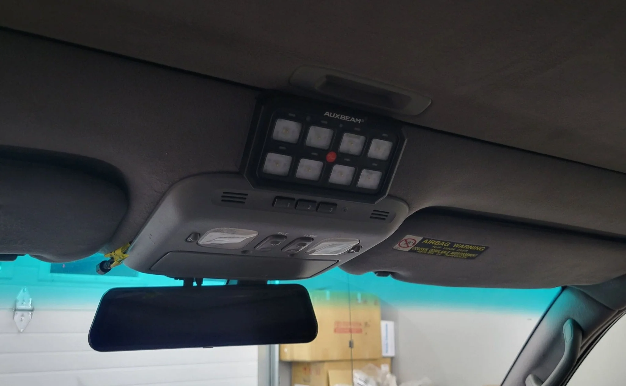

The first product I'd like to introduce is a mount for the Auxbeam series of relay control systems - this mount 'snaps in' to the top lip of the headliner where it wraps into the sunroof, and then locks in between the overhead console and headliner down low. This provides a SUPER secure mounting solution for the various Auxbeam switch panels (RA/GA/BA/RB/GB/BB-80, RA-80XL, AR800/820 are all supported) that requires absolutely no drilling or permanent modification. It also allows you to route the Auxbeam control cable 'under' the overhead console, to the top edge of the windshield, and then from there over to the A pillar & through the firewall. It features a mounting hole pattern to match the mounting holes on the Auxbeam, counterbored to allow you to use the screws provided in the Auxbeam kits. These are 3D printed in black ASA, which provides heat resistance & UV stability that is perfect for a long-term solution in a vehicle.
I think this is a really slick mounting location that still allows you to retain the sunglasses holder - which was a critical requirement for me! Variants for the 8 gang 'normal' and 'XL' available, 6 gang, and 12 gang across the 98-07 versions of the 100 Series!

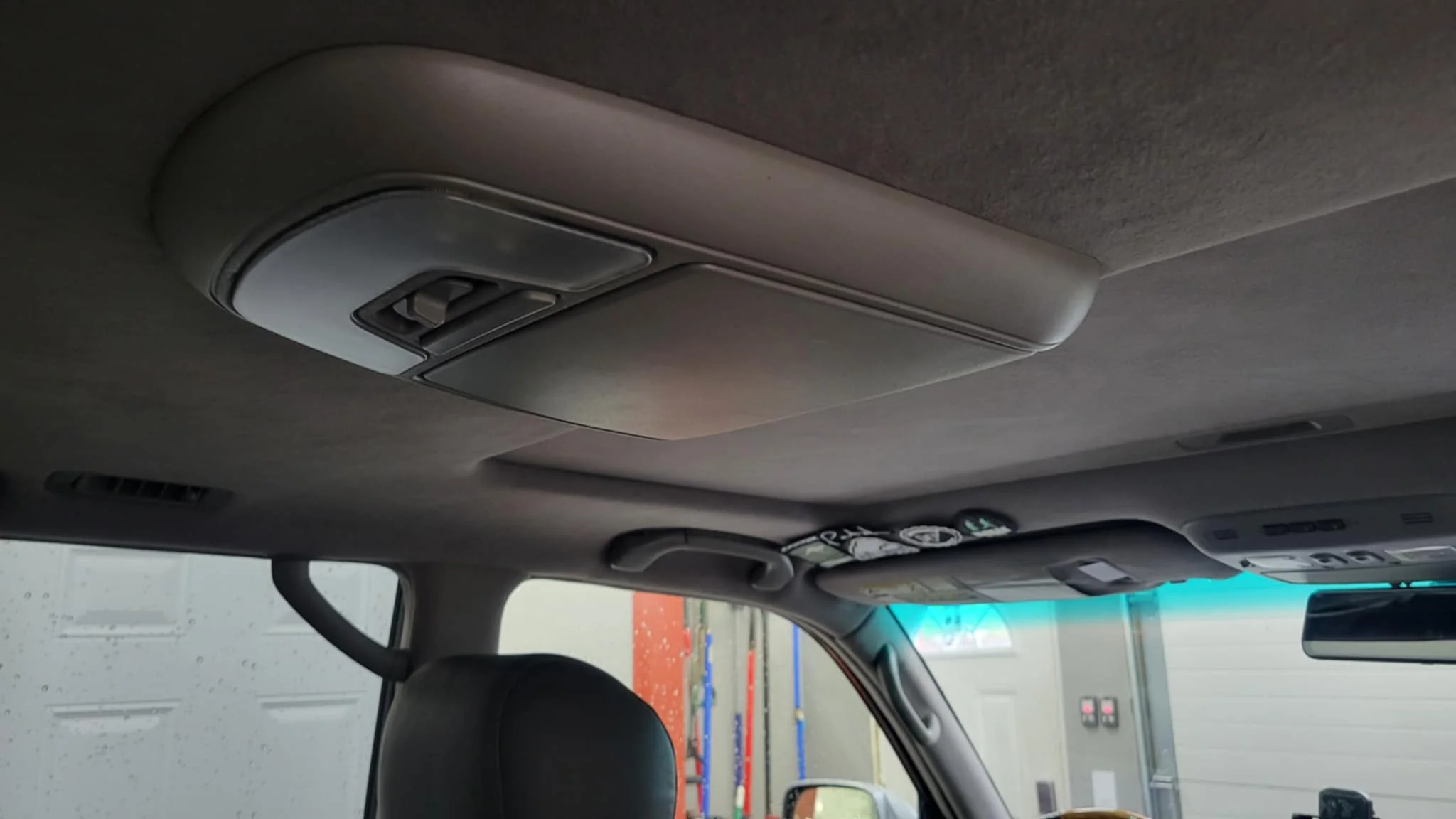

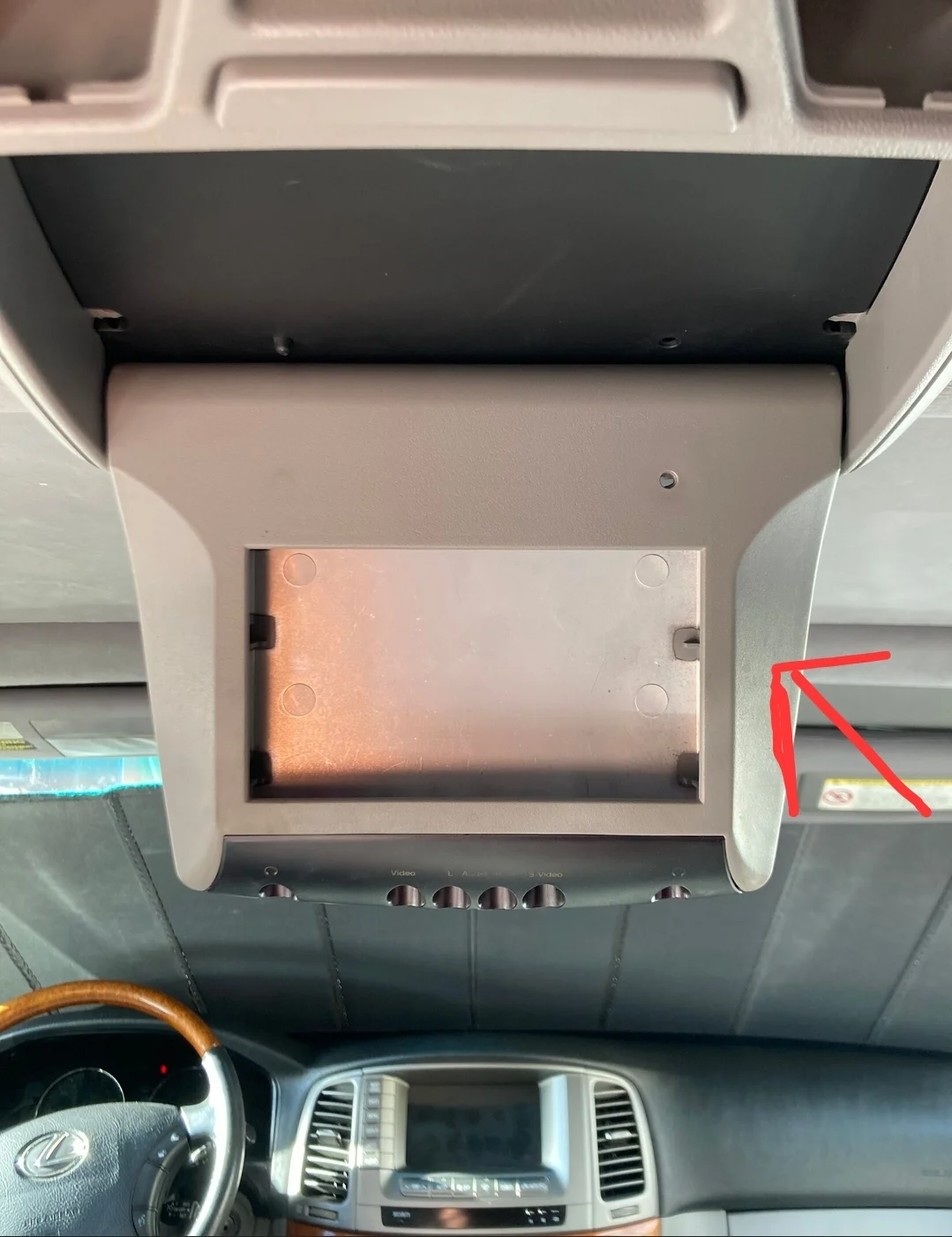

Test print of this finished late last night & will do some test fitting soon. The intent is that you're able to keep the exterior of the flip-down screen factory while gutting the inside of it. This will let you store 2x sunglasses, or a non-trivial amount of jelly beans. Your choice I guess?
Obviously this only works with the factory DVD player screen. It replaces the 'inside' shell - the part with the arrow pointed to it: (photo cred to @mrkdwrds )

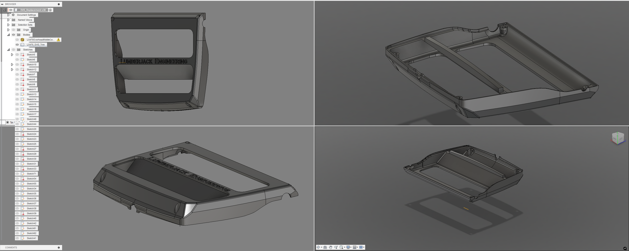

And below is a screen grab from CAD of the designed part:
While this may be of dubious use to some, I've actually already yanked the DVD player itself - so I have no reason to keep the old screen around. Removing the factory screen console entirely would leave a giant hole in the headliner, so this is (IMO) the best solution.

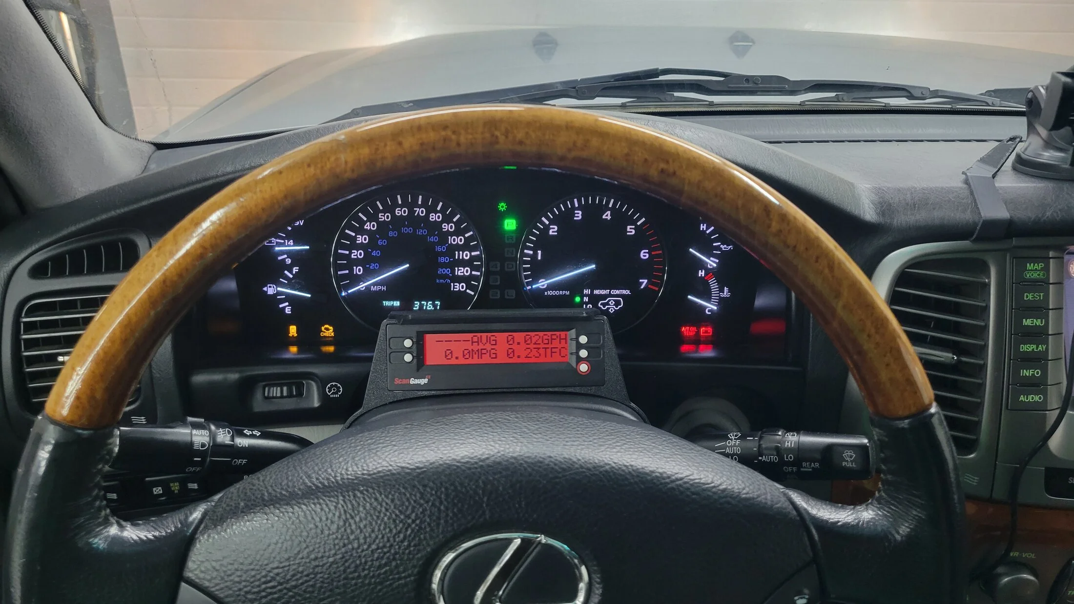

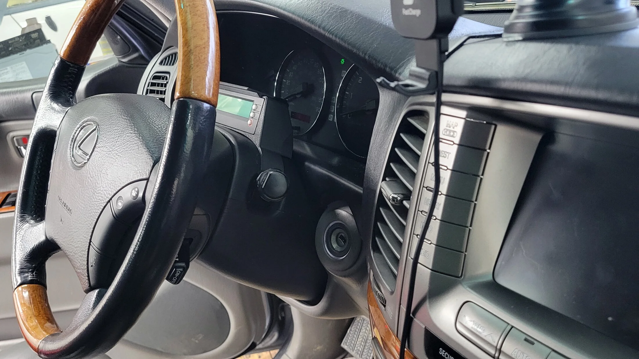

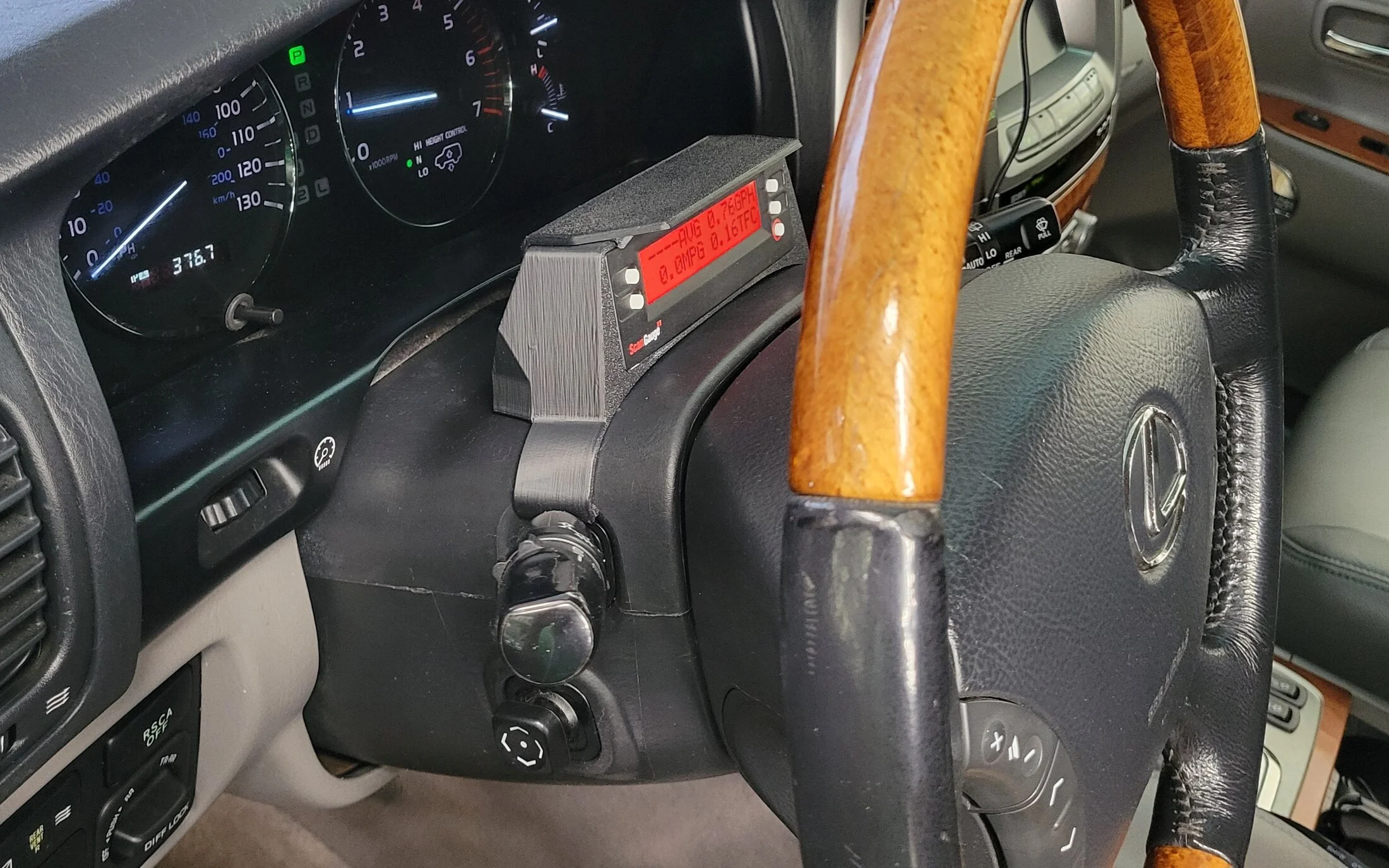

I wanted to highlight one of my designs sold over at TAG - a mount for the Scangauge II:
This puts critical information (real time coolant temp and transmission temperature) directly in your field of view whenever you glance down at your gauge cluster - I've really enjoyed having my personal SG II mounted here in my 2005 LX470.
It perfectly contours to the steering column in all directions (achieved via 3D scanning the column & using that to guide the CAD) and attaches via 'snapping' onto the column around the turn signal/windshield wiper stalks recesses - no drilling required! It's ultra secure & doesn't interfere with the stalks at all. It's also engineered to not interfere with the auto tilt/retract of the steering column, and is tucked back as far as it can be while still achieving that.
The kit includes a 1' black flat ethernet cable + ethernet coupler to allow you to route the cable along the top of the steering column without drilling, where it's nearly invisible. It also includes a removable sunshade (pictured) to improve readability in ultra bright situations.
These get 3D printed in ASA for heat resistance & UV stability.
Note: It does block VSC + center diff light, and depending on your seat/steering wheel settings & height you may obscure the odometer as well. These aren't issues for me, since I find the info from the SG to be much more important, but I wanted to ensure that's disclosed. The first picture is taken directly from my vantage point while seated in my driving position to give you an idea of what it looks like.
IMO, it's my favorite SG mount because it keeps the data right in view. I've been using my SGII in the overhead console for year, and while it fits like factory, I have to duck just a little bit to see the top of the screen. I just installed the column mount in to my own truck yesterday and have really liked the location. And the 'snap' in to place is super satisfying ;)
I'm going to sand and paint mine to match the brown of the column. I'll post back here when I find a good color match as I'm sure others will want to paint to match as well. We can't all have black columns like @LJE .

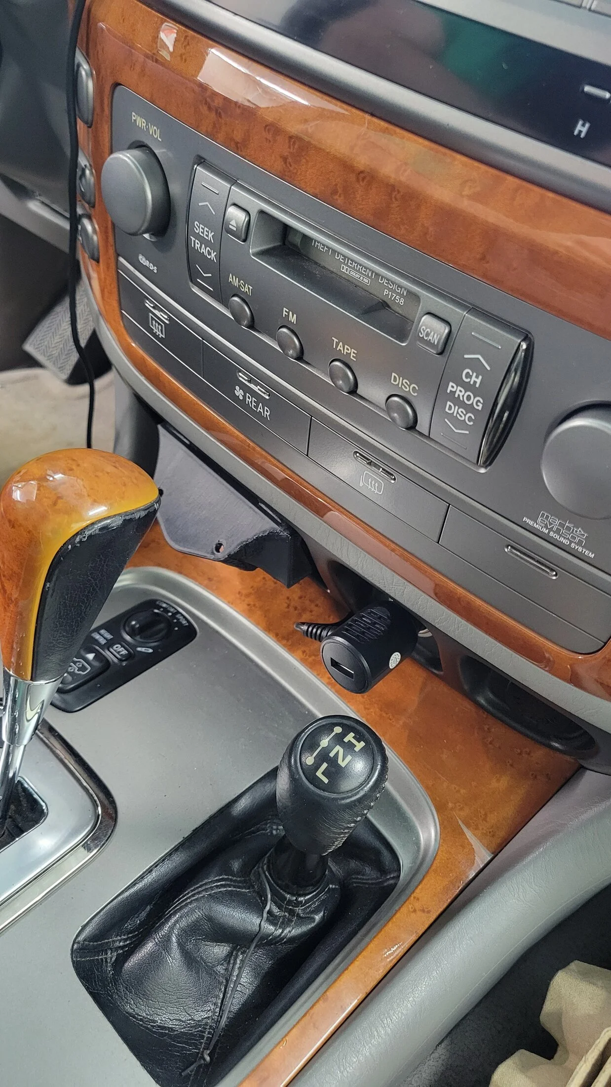

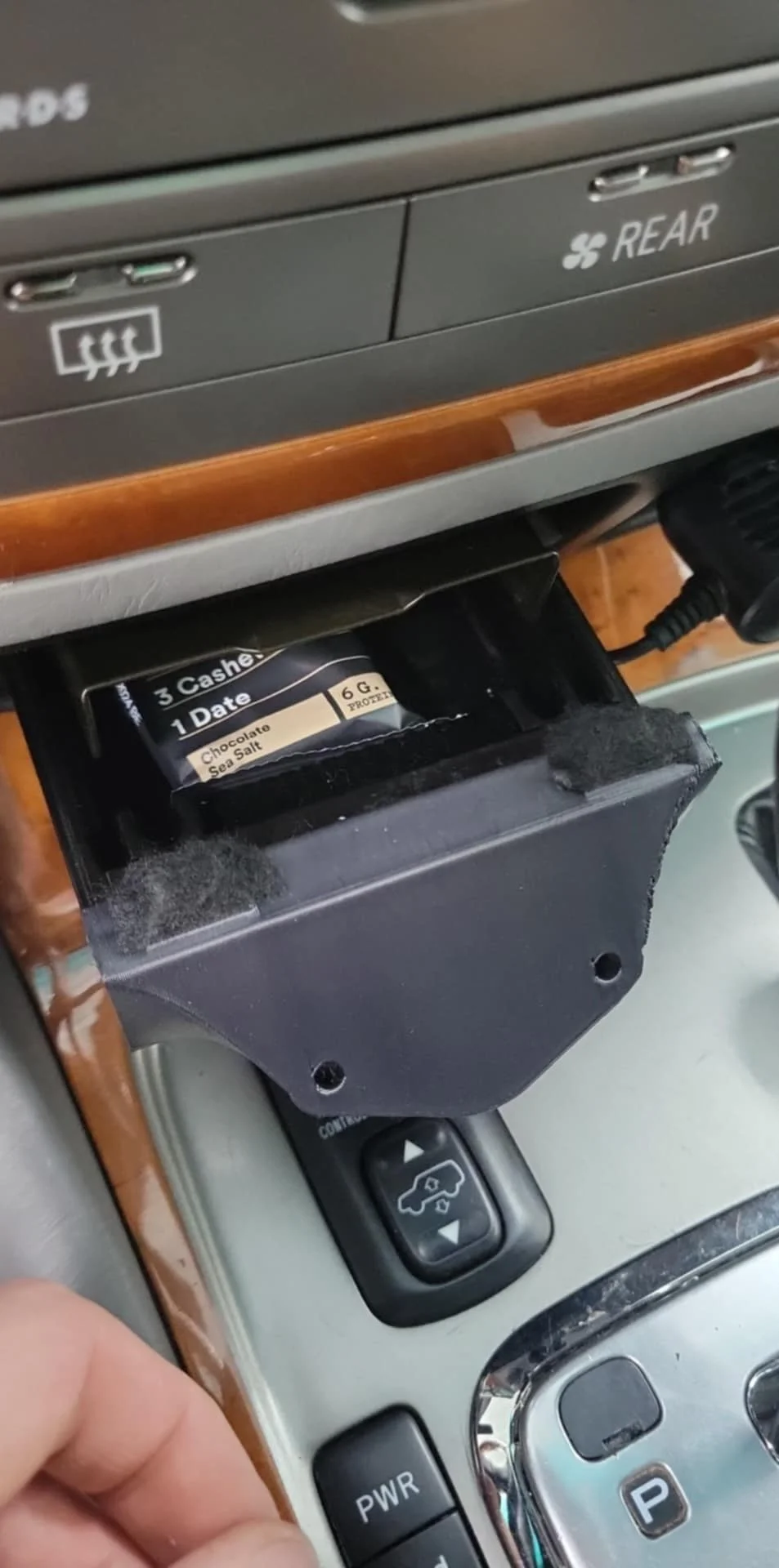

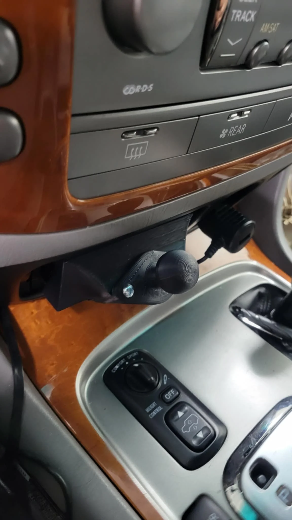

I had a customer request a solution that allows them to mount a Ramball phone mount (this one specifically) to the ashtray spot.

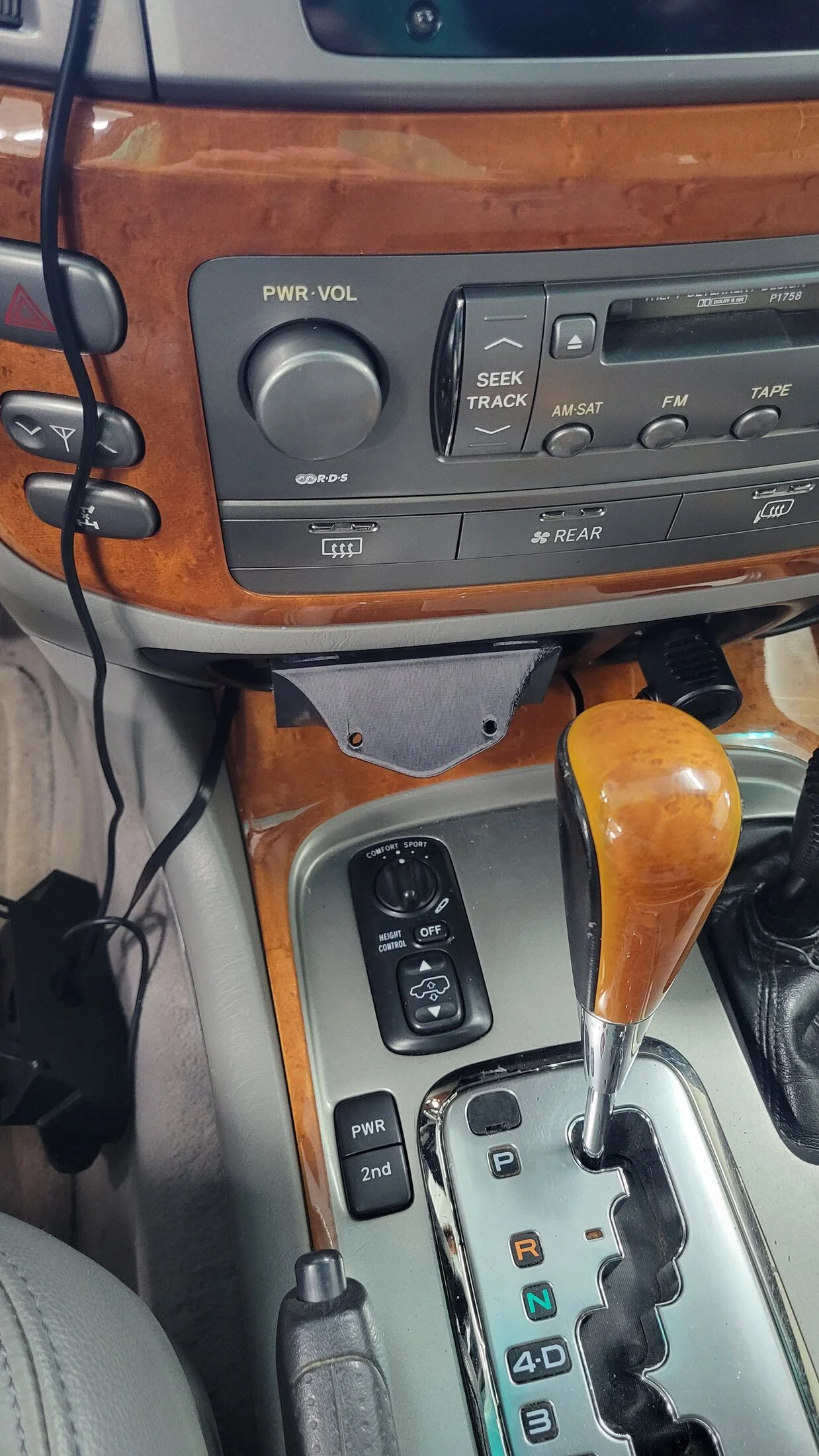

I had previously developed a replacement front trim piece for the ashtray that allows me to mount my KG1000 radio faceplate to the ashtray itself by replacing the front cover, while still maintaining storage functionality (gotta keep the jelly beans handy!), so I knew I could quickly iterate to a functional design for this:
It was a quick modification to swap out the radio faceplate mount for something that allows you to bolt the diamond base of the RAM mount to.
This mimics the same locking clips and tabs as the original trim piece for the ashtray, so no drilling or permament modification required!
I 3D printed the RAM mount diamond base for the above photo to check for clearance - plenty of room around everything!
It also features "nubs" on the top of it that get felt tape to keep everything tight with no rattles. These wedge against the top of the ash tray recepticle when it's locked closed to stabilize the entire assembly:
The original customer said it fits & works great - waiting on some final installed photos from him to share!

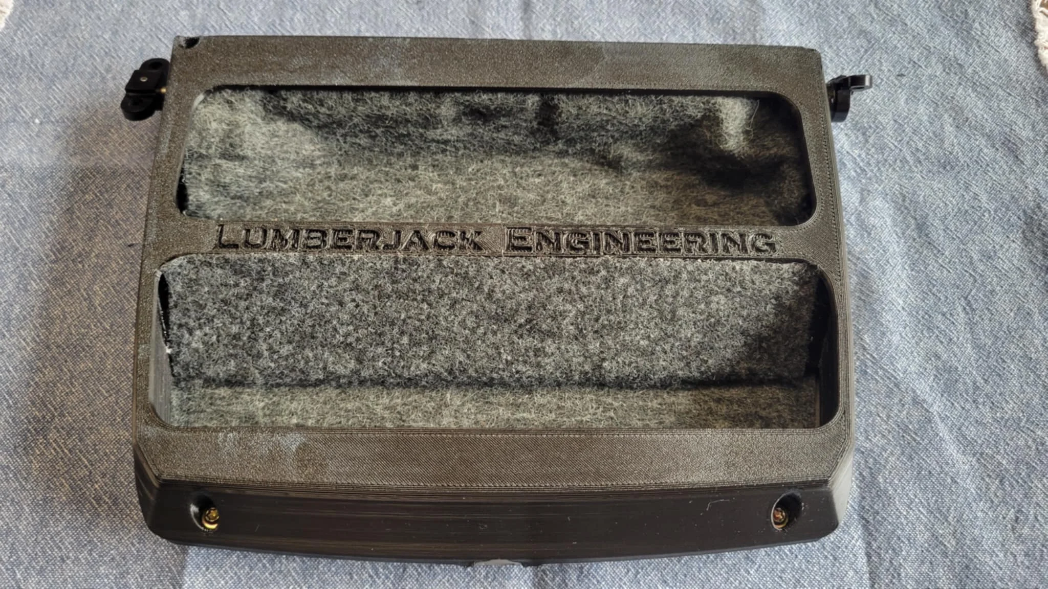

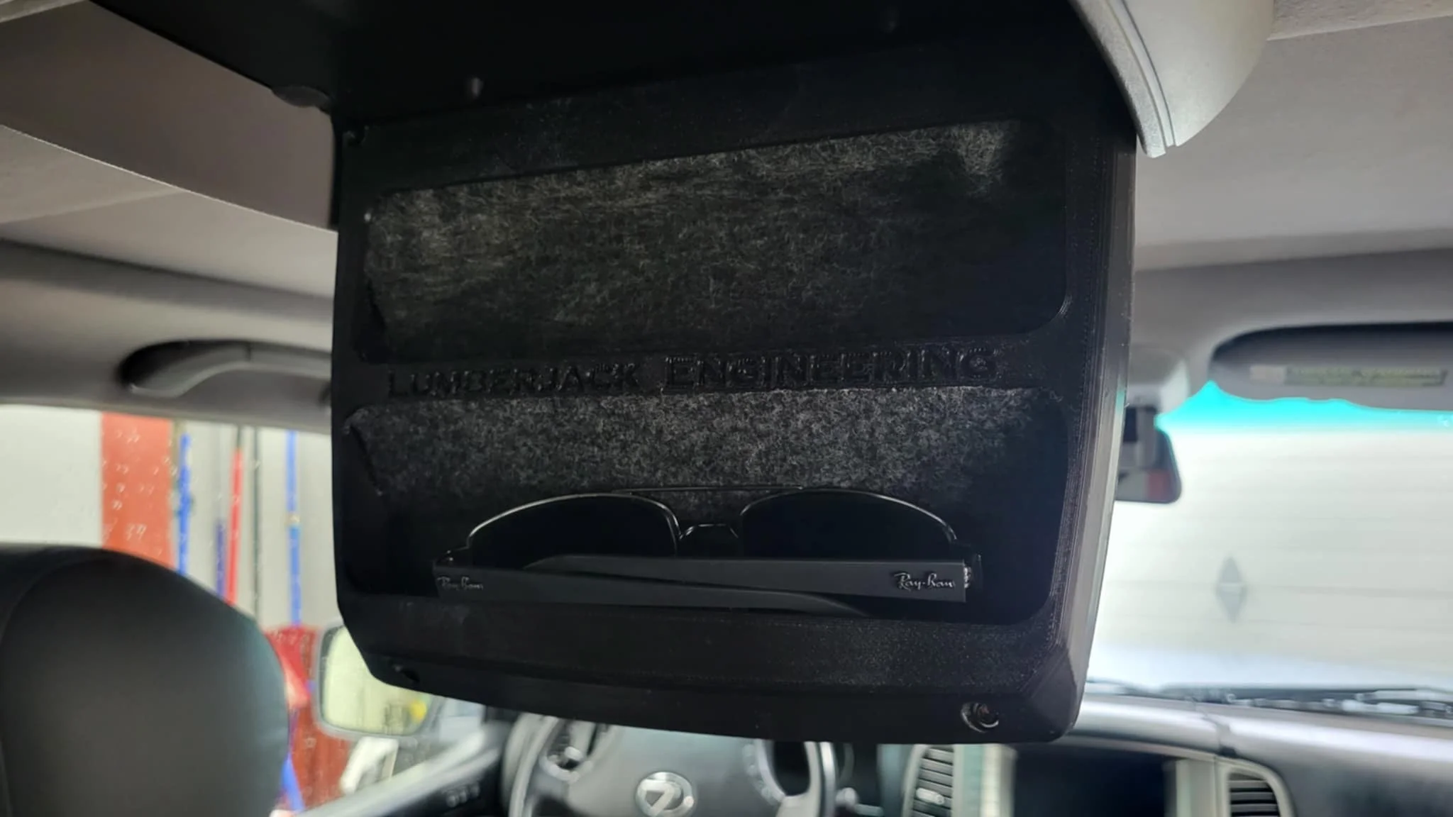

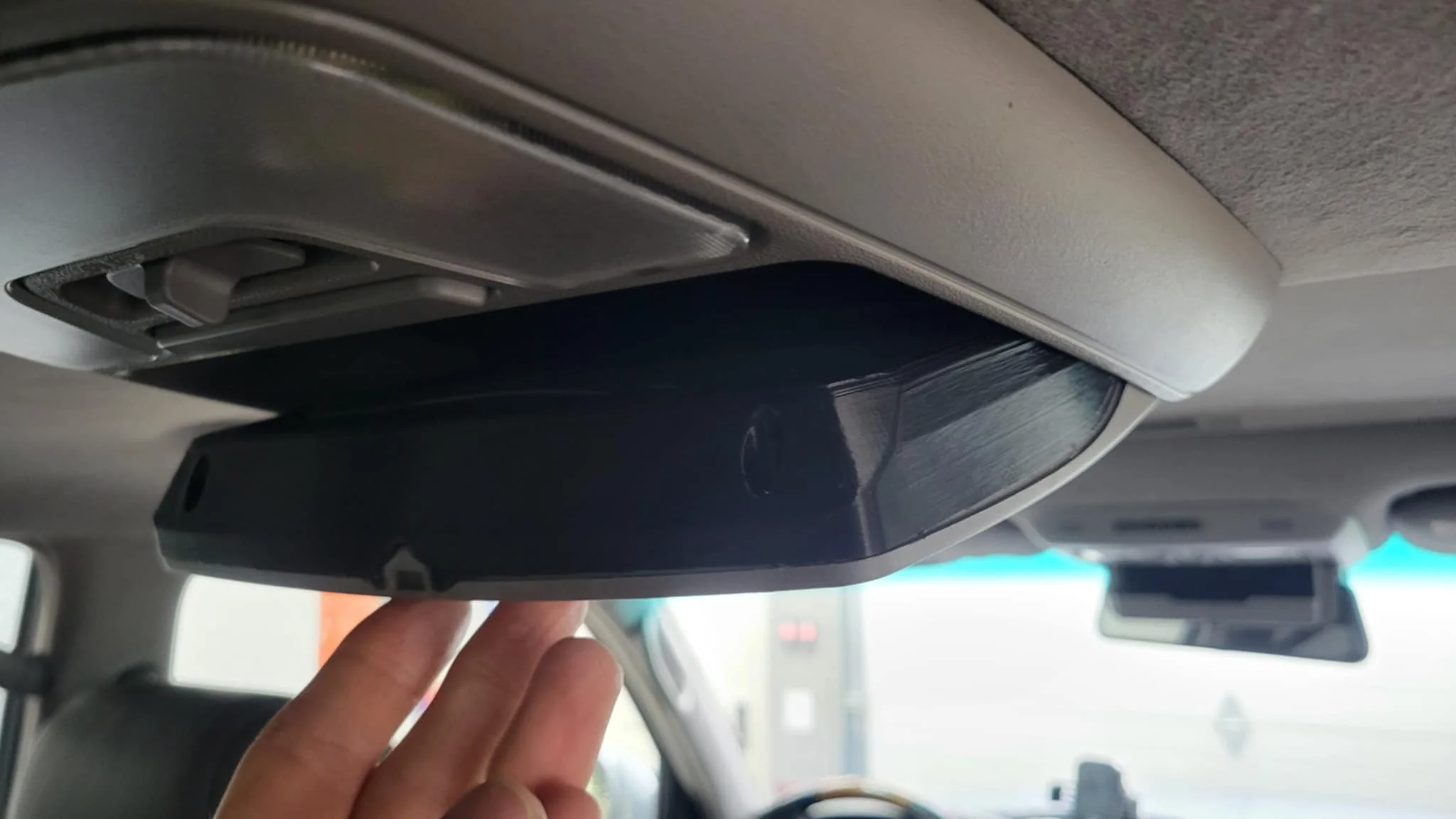

After a series of ten printed prototypes and countless modifications/tweaks to achieve perfection, my replacement trim for the factory DVD player is complete!
This allows you to store sunglasses, pens, or emergency jelly beans while keeping an OEM look when closed.
This project has been on my list for a while, but @mrkdwrds posting about it recently gave me the motivation to go forth and actually put the time and effort into this - it was a lot of work! Even with a decent 3D scanner, perfectly matching all of the complex contours to the required tolerances was tough - take a look at the 'pile of shame' below - 9 printed (and failed) revisions working on getting it to perfection:

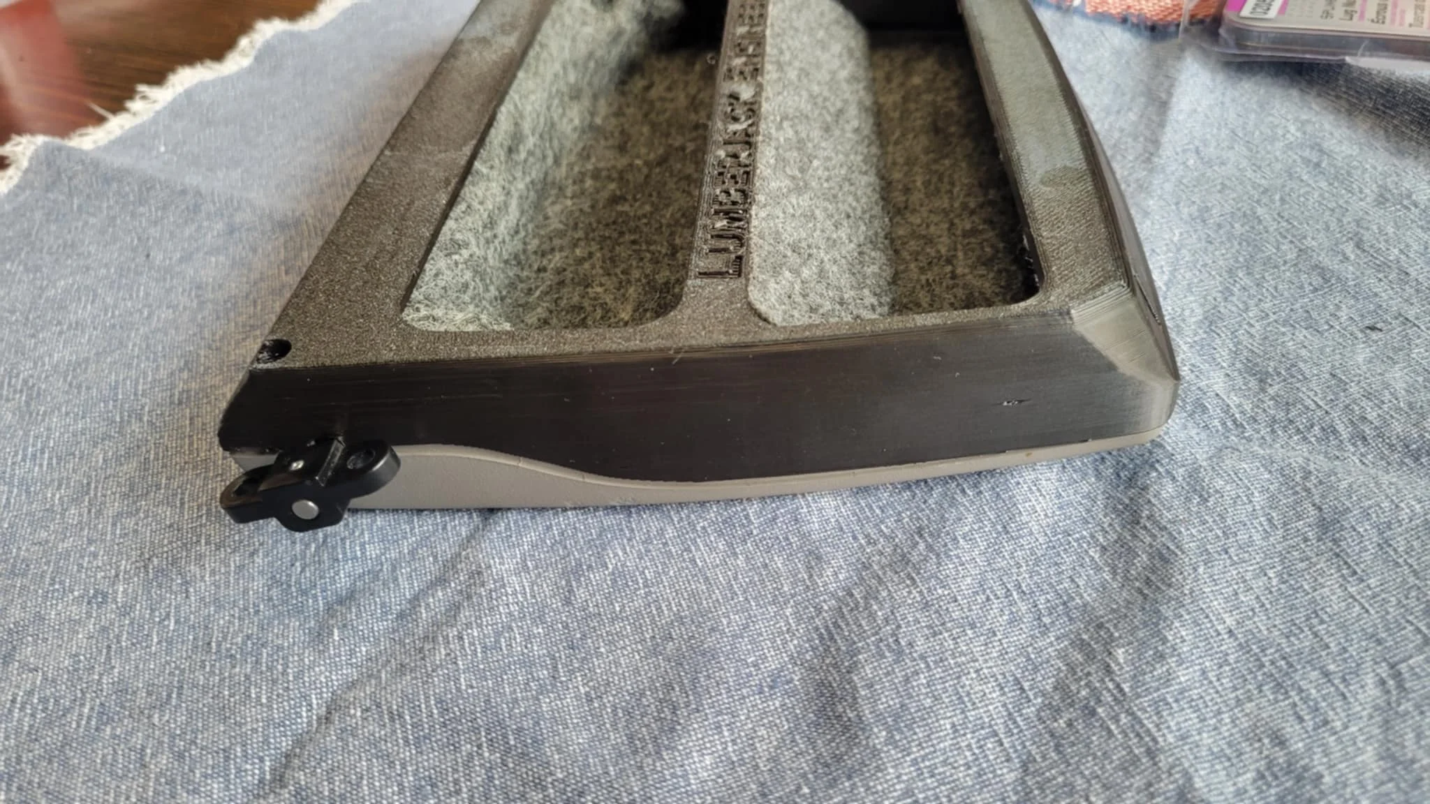

The tolerances required definitely push the limits of the FDM 3D printing process - but, on Rev. 10, it finally all came together! This is after I've installed some felt with spray adhesive:

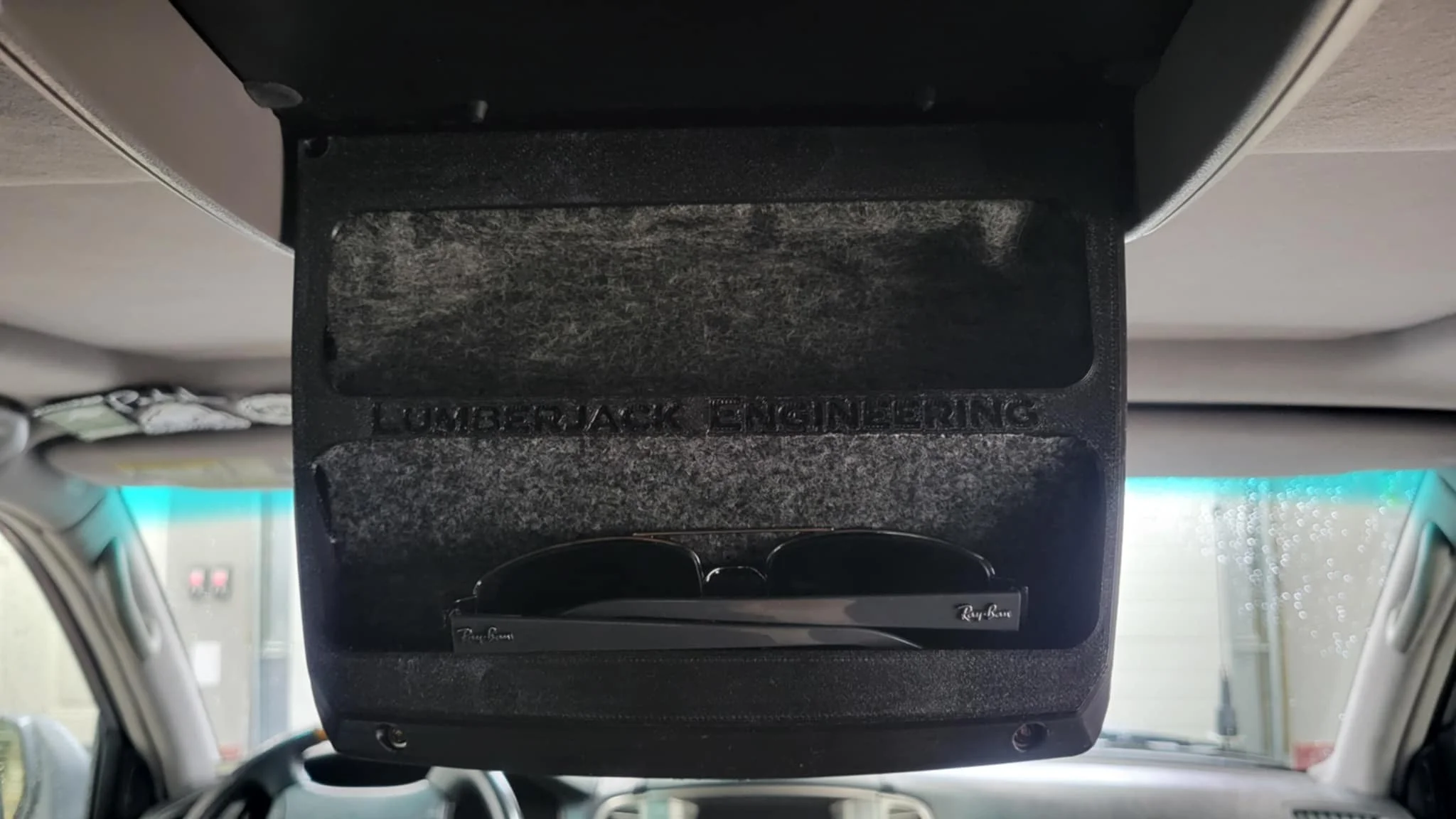

Maximizing storage space while maintaining needed clearance was the goal here - the factory DVD player trim has just enough room to clear, and I needed to maintain that:
The below picture has some pretty large Ray-Bans - they fit great in either the upper or lower spot, so I figure whatever sunglasses you've got should fit too!

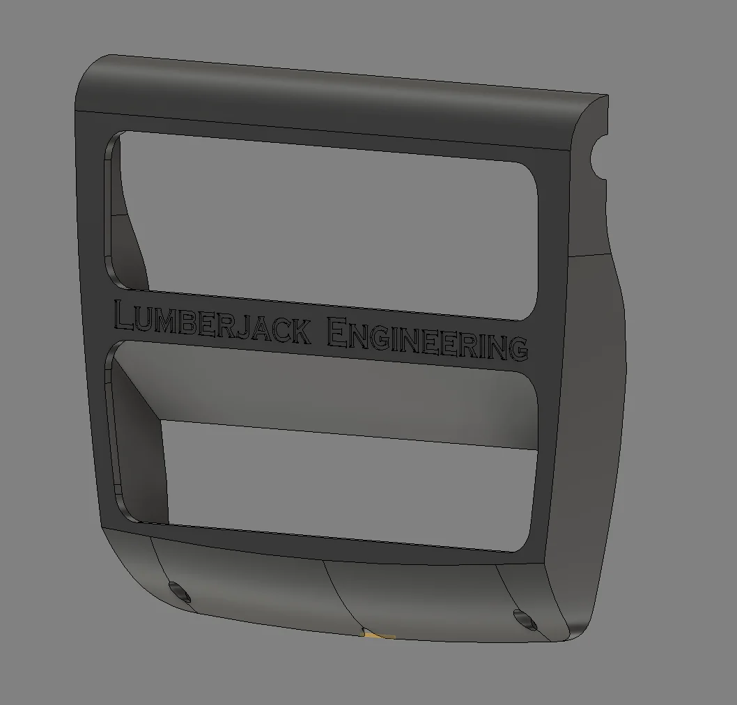

And finally, a screen grab from CAD - the sketch/feature tree on this could probably get classified as a crime against humanity, but oh well...
There is some modification required to the interior of the lower OEM trim piece (the part visible when it's closed) - trimming internal supports mostly. I've got a 3 minute video that walks you through that, so don't be scared! It's easy, and if you cover it in felt like I did it's all hidden anyways.
Definitely proud of how this turned out overall - wasn't always fun, but it was worth it in the end! Shoot me a PM if you want to order - looking at $60 with shipping included. As always, this is printed in ASA for long term UV and heat resistance.

It's pretty straight forward! It takes a T20 and T15 torx bit, and something like a trim pry tool to pop some clips out to get the overhead console down and the screen body taken apart. Roughly five minutes.
Modification to the OEM bottom trim (what you see when it's shut) can easily be done with a dremel tool - those instructions are in the video below.
I'd say the install would take less than an hour total from start-to-finish. I'd certainly be available for any additional support needed, but it's really pretty simple.
Visually checking and comparing would be the easiest way to tell. All the 'port installed' ones look very different than this factory one.
