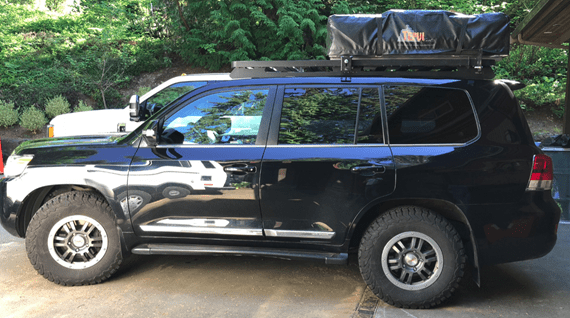

I have been having some fun in the garage and wanted to share some of my first projects on my 2016 Land Cruiser. I’ve been taking it slow but last month had the opportunity and pleasure to spend a week in the Canyonlands with my family and some friends. The truck did great but of course now I have a slightly longer list of todo’s

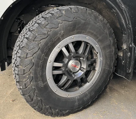

Toyota TRD Rock Warriors and 285/70r17 BFG KO2
I like the look of the Rock Warriors and have always been a fan of the BFG KO/KO2 tires. As with many others I sized the tires to 285/70r17 and with stock lift there is no rubbing. The Rock Warriors wheels were OEM on the 2009-2013 Tundra Rock Warrior package, and I actually did find a set of new wheels at a nearby Toyota dealership but priced as such- about $400/wheel. I waited a bit and was fortunate to find a set of 4 wheels locally that were in nice condition for about half the price of a new wheel.
Toyota did change the part number of these wheels. The earlier wheel was part number PTR45-34070. The newer model is PTR45-34120. From what I can tell the only difference is that a small groove has been cut into the trim ring that adorns the wheel possibly to aide in drainage.

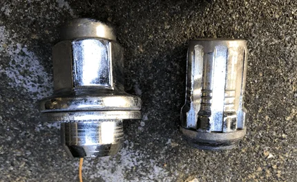

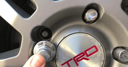

The wheels are a direct fit except the stock Land Cruiser lug nuts will not fit these Rock Warrior wheels and require the Toyota install kit part number PTR27-60110 which I found from Toyota Parts dealers online for around $150.
For those curious, here is a photo of a stock lug nut (left) and the TRD lug nut (right) that fit the Rock Warrior rims. The wide collar on the stock lug nut will not fit into the Rock Warrior wheel geometry.
A picture is worth a 1000 words- the stock lug nuts don't fit the rock warrior wheels.

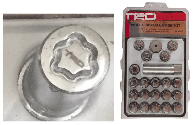

The TRD branded kit includes new lug nuts all around plus a security lug nut for each wheel and custom keyed socket. (I have heard that some people have had this strip out so I remain cautious to not over torque them beyond the 97 ft-lb for the Toyota aluminum wheels).
