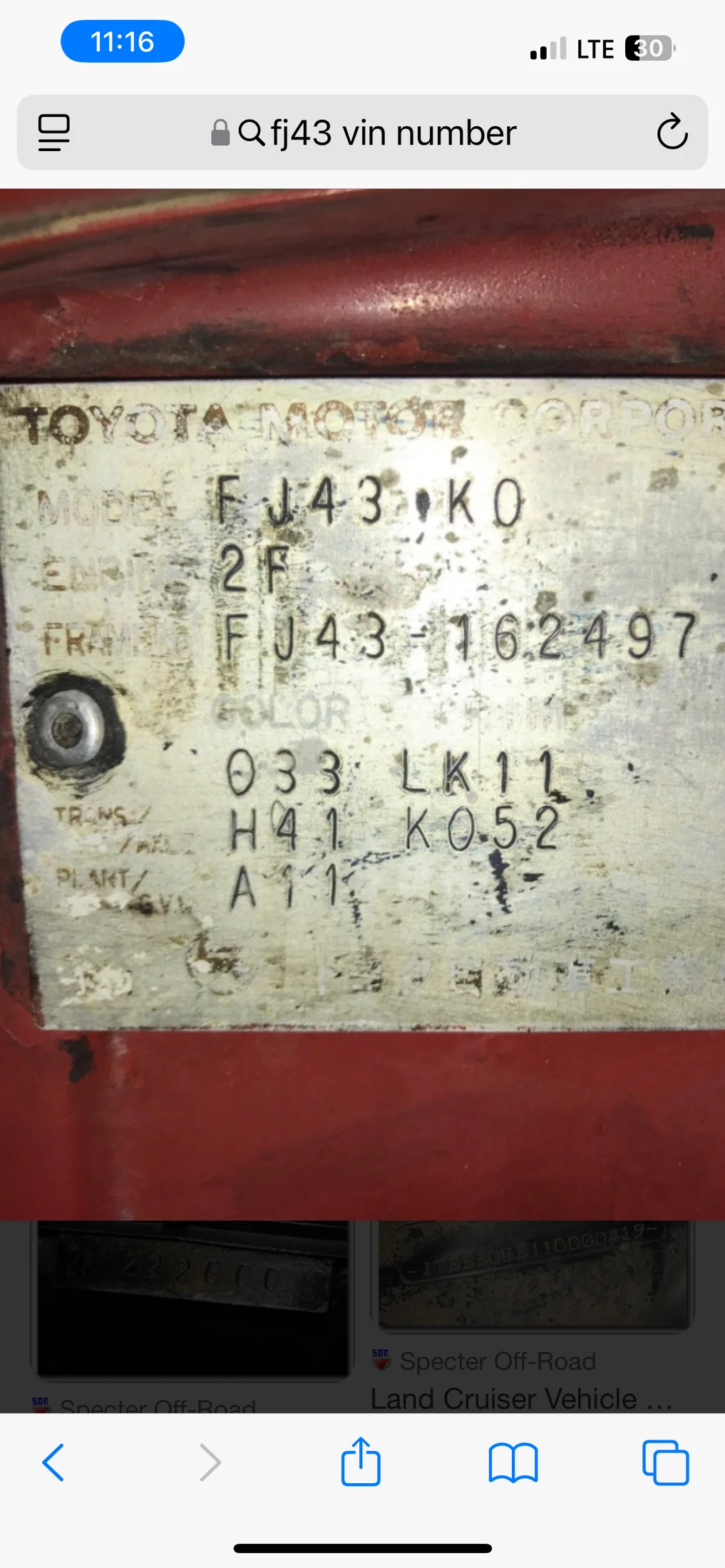

The question I have is, if a fj43 has the frame marked as fj40xxxxx. Could the car be an fj40 that was converted to an fj43? Or can an fj43 have fj40 on the vin?

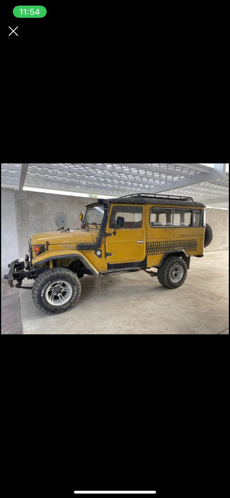

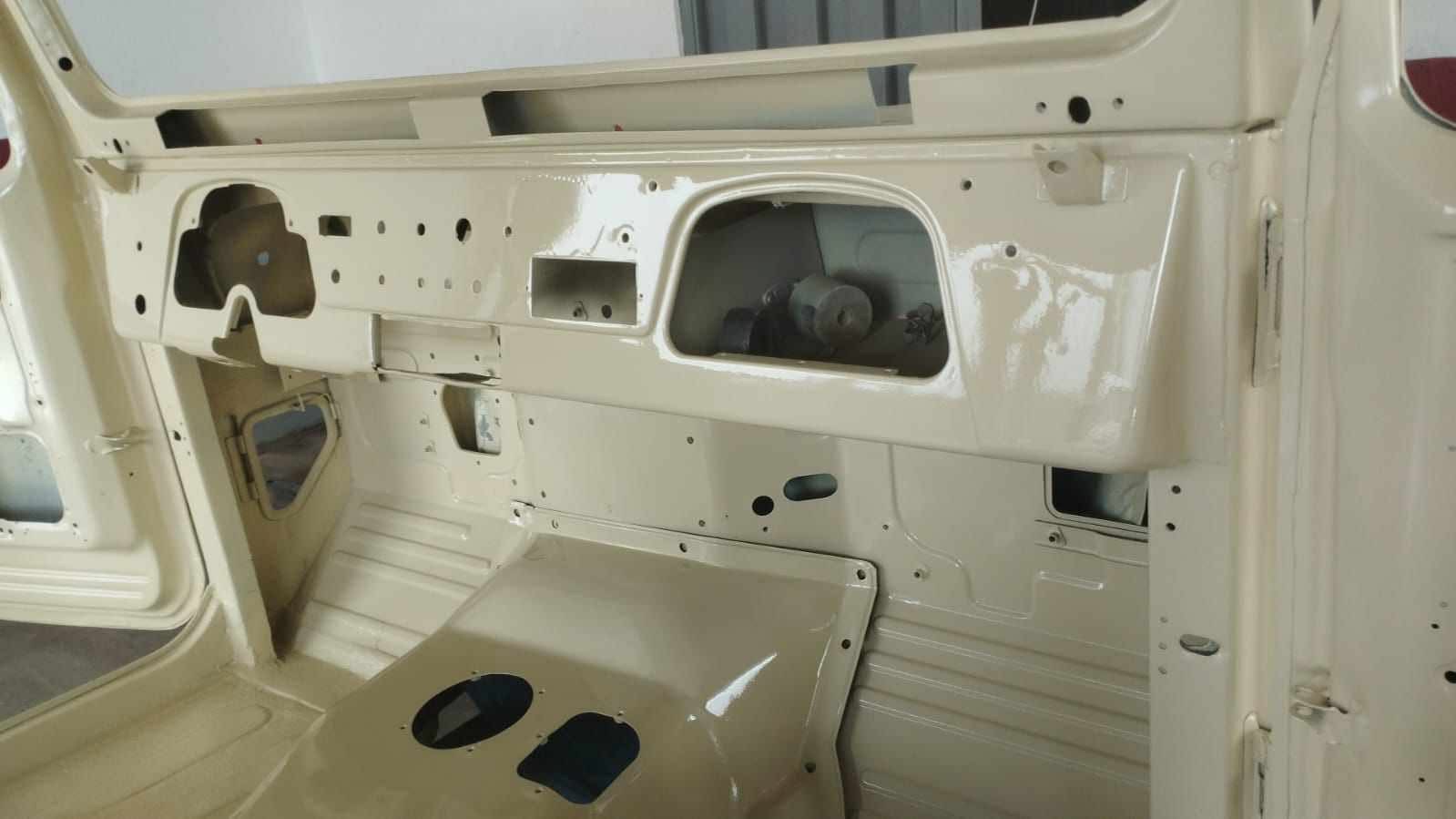

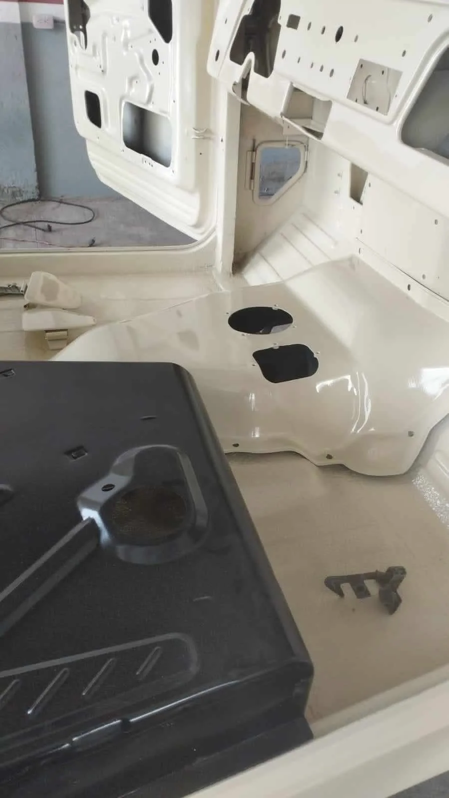

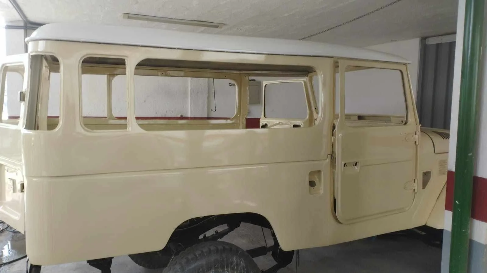

I attached pictures of the car pre-restoration

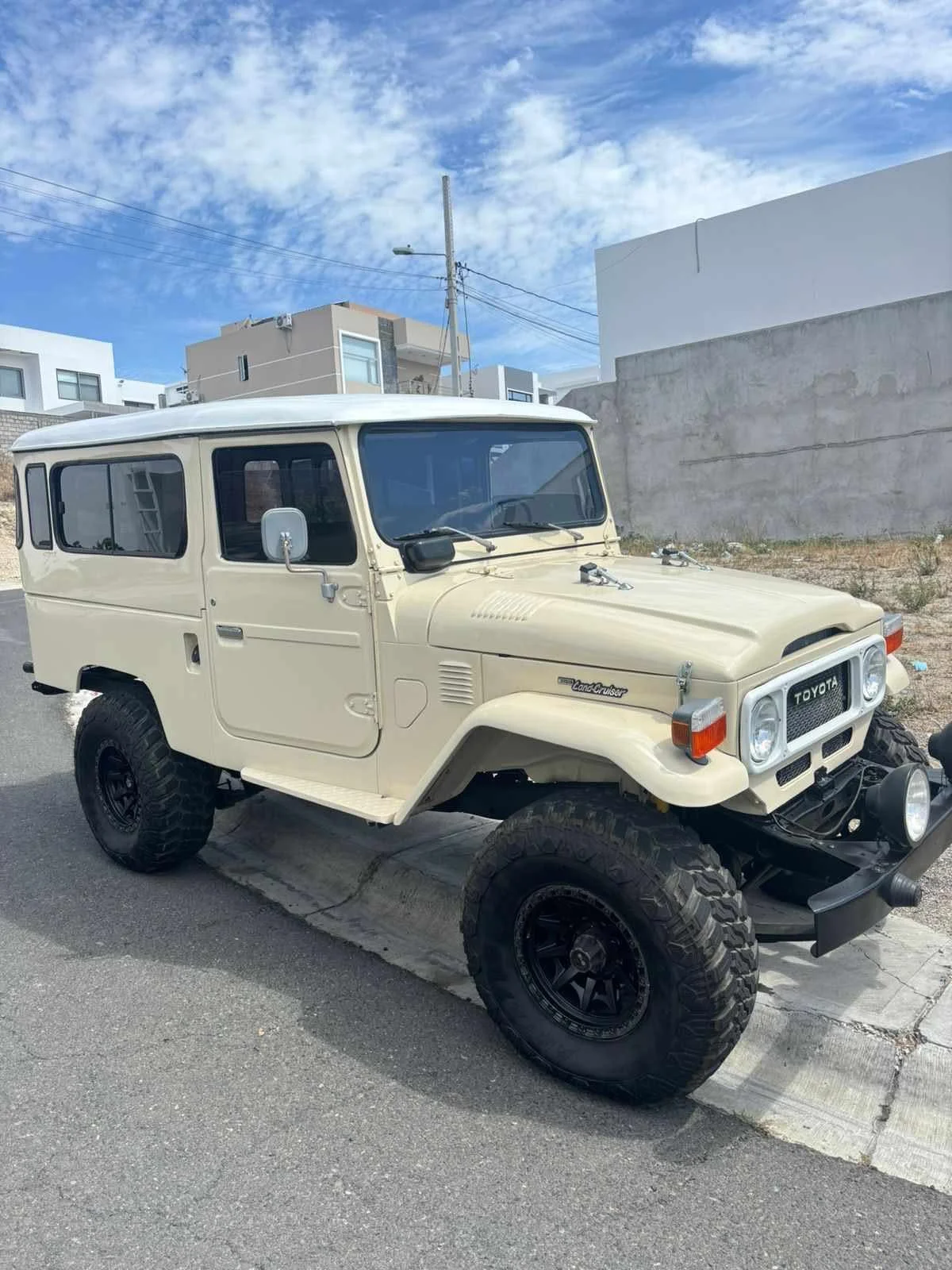

Welcome. I can't help you much with the VIN question, but she sure is pretty!

It looks OEM Troopy to me, but I know nothing. 40 to 43 is like a frame stretch and perhaps you could look for fish plates on the frame in the area around the front of the rear axle.

It's most probably a 40 made 43, so just an extended 40
Maybe it's a home made 43 in Ecuador, or they imported parts from Colombian manufacturers
I'm not that familisr with frame #'s on 43's. I agree with Charlie, my guess is somebody stretched a 40 frame and put a 43 body on it. It looks better now than b4 the restoration.
If they just stretched a 40 frame (and they did it correctly...see prior responses about fish plates on frame)
I can't see how that's a disqualifier for purchasing it. The truck looks pretty nice visually. I think your
deeper concerns, that should be investigated clearly, are how it stands up mechanically. Finding someone you trust that knows these rigs and go through it thoroughly...would be a super positive thing.
Are the hard top windows, correct? The back side window being squared off, I don't see any on my quick google search matching this. They all look rounded or one larger sliding window.
The other item that seems like it could be out of place is the lack of ribbing behind the front seats on the tub.

Looking at the pre-resto photo - it does look pretty stock - I remember those from working in Ecuador in the early 80's.
The rectangular hole for brake seat belt warning lights believe started 9/77. I would look at Spextoer Off Road VIN chart for the FJ40. Cowl attachment to the rest of the tub changed 1/79. If the VIN is between 9/77 and 1/79 most likely a 78 model stretched.

btw it is a nice looking cruiser.... but.... seems to be kinda sketchy body work wise

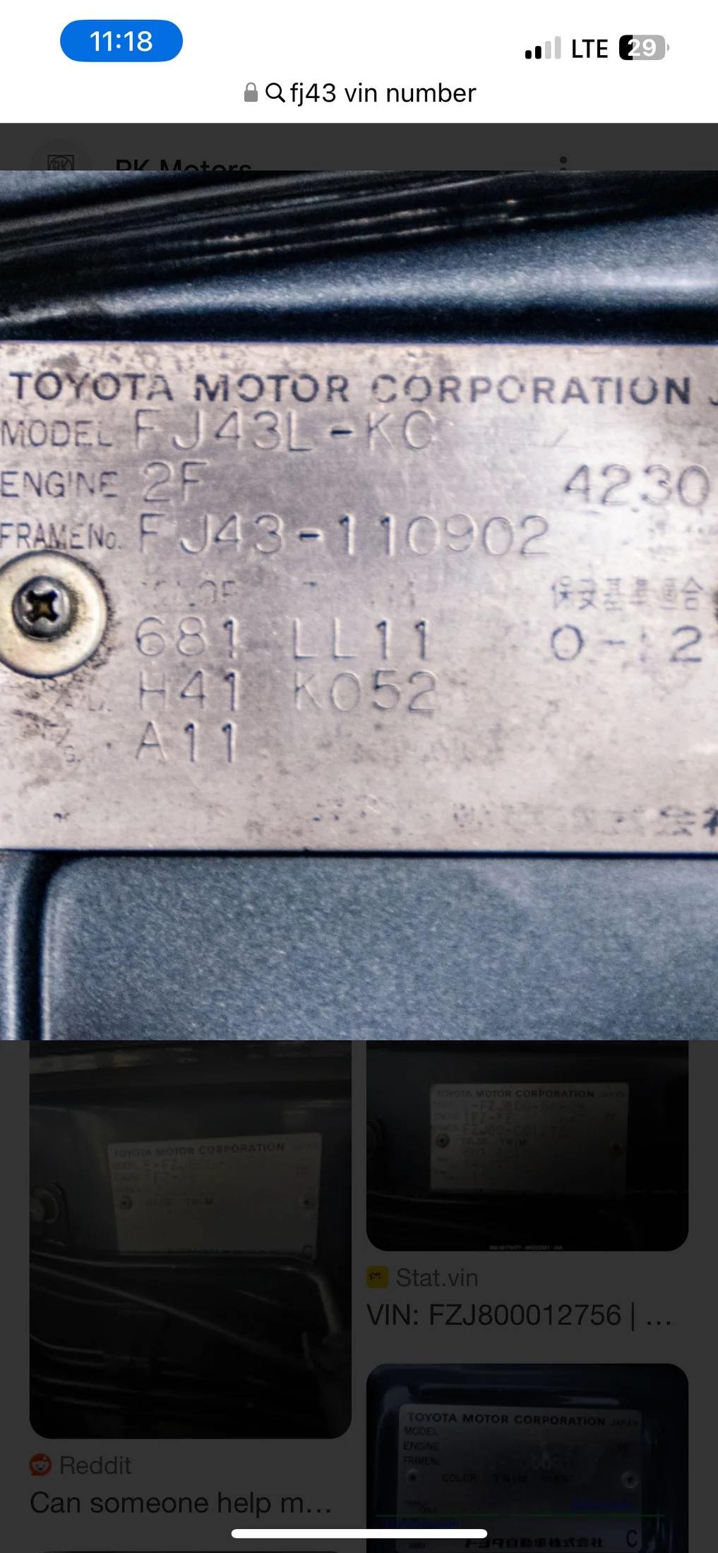

real Fj43 the VIN will start with a FJ43. Looos good. I like the 43. Could be a FJ43 with swappped VIN. Like JohnnyC said check it all matches. If all FJ40 on all the paperwork firewall or door jam. Plates and frame. Check the frame I’d be interested on what the frame says. Front passenger side frame horn.

What’s sketchy about the bodywork? I don’t have the eye to catch that. It all says fj40, title, frame stamp and metal plaque all say fj40
Well its clearly not a 40, what ever they want its not worth going to jail or throwing your money away.
Ok. Its a 40. A heavily modified 40 but its still a 40. People do mods to their rigs all the time. If all the paperwork, plates, and frame stamps match then it seems plausible it might work. I'm not spotting a lot of
body work errors under that paint....but its almost impossible to spot body trouble from photos. The only thing I see off hand is that the rear wheel wells (inside) look like they are not stamped with ribs (or perhaps partially stamped). Then you have raptor liner or equivalent in that area and in the foot wells. That might be covering some ills...but again...take it to someone you trust who knows these rigs.

It looks like a stretched 40 with a Colombian hard top.
If the VIN reads FJ40xxx, then it is a clean vehicle that was modified.
The fuel tank suggests it is a pre-1979 model year truck. Did the seller mention the year?
